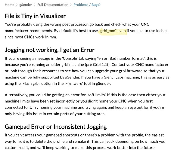

Hi,
I’m a newbie to cnc. I’ve successfully completed the spoil board surfacing and was able to put a grid on my Longmill mk2.5. I want to add numbers and alignment holes along the xy axis.
For some reason, travel on the axis has been limited to 1.227" and 1.365". I’ve gone back to Vectric and double checked my work (seems fine as it’s tied in with the ‘grid’ portion. I’ve also looked at the firmware but am reluctant to change any settings since I don’t know what to look for.
The visualizer confirms the travel limits.
Removed and reinstalled Gsender as well. Otherwise the jog function and everything else seem ok.
Hi Jack,

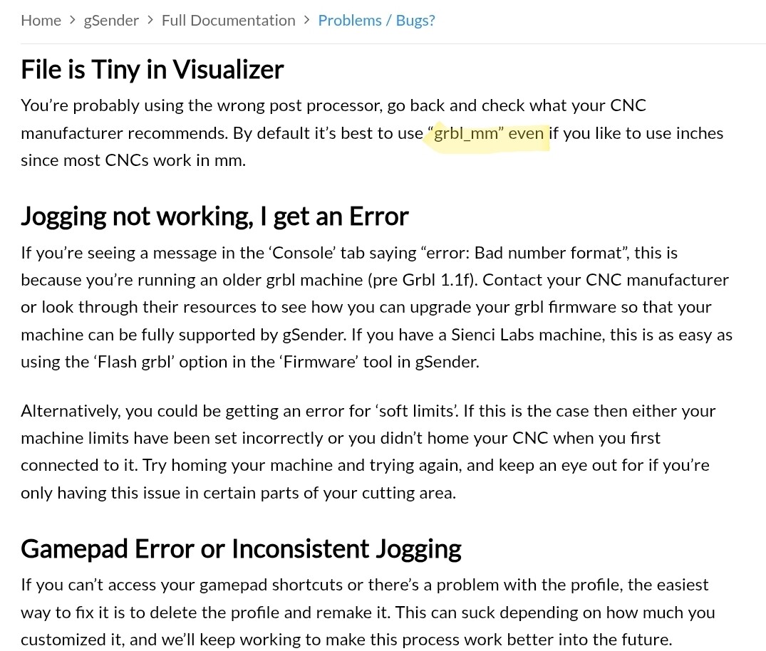

Welcome to the beautifull world of wtf.. ehr cnc. It sounds like you are seeing a poststamp version of your design in the visualizer of gsender, no?
If my memory serves me well.. it doesn’t, don’t let me fool ya.. but lets pretend it does for a moment, it could have something to do with what post processor you use on your cad software.
Here is some info on your problem in the problem/bugs section of gsender manual.
Found here:
More on post processors here:
I did switch from grbl_mm to inches, so I will switch back and let you know. Thanks for the quick response.
Great news, that did the trick. Thanks so much for your help.
