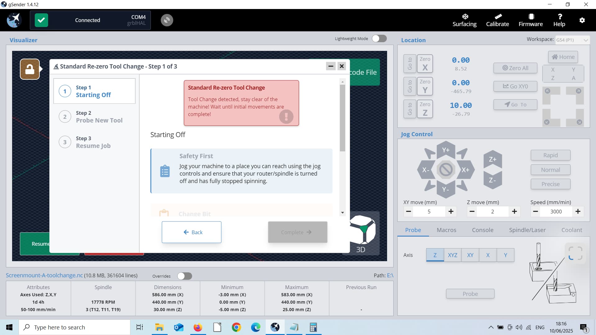

I have a gcode File Loaded and Tool Change Set to āStandard Re-zeroā
When i try and run verify the Tool change wizard immediately opens and i canāt see how to proceed any further
can anyone tell me if this is a bug or what iām missing?

Hi @fireblade this is likely a bug. Though, now that weāve updated gSender to 1.5.0 and have improved our own built-in file checkers, the Verify Job has been removed since it was being used less so this problem shouldnāt exist anymore ![]()
