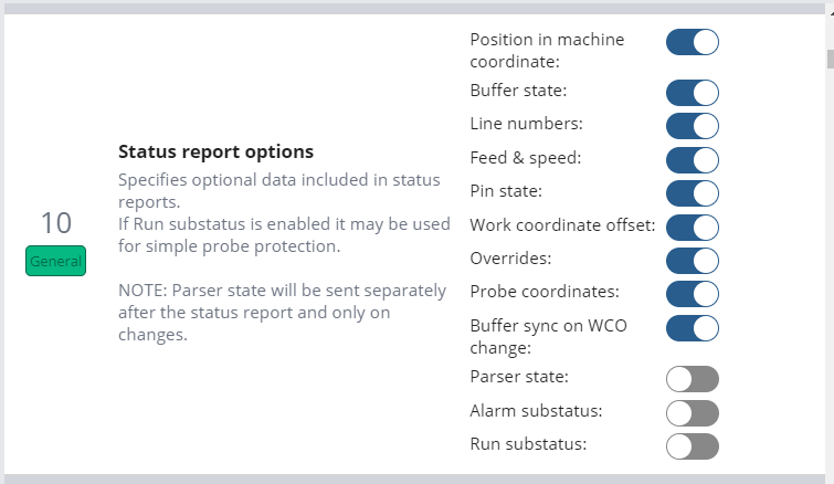

I’ve just changed my machine to a SLB and updated to the lastest version of Gsender. Everything looks like its working but gSender will not let me Zero all?
Any ideas?

I’d start by checking your $10 EEPROM - it should look similar to the following:
Since grblHAL lets you configure exactly what the status report returns, including work coordinate offsets, it’s likely you set $10=1 where most of the reported values are incorrect.
All fixed, thanks so much.
