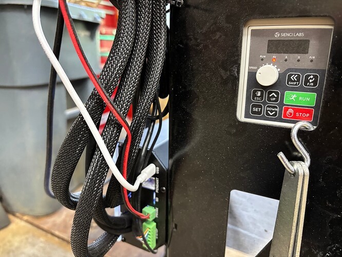

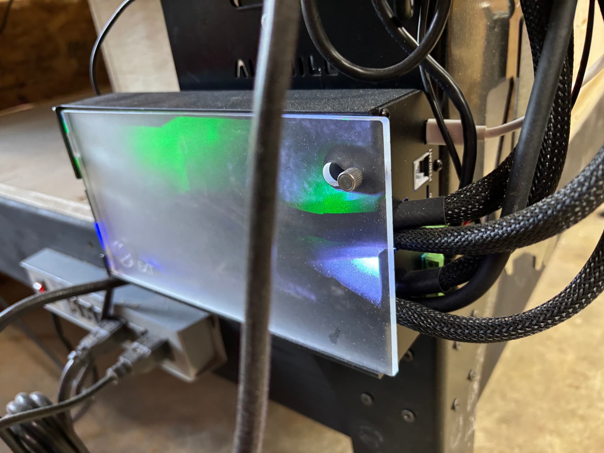

its the Altmill 4X4 MK2 with the SLB I am running g-sender 1.5.2
I have the console I bought from Scienci Labs and it is hooked up via provided USB. I checked all the wires and the limit switches are all in the new bump stops properly.

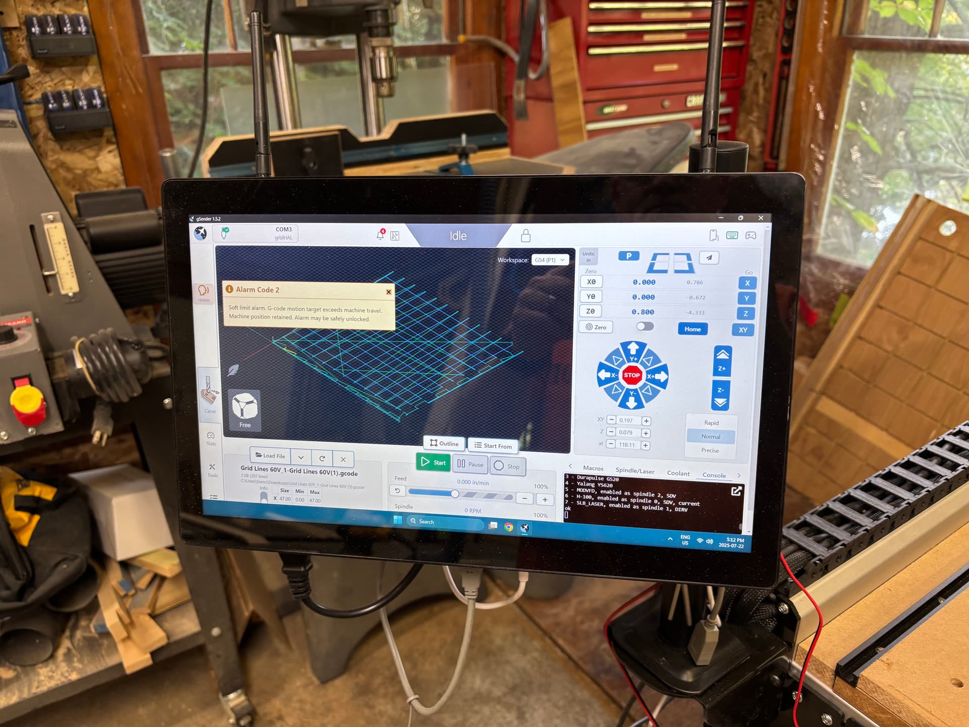

Thanks for the response. I did this and set the X and Y Max travel and made sure the soft limits were enabled, according to your instructions. I run a program and it crashes into the front right stop fairly aggressively. I am running a Grid program to put a grid on my spoil board, just so you know what I am attempting. This uses the full area of my machine “Supposedly” .
Do the limits work when not running a program? And just to make sure, are you homing as the first thing you do after connecting with gSender?
I’m not sure what else it could be. After you home are the machine coordinates at [0, 0, 0]? Those would be the gray smaller coordinates to the right of the blue workspace coordinates in gSender.
It might be worth checking out the AltMill Troubleshooting section in the docs if you haven’t yet. There is also a page to double check your homing related settings here.

@Harlcop23 Is this issue still present on gSender v.1.5.3 for you?
Hello, It seems to have resolved I’m not sure what I did but I am not having the issue anymore. The only thing I can think of is I deleted G Sender and re-installed it. Thanks for all the help.
