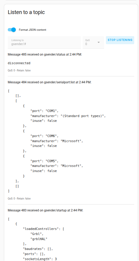

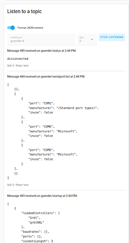

@darick_c Do you think it matters that I am connected to the SLB_Ext via ethenet? I keep only seeing the same three messages when I listen to gsender/#
I have disconnected/reconnected to the SLB, loaded different files and jogged around but still only the same 3 messages
Message 1730 received on gsender/status at 5:09 AM:
disconnected
QoS: 0 - Retain: false
Message 1729 received on gsender/serialport:list at 5:09 AM:
[[],[{"port":"COM1","manufacturer":"(Standard port types)","inuse":false},{"port":"COM6","manufacturer":"Microsoft","inuse":false},{"port":"COM5","manufacturer":"Microsoft","inuse":false}],[]]
Message 1728 received on gsender/startup at 5:09 AM:
[{"loadedControllers":["Grbl","grblHAL"],"baudrates":[],"ports":[],"socketsLength":2}]
I added port maps for 1883:1883 and 8080:8080 just in case communication wasn’t making it through to the docker but still no dice.
HA is definitely getting messages but seems like either my gSender isn’t sending anything or the docker isn’t getting them/processing them.

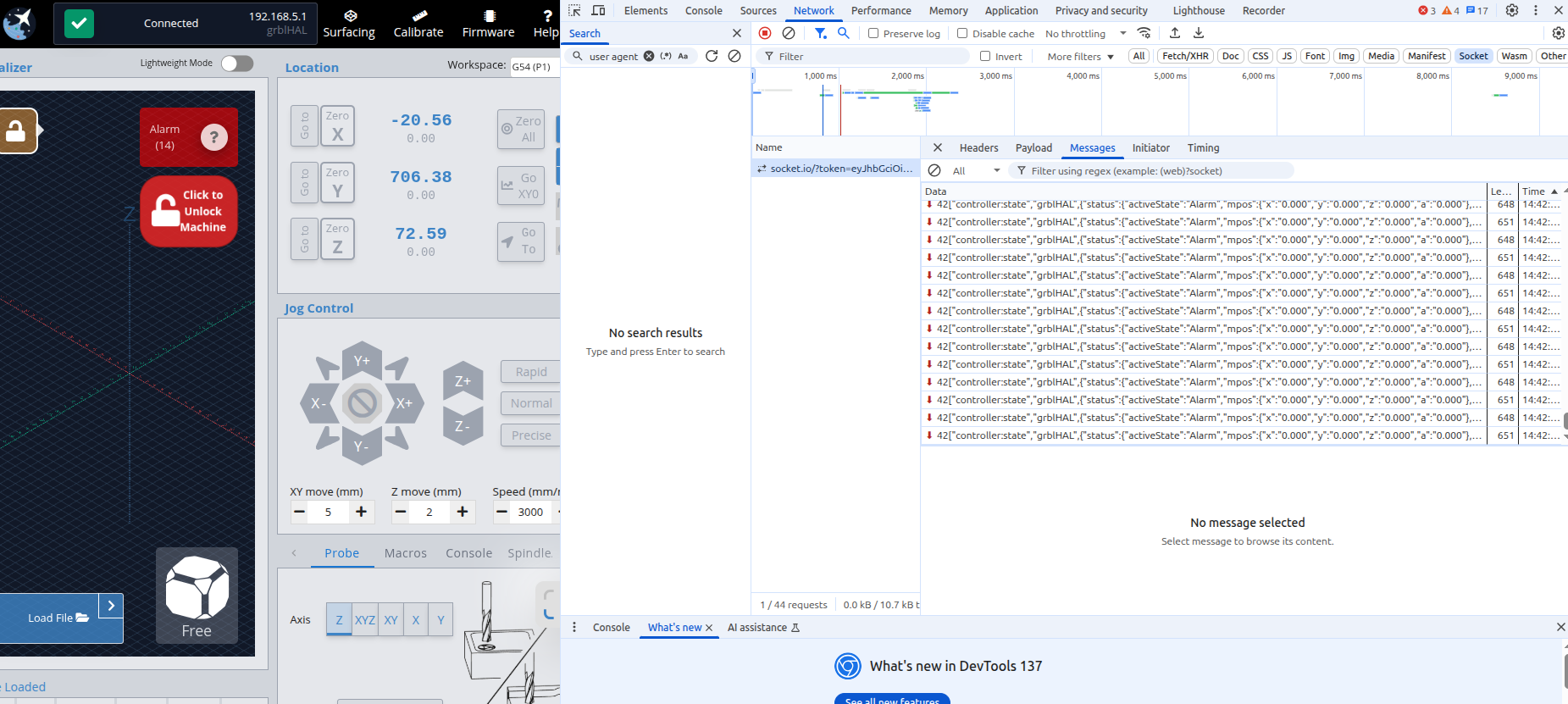

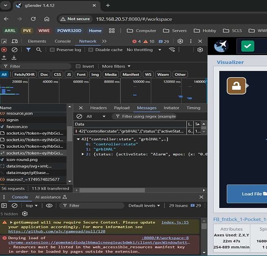

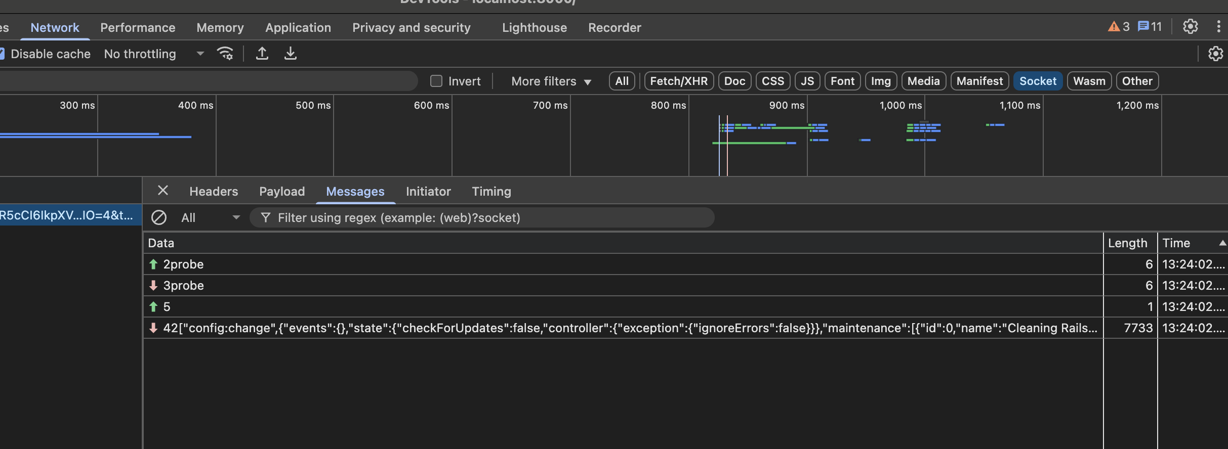

If you are connected through ethernet, then I would think it should show up when doing a ā€œgsender/serialport:listā€. If you access it remotely and open developer tools (F12 should open dev tools), go to the network tab, refresh the page so things start showing up. Then click on the socket filter and then click on the entry that should be showing. You can see what it is sending to connect. I’m not using ethernet, so I wasn’t able to test that connection. But as long as it is working with the remote mode option, we should be able to get it workin.
ok so for starters, I guess I did not understand that I actually had to USE the Remote connection - only that I needed to have it on.
Once I used the Remote Connection to connect to the SLB, the Dev Tools started to populate.
However, still not seeing the same in MQTT/HA
You shouldn’t have to use the Remote connection it for it to work, we are just using it to find out how it is connecting. Can you connect to the SLB on the machine running sgender, then open up a browser with dev tools and show what it shows as you connect through the browser? I want to see what it is sending to connect to the SLB from the browser. There should be a commend sent called ā€œopenā€ and then some data that it passes.
Not sure I know how to acquire what you are requesting (but really want to). I can’t seem to get ā€˜Console’ when using the browser on the gControl to access the remote. Is there a different filter I should be accessing?
