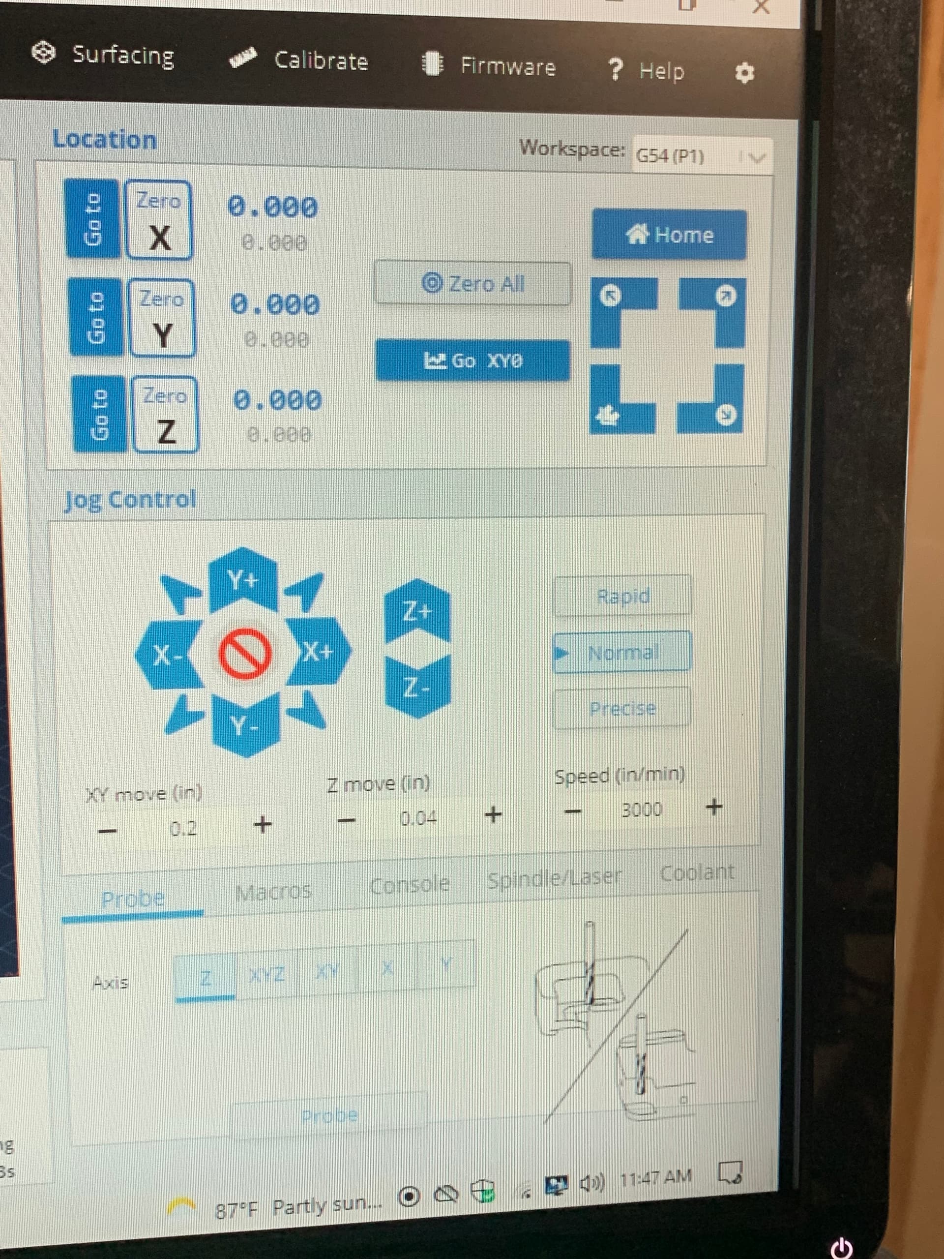

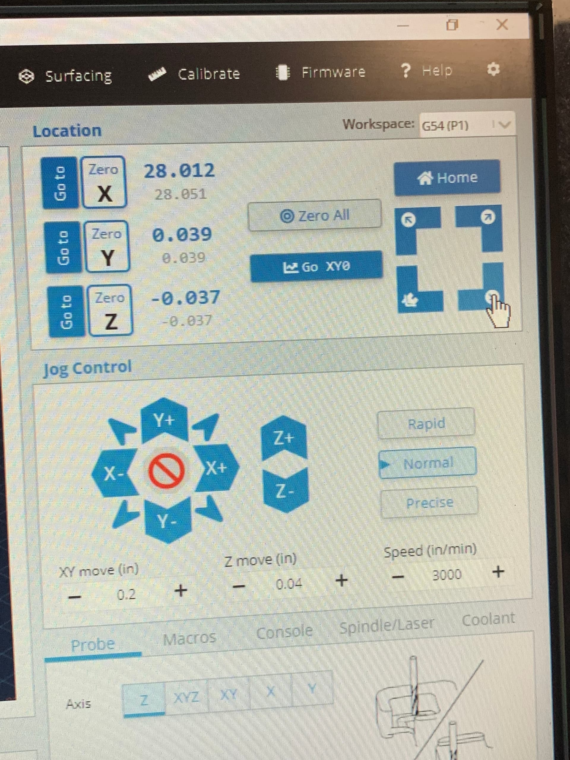

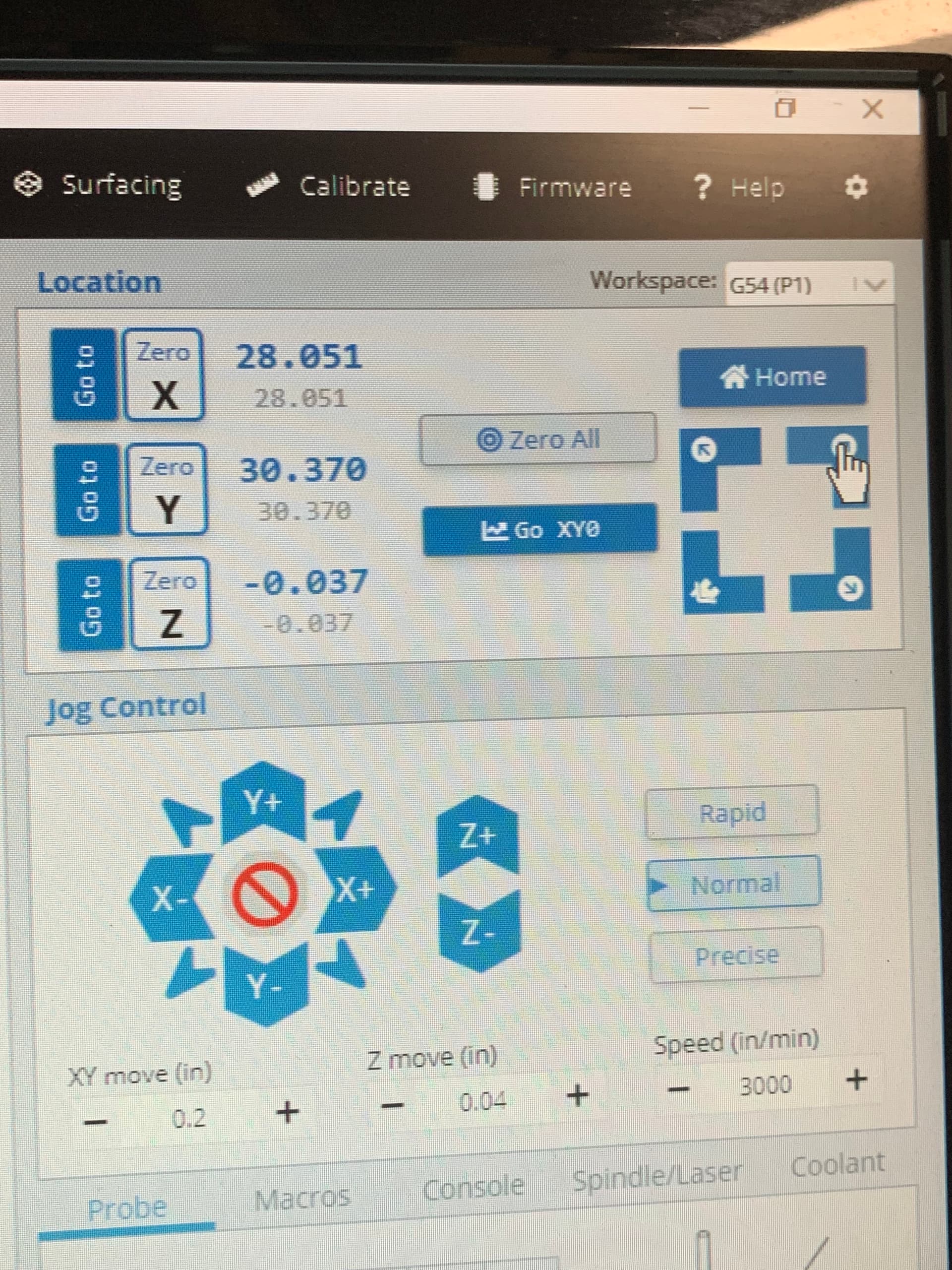

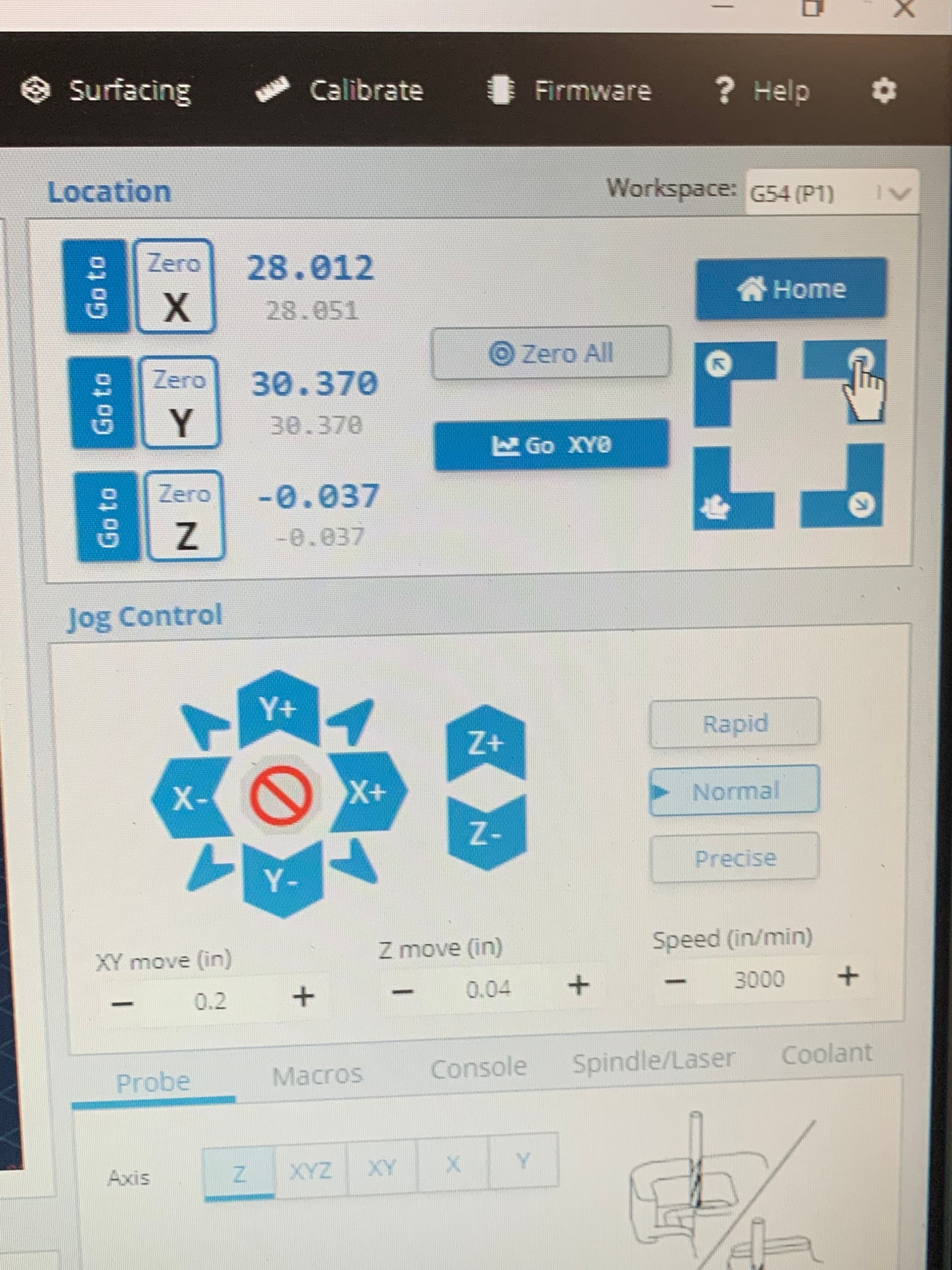

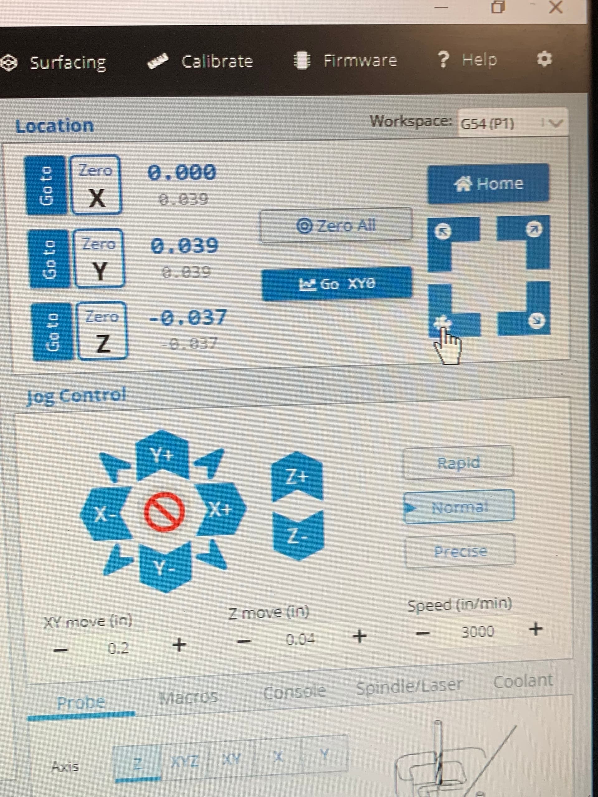

@chrismakesstuff @andy - Ok guys, I think this is something up your alley. I have the 30x30 MK1 from the kickstarter program. It has been running fine all of this time. Not too long ago I added the homing sensors. I followed the installation instructions as posted. All seems good until recently (currently on Ver 1.1.1). After homing I’m getting some weird numbers on the X and Y movements. On the Z there is something else weird. I am attaching several pictures below and putting what I’m seeing at the beginning of each picture. What I’m seeing does not affect any of the work I have done so far but distances to the corners are a little off. Keep in mind I operate in inches. Also the actual moves in the X and Y are not the same as the firmware Max Travel. X should be 29.53 inches but moved only 28.05 inches. Y should be 31.97 inches but moved only 30.37 inches.
Start and LM is homed. All locations set to zero as expected.

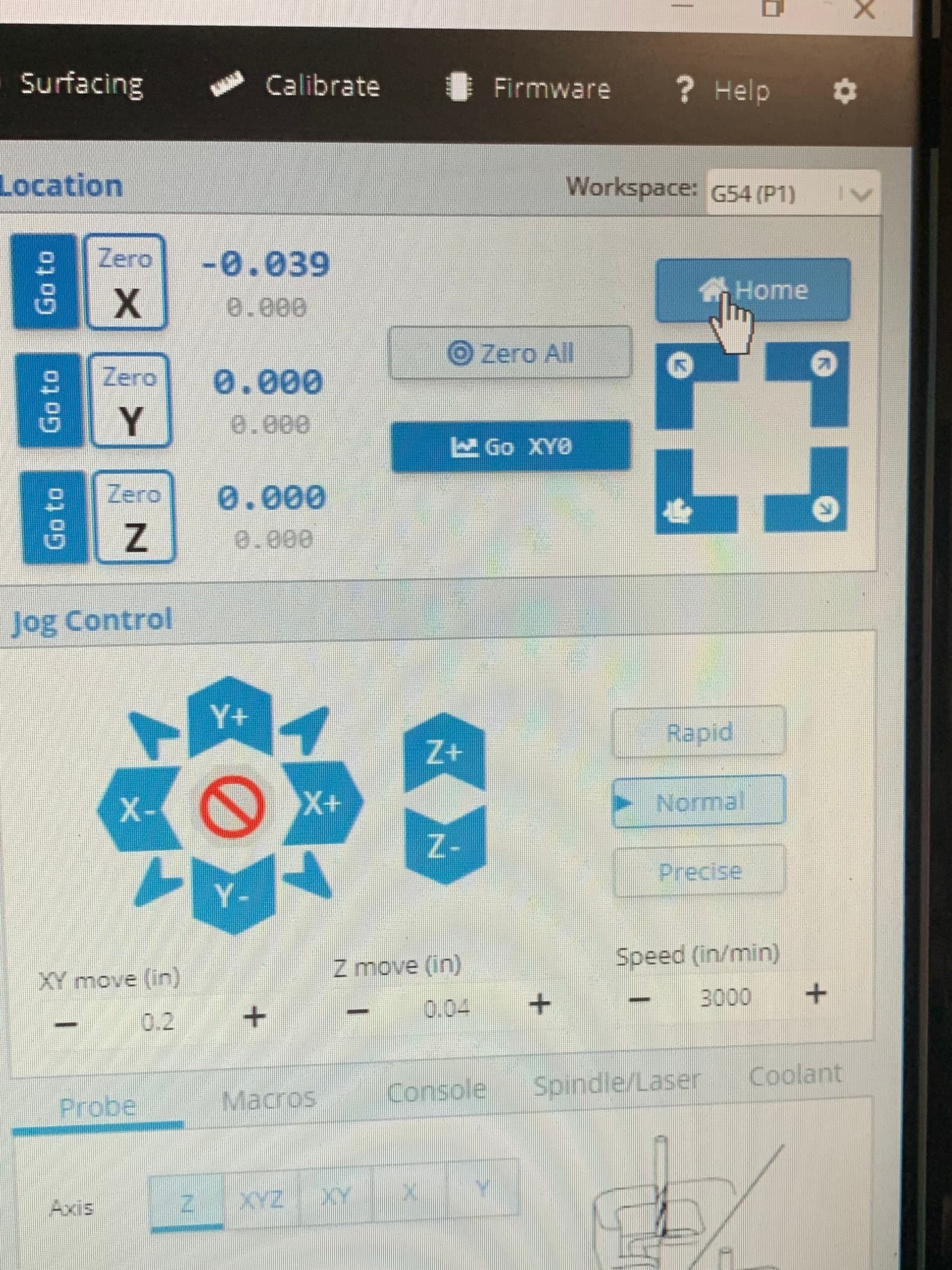

Selected icon for back left corner. LM moved to back left. X shows +.039 even though it did not appear to move and I saw it incrementing as it proceeded to the back left. Also noticed the Z axis dropped to -.037 almost immediately and I saw it move and it stayed there through all remaining moves.
Selected icon for back right corner. Even though X from previous move was at +.039 (I did not rezero). Only X value incremented. No other axis movement.

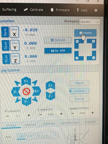

This was the same move to the back right corner but this time I zeroed out the X value (+.039). Notice the difference in the final X value. Difference of roughly .04.

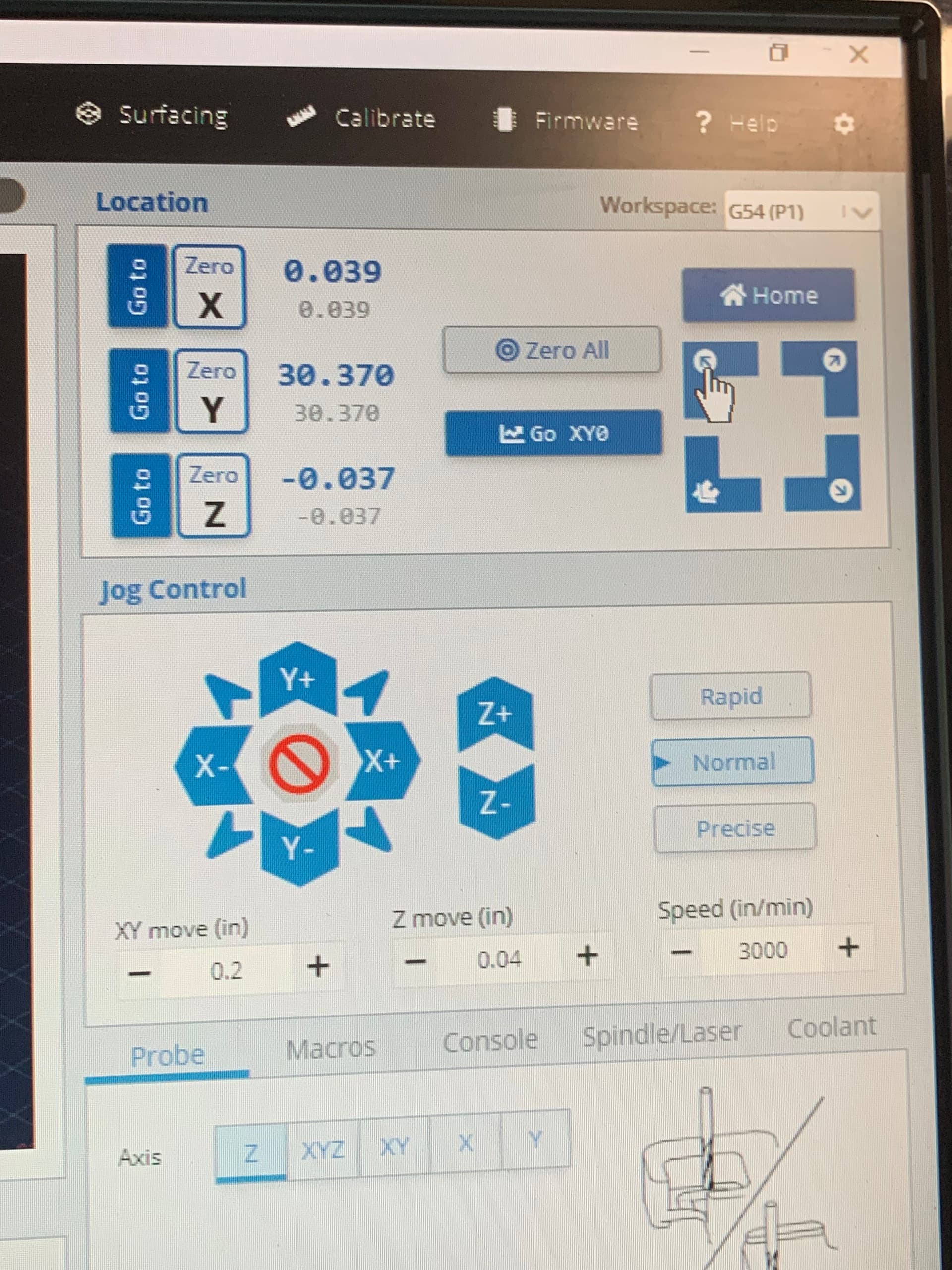

Selected the front right icon. Carriage move smoothly. Now the X is still at the same location it was on the back right corner. But the Y instead of being .00 is +.039. Weird.
Selected the front left icon, not the home button, and got these numbers. Check the machine locations showing +.039.
And finally hit the home button and this was the final back home readings.
