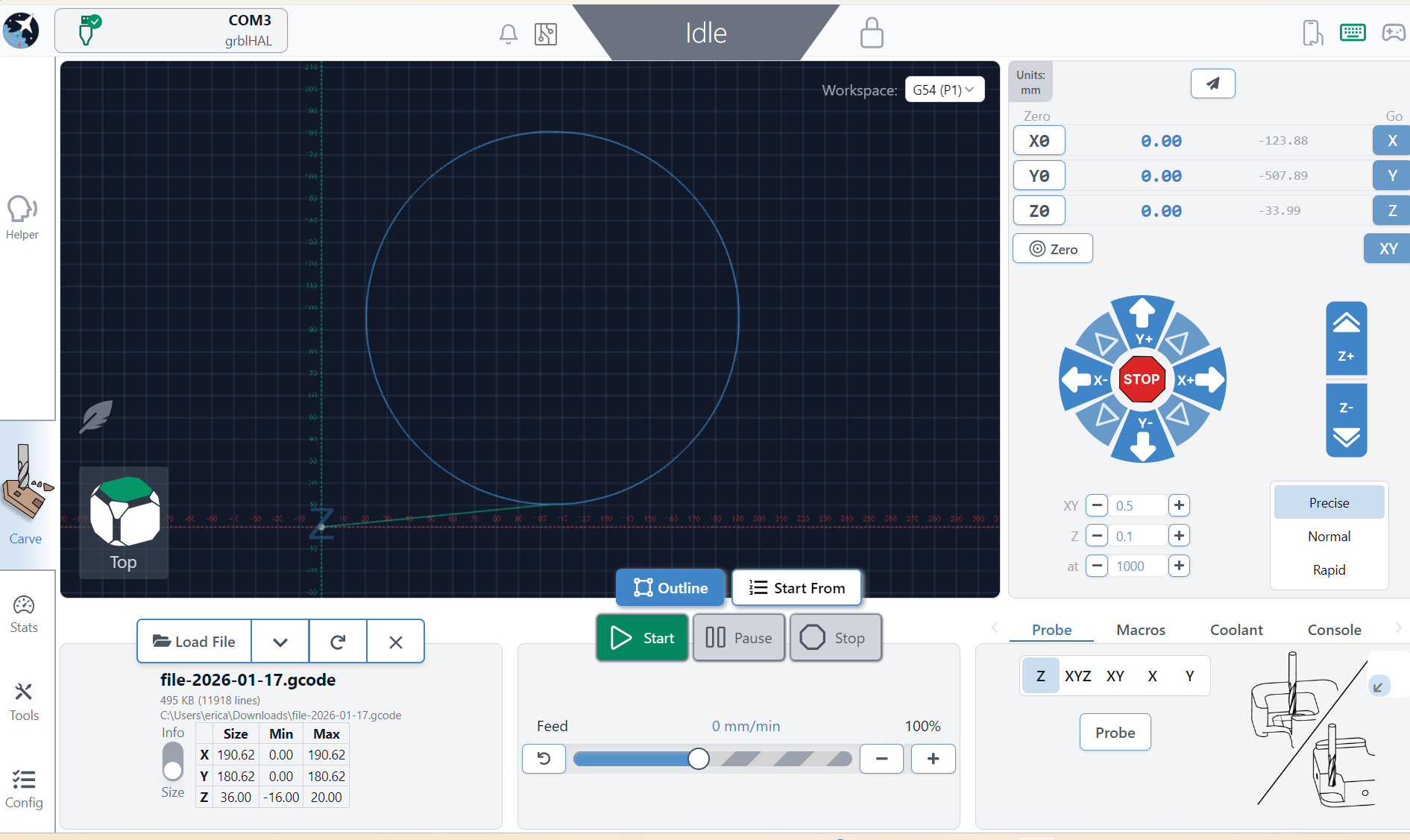

Hoping to manually set XY center in gSender
I’ve been using gSender for a few months and enjoy it. However, I’d like to ‘manually’ set the X and Y axis to the center of my workpiece and can’t seem to find the option to do so. There is an option to XY Zero but not the option for ‘center’.
My machine is the Longmill 48x30 with the superlongboard. Top photo is my current setup, lower photo is my goal.
What am I missing here??? Thanks!

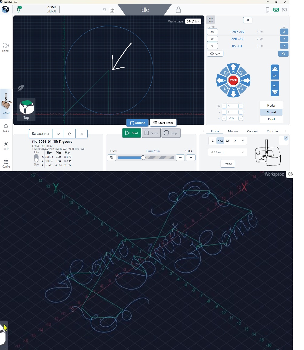

@Commah To be clear, you want to set XY0 to the centre of your material, not the centre of your spoilboard, correct?
If, as you have said, you want to set XY0 to the centre of the material, that would pre-suppose that gSender “knows” where you placed the material on your bed.
Correct, I wish to set it to the center of the work. There is the option to set it bottom left, top left, bottom right and top right, is there not an option for center?
@Commah You can set it manually by marking the centre of the material, jogging to that position and setting XY0 there. There is no way to do it automatically because, as I’ve said, there is no way for gSender to know where you have physically placed the material on the spoil board.
For most of my projects, I set XY0 to the centre of the material. I use a crosshair laser to make it easier, but it can be done quite simply by eye.

Awesome, ok so how do I set manually?
@Commah You mark the centre of the material. You jog in X and Y until the bit is over that mark, then you click on Zero XY. If you have a touchplate, you can then use it to set Z0. If you do not have a touchplate, you can use any method you want to set Z0. Many use the “paper method”.
I have mounted a crosshair laser on my Long Mill as I find it easier to get that crosshair precisely over the centre mark than it is to center an end mill. Others use a vbit as it is easier to hit the centre mark more precisely with it than it is with a straight end mill.

Maybe I’m asking the question incorrectly. I’m familiar with ‘zeroing’ the x and y.
My issue, perhaps, is loading the file so the the x and y fall directly in the center of the file. I assumed I could load the file, then find the center and zero it, but it places the bit in the bottom left corner rather then the center of the file…..does that make sense?
You need to tell your cad software you are using centre as your zero point.

@Commah , I have a small machine, and not a lot of wiggle room. I I mark the center of my material with a push pin, or something with a very small, sharp point. I then use a V Carve bit and align the tip of the bit with the mark I made. Now, if the material you are using will be in the same location every time, you can set XY0 in your gSender config.
