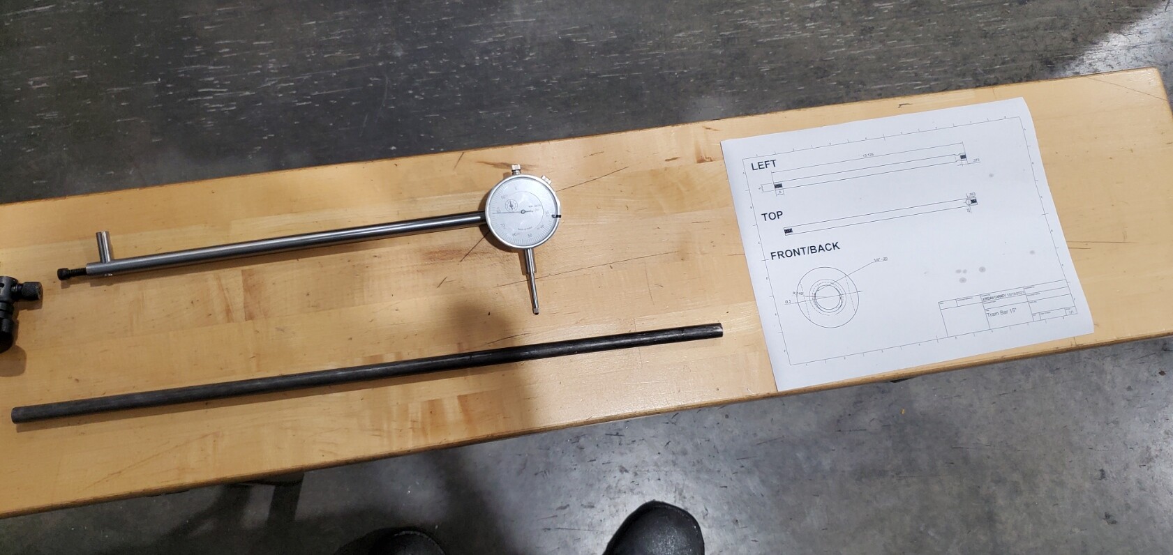

I made a tram bar at work on the manual lathe using some 3/8" stock and tapped a hole in the end to fasten a dial indicator with a plunger probe to the end. Rotating it 180 degrees at a 15" radius I was able to get the X axis within .001" difference from one side to the other. If I did my math correctly, on a 1" endmill at that angle it came out to being like .00007" difference between the edges of the endmill which I think is an acceptable level.
Here’s the tool I made:
Sadly it is too big to go completely under the X gantry so I have to walk around the whole table to read it, and I am unsure of how I cam going to do the Y axis like this. Maybe flip it at a very high angle.

From what I can see there are two options to look into. First being, are your linear rails perpendicular to your spoil board? You can have a quick look at this by taking a square, putting it on your spoil board and running the other part of the square against the rail itself. This should show you perpendicularity if it’s good. Move on to the spindle. Now you want to make sure your spindle is square to the spoil board. To do this, put your arm indicator in the spindle rotating it 0 to 180. That will show you the difference and should tell you which way to move your router if it’s the router.
Again, don’t assume your linear rails are perpendicular. If they are on an angle and then you set your router to a different angle, then your router isn’t running parallel to your linear rails.
