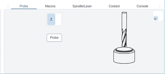

I purchased a Axiscreat A6060 which love so far, I had a lot of trouble with UGS which I thought was the best option for gcodes until I saw the video IDC Crafts did on GSender I was so impressed I downloaded it and tried it out it eliminated some of my problems, but still a couple issues which I think effect each other.
  1. There is no setup option for the Axiscreat 6060
  2. I have used the Z lobe option a couple times and it has never set my Z depth properly this machine comes with a Z probe setup on it already.
I am currently using the Generic option you have but it doesn’t seem to set the depth properly when using the Z probe.

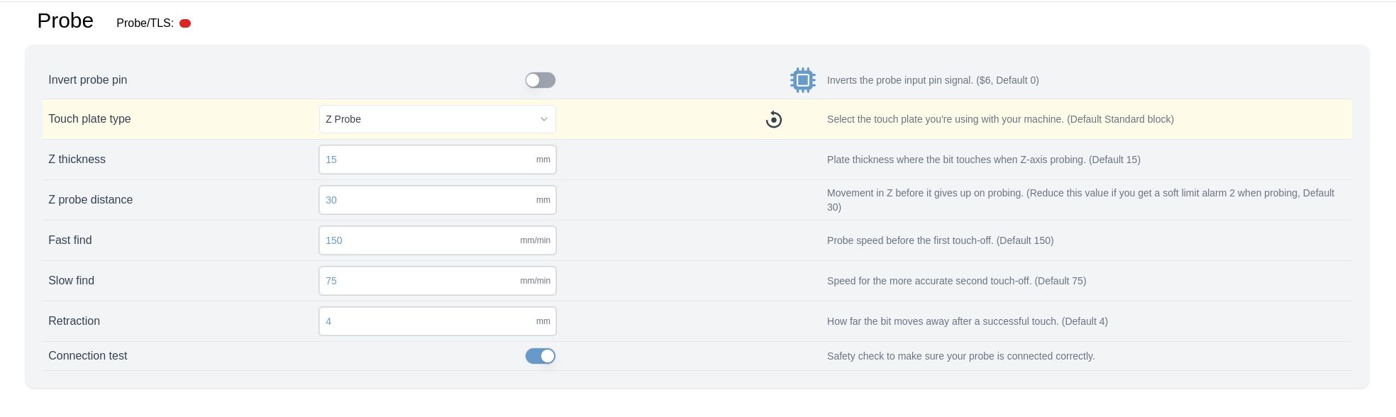

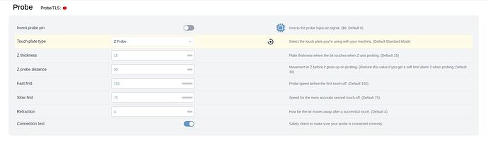

The touch probe is one of those things that does need to be setup. Have you selected the type of probe that you have and entered the appropriate dimensions? Make sure to hit ‘Apply Settings’ when your done.

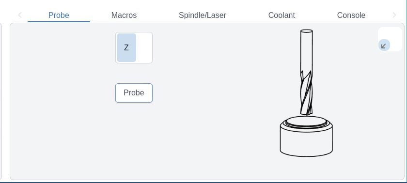

You mention a Z probe. If it’s a Z only probe then you want Z Probe and only options for that type of probe will be shown.
Then in area that you do a probe from make sure the type you have is displayed. If the picture doesn’t resemble the probe you have it’s likely that the wrong type of probe is selected in the ‘Config’ section.
If you have already done those settings for your probe let us know but that’s the first thing that comes to mind for a new user of gSender.
