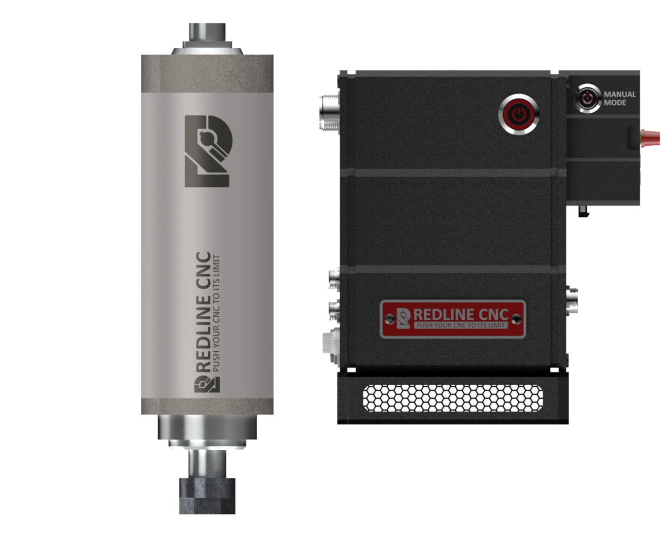

Out of curiosity, do you know any Australian based reputable and reasonable cost spindle suppliers?
Asking as I’m not sure I want a Makita as some of my jobs are longer running and a router is just so noisy. That and I’m needing more precision than the Bunnings-special router I’ve been using. Spindles on sale here seem to be cheapest of the cheap or high performance professional spindles, nothing in that 1.5-2.2Kw range that would be a nice router replacement.

Spindles seems to be a topic outside of the mericas somehow. It seems that the machines produced on our side are overpriced and underpowered. That’s why we ended up in Canada in the first place. Stepping down a 1.5kW device or even a makita is a whole other topic so that’s a simple nogo. If I’m not mistaken, you can find 220V units at desktop cnc manufacturers, other than sienci, if you’re like me and don’t trust cheap chinese units.
Example at onefinity:
That said, I am running my makita for a good two years now, after I burned out the first one within a month because… you know… new to cnc… and an waaay to high rated circuit breaker on the makita outlet. Yes it’s noisy, but milling wood makes more noise so it is a mute point. Maybe if you want to engrave a lot, that it will make a large difference, otherwise it will not.
Accuratesse aint no issue either. The makita is robust and I don’t see any wear and tear in my trusty ol’ unit. It does its job like a champ. The deviations I see are more from a wee slob in the z-axis of the lm than anything else. Then again, I’m not that big on trying to have it dialed in at micrometer accuracy, if running an extra finnishing pass can mitigate hours of tidious tuning and re-tuning just as easy.

I’m not sure how fast I’ll move forward into machining small aluminum parts, so I think a Makita will be the way forward as they are available here (though a little harder to get the non-battery version) and will get me more than started on my journey.
