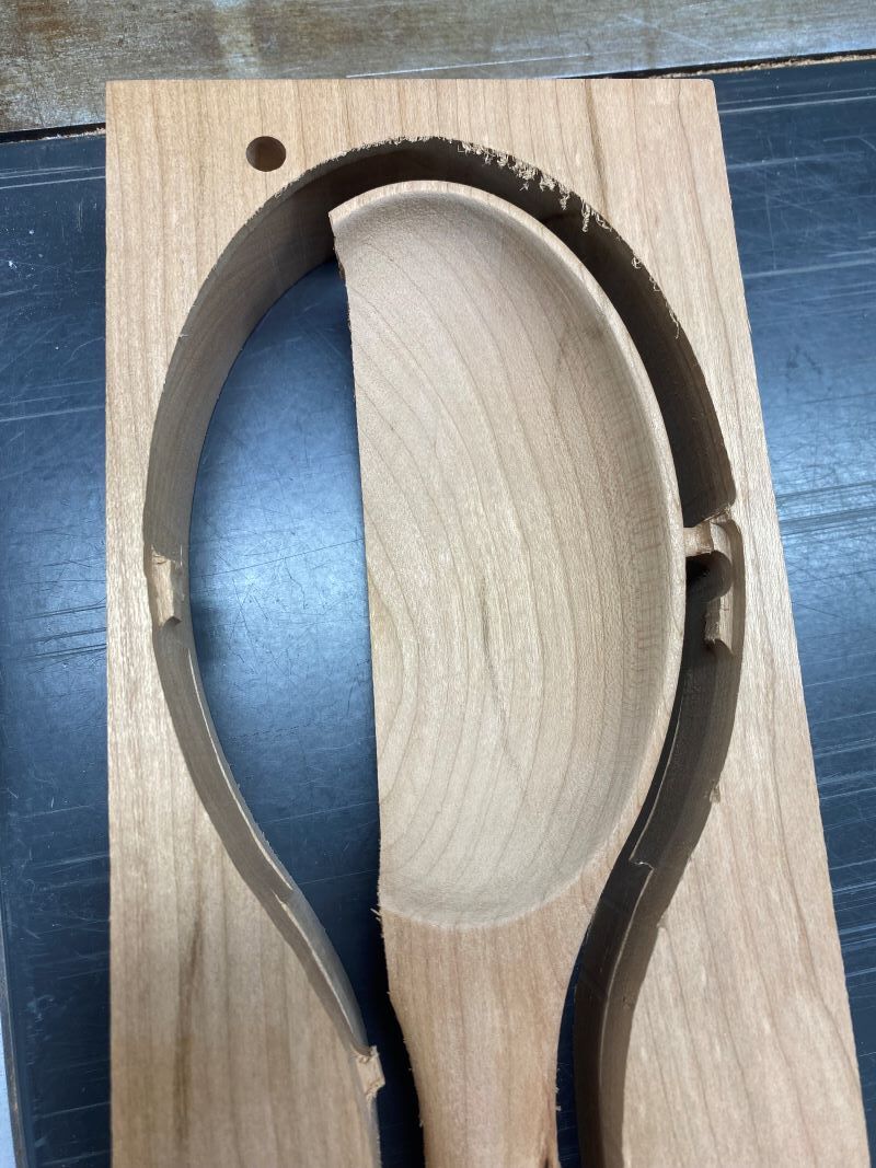

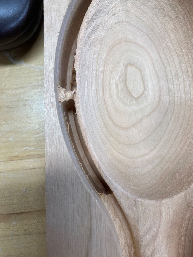

I destroyed two more spoons when making the finish cut. The last one, the machine suddenly gouged out the end of the spoon and plunged through into the wasteboard. When I returned to the XY zero point, the coordinates were way off. It never happens in the same place.
I am attaching a couple of images.
@knnewell What post processor are you using in VCarve, Ken?
Grbl(inch)(*.gcode)-also tried the metric version.
@knnewell How thick is the material? Could it be that you are hitting the top of the Z travel at some point in the project?
The material is 1.25 in and the safe Z is 1 in above material. It never hits the top-I am watching it the whole time.
When it crashes and the xy home changes… do both x and y change? Is it only the x or y that is off? Or are both x and y off after the crash?
It is both and possibly the Z, but didn’t check but since the router gouged the workpiece and plunged through into the wasteboard, I’m assuming the Z was off also.
It’s different every time.
I think I figured it out. My feed was set too fast-120 inches per minute and I found a loose roller on the gantry. I adjusted it so I could barely turn it by hand.
I ran the spoon project with no problems.
I suspect it was missing steps and throwing all the coordinates off.
