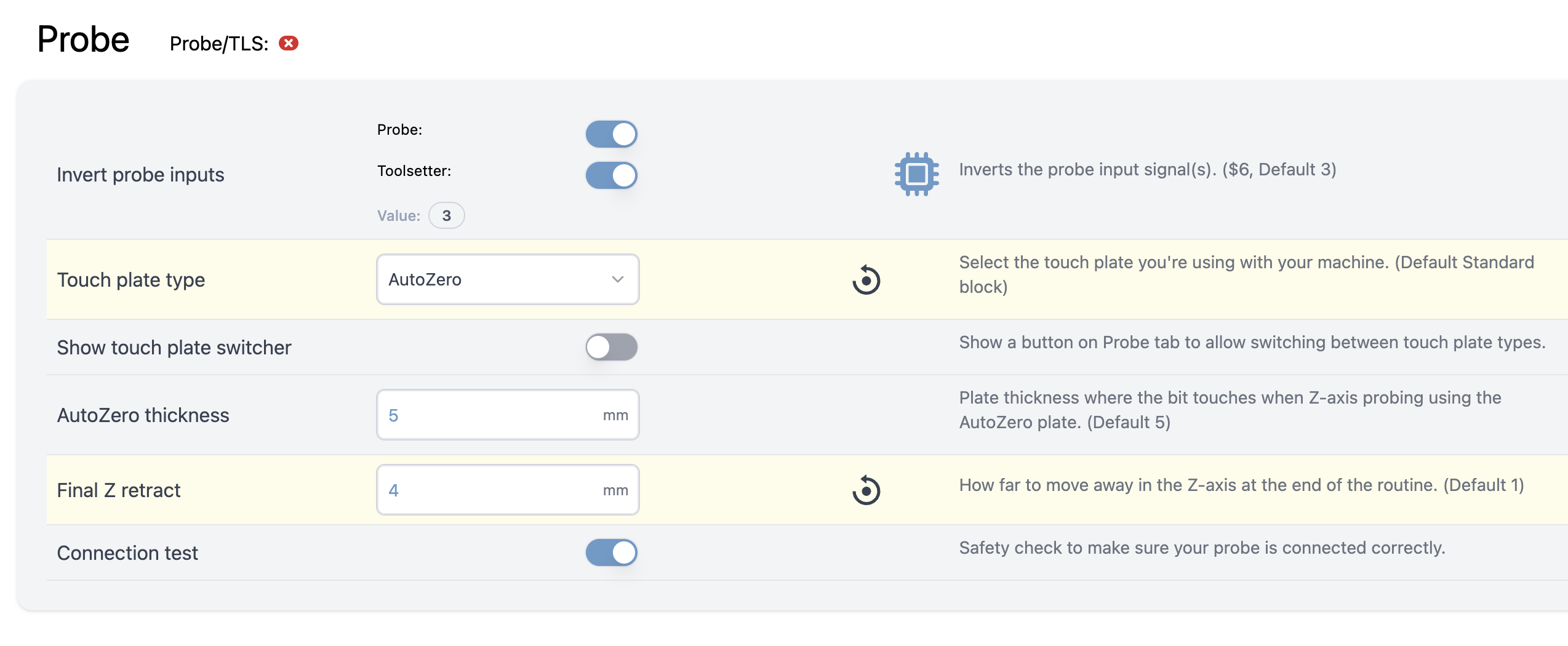

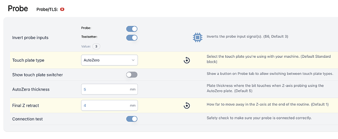

I just set mine up and I followed what it says here but it failed to mention to change the two other settings. Make sure your “Probe” config looks like mine below (had to check the “Probe” and “Toolsetter” switch to the on position):
Yep, exactly that. Hope it helps.
