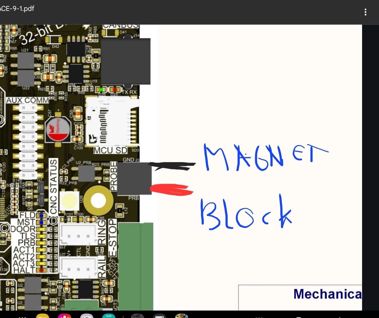

Hey Jim,
Could you verify if your wiring is like this?
Is this picture good enough?

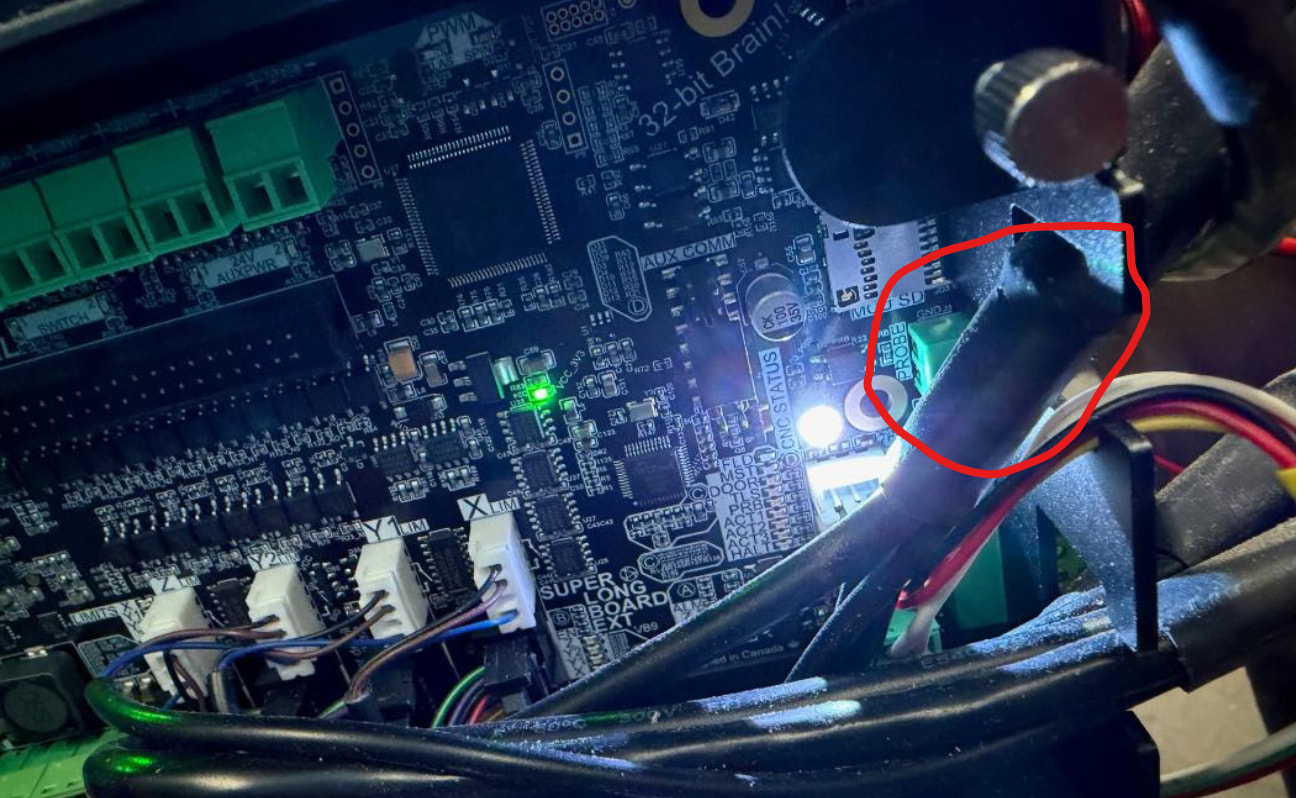

I think the connection @Spamming_Eddie is referring to is this green connector behind the black cable
@Jimc137 did you check the green connector on the probe’s cable? Maybe you have a short there.

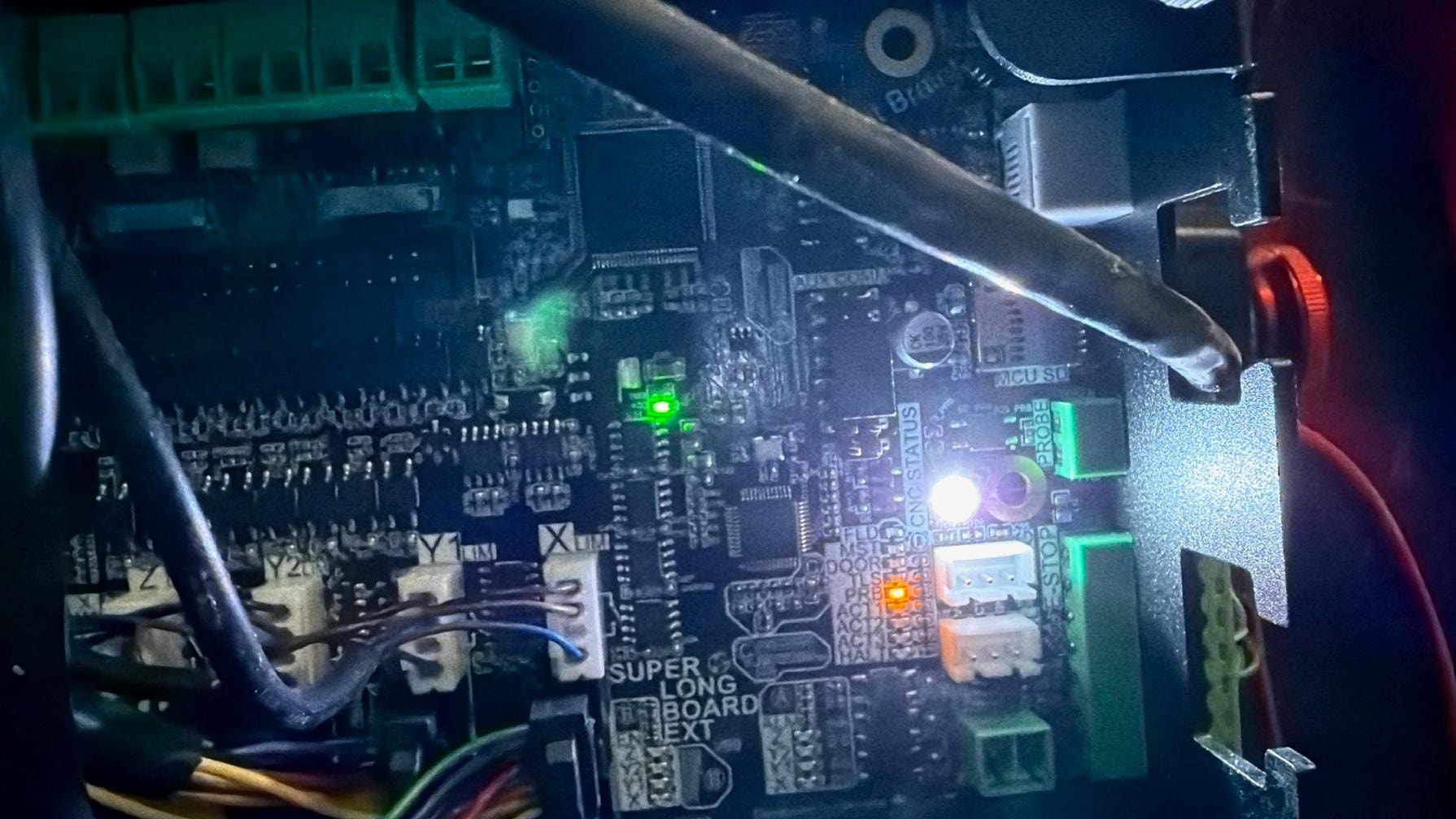

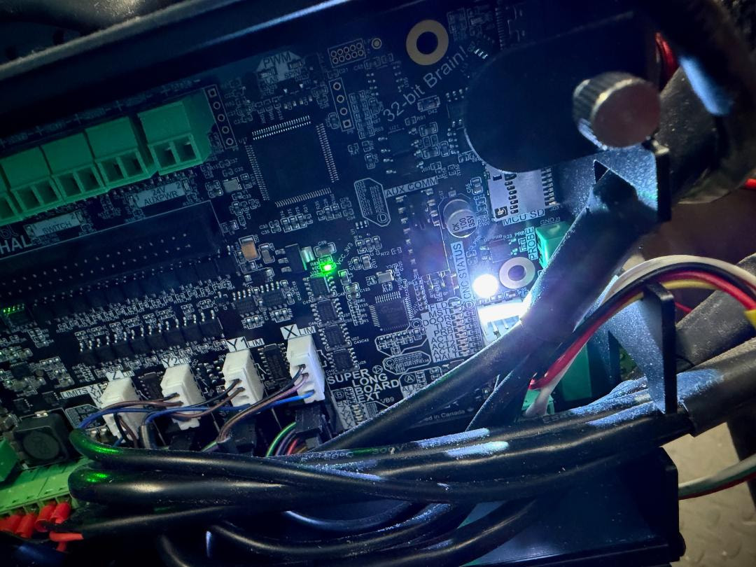

@Jimc137 seeing as in your picture the ‘PRB’ light is on, then definitely there’s some continuity happening through the input pin or some other cause. I was originally going to have you check if your probe input had become inverted in Config since this would cause the probe to register when you aren’t touching anything, but the light in the picture is showing that the board is detecting something.
What I’d recommend is you try to unplug the green connector for the touch plate or otherwise play around with your wiring until the ‘PRB’ light turns off, then you’ll be able to use that information to inform what may have gone wrong here. I’ll also move this thread out of the gSender topic since if the board light is on then gSender is receiving the correct signal, so it’s not a gSender issue.

Well, I tried some of your suggestions and I still haven’t resolved the issue. If the white LED is an indicator of the issue, then I haven’t been able to make it turn off. I removed the green probe connecter, to no avail. Then I removed the LEDs strip I added as well as the additional power supply and the light remained on. After each time I removed something, I restarted the controller (powered it off than on) to ensure that the controller recognized the change. I checked to ensure all of the connections are plugged in, and everything appears to be working. I have no issues running the CNC, I just can’t use the probe.
As you can imagine, very frustrating, any other suggestions would be appreciated.
