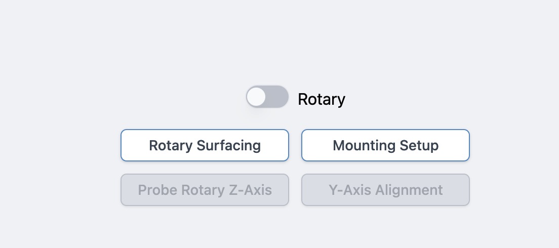

In gSender, where have you set the rotary/4th axis slider?
Is this the screen you mean?
I am not connected to the cnc at present but this would be on, if not when I load the Gcode file it insists that it is on :slight_smile:

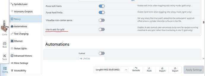

Hi all, since we’re gearing up for a new gSender Main release I’m digging through older topics that fell through the cracks to see if the problems are now resolved on new gSender or gSender Edge versions, or if they still are occurring and if so then we’d like to fix them up promptly if we can.
If you can give any response in the next week or so it’d be greatly appreciated :+1:

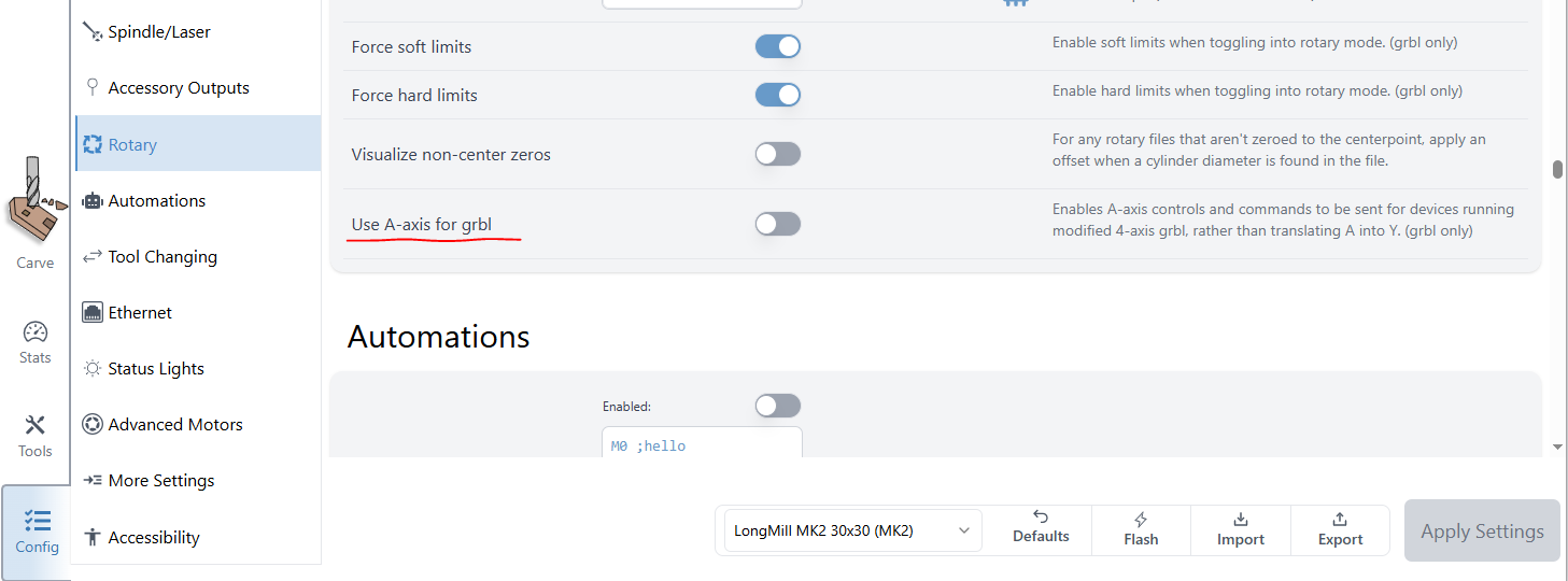

I’m going to reply to close up this thread since I think @PS3Pupil is not really active on the Forum anymore. For anyone else who finds themselves in this situation, we’ve since introduced a new Config setting under the Rotary section called ‘Use A-Axis for grbl’ and this should allow any grbl machine that’s running modified firmware to be fully 4-axis compatible to be able to use A-axis commands, jogging, etc. within gSender without the commands being converted. The reason we treat them that way by default is because any vanilla grbl machine is NOT capable of simultaneous 4-axis control, so we wanted to ensure we accommodate the typical default scenario.
