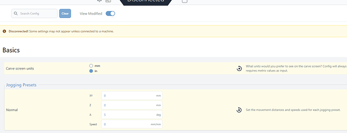

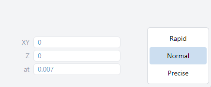

The Jogging resets to 0’s out of the blue for the ā€œNormalā€ speed, and jogging on the Y axis would sometimes throw a Homing error that wouldn’t let me get out of it.

I was experiencing this as well. I went into the setting under Jogging I believe and there you can set the speeds for Rapid, Normal and Precise. I haven’t run the CNC yet to see if they persist.

i have the same issue i will populate a value, and after i restart the gSender 1.50 they return to zero…

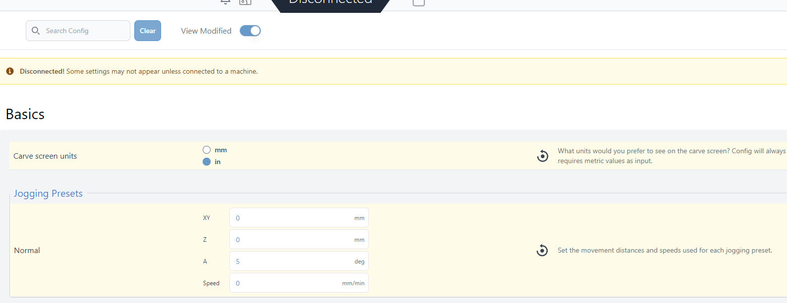

Yes, if you go to Config and then activate the ā€œView Modifiedā€ slide button, it’ll conveniently show up there, and even more conveniently will allow you to reset the settings, it’s just a bit of a hassle having to do this so frequently (almost every time I open up gSender)
Just to note, now that 1.5.1 addressed this issue I’ll close the topic - but anyone seeing this thread whether in 1.5.0 or later definitely follow what @NCNC wrote above to reset the setting for the ā€˜Normal’ jogging preset
