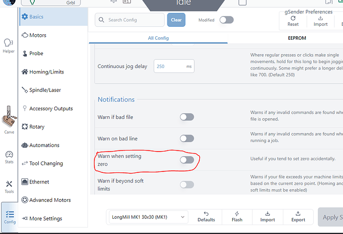

is there any way to lock a workspace so that xyz cannot be zeroed without first unlocking the workspace?
this would not allow accidently changing xy zero until you unlock
great for keeping a workspace zero “forever” so the work piece can be removed and reinstalled via a fixture, and be confident that the zero has not changed (accidently)

I can sympathize. Sometimes I press the “Zero Y” or “Zero X” buttons instead of the “Goto” button, just out of not paying attention or moving too quickly, then the coordinates are all wrong and it’s not easy to get them back (unless you have homing switches and know your original starting point).

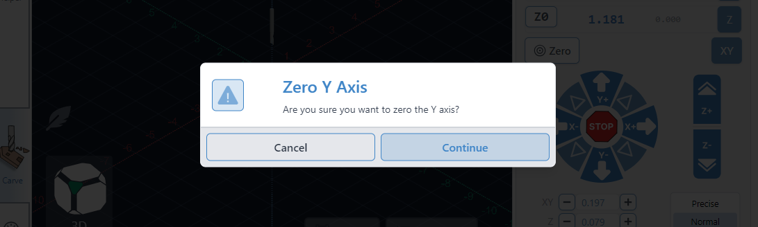

Even if you couldn’t lock the zero buttons, if you could require a confirmation when clicking a zero button, that would make me realize I clicked the wrong button and stop me from ruining a project!

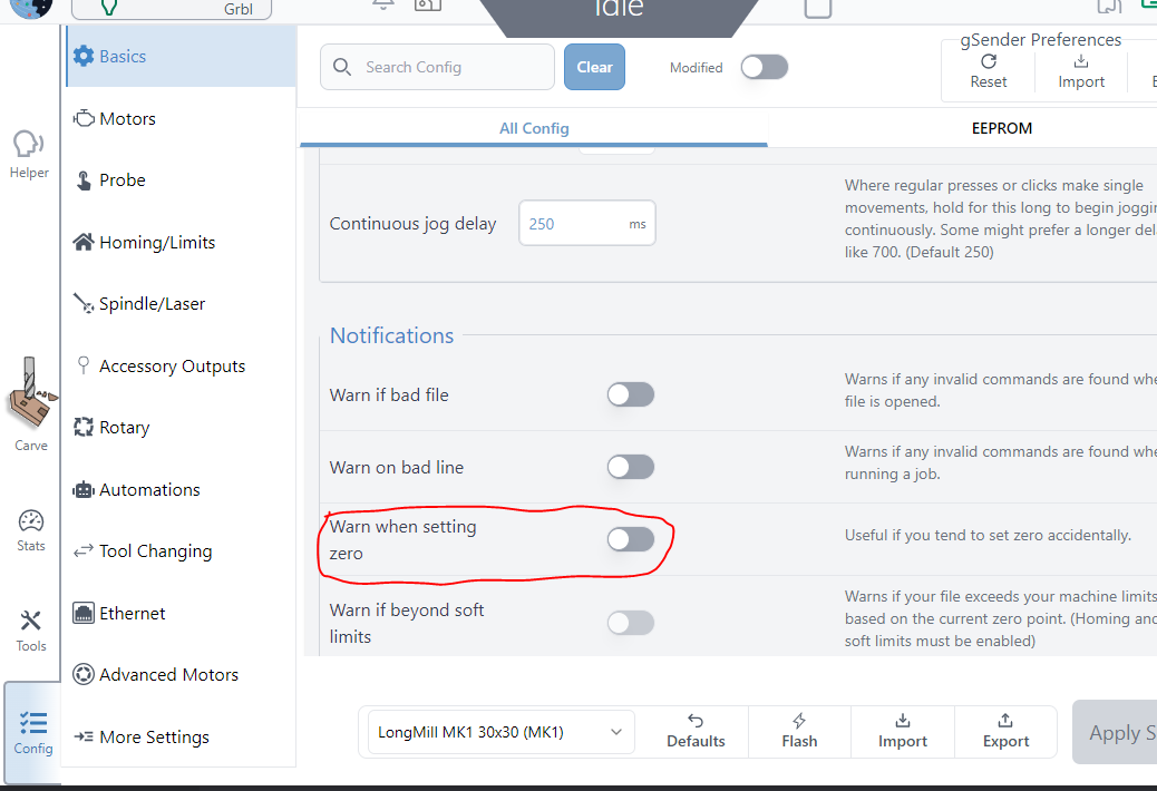

This was actually added a while ago in a different form that still accomplishes what this initial suggestion was looking for. We basically added a new setting in the Settings area (Config area for new gSender versions) to ‘Warn on setting zero’ which will always pop up a notification when you go to zero to ensure you’re actually wanting to set it. Hope that helps!
