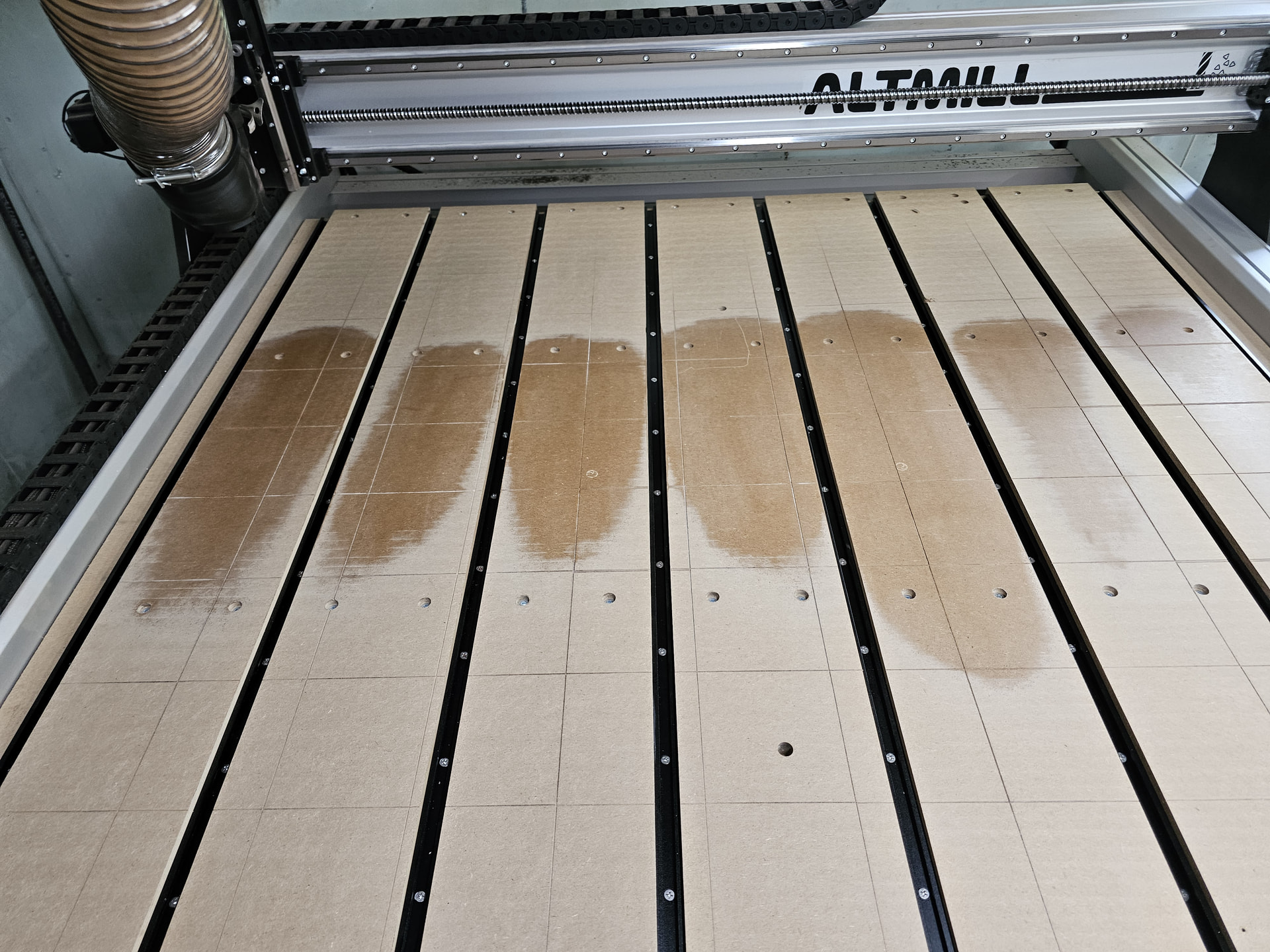

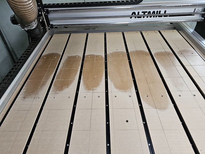

so, this is the 4th time in 5 months ive had to mill this back because the center dropped (or the outsides lifted?) I seal it immediately and its in a climate controlled shop in Maine. Now I was just thinking the MDF was probably swelling on the edges over time, but today, I noticed the cross beam underneath this low spot is also lower than the others. Its not loose :thinking:. Everything is level. Before I take my table apart to re level the cross beam, anyone deal with this or read about it?
The center sags roughly around 0.01" before I surface it out. When I checked the beam today against a straight edge across the offending beam and the two on either side of it. It looks about ⅛"+/- lower. It doesnt appear to have adjustment room to remedy that either. Any bright ideas?
Are able to check if both Y rails are perfectly flat? Also verify the MDF is actually not flat.
Y rails are flat and level/coplanar. The MDF is very clearly not flat. The grid lines i cut in are almost completely gone front and back, but middle is crisp and deep. Its flat now, just seems like I shouldn’t have to surface a sealed spoil board monthly. Im going to further inspect that cross beam underneath it later today.
@Afterlife, are your machine legs splayed out? When measuring corner to corner at the top of the legs just under the table does that measurement equal the corner to corner at the bottom of the leg measurement? Splayed out will pull the center of your table down. Corralled in will crown the table surface. While the table and legs are stout, they do move around under aggressive machine movements. People have reported an improvement in table movement from adding crossmembers at the bottom of the legs. Hope you find the cause if this post doesn’t help.
I have a whole shelf underneath. All braced. I can see what you mean how it would cause the table to do that, but say my legs are all braced as they are, wouldn’t surfacing solve the dip? I surfaced many times now with the dip returning shortly after. I do have one single beam under the dip that is lower in the center than all the rest. Just cant figure out why its doing it. Im thinking im going to redo the entire top and thoroughly inspect everything
