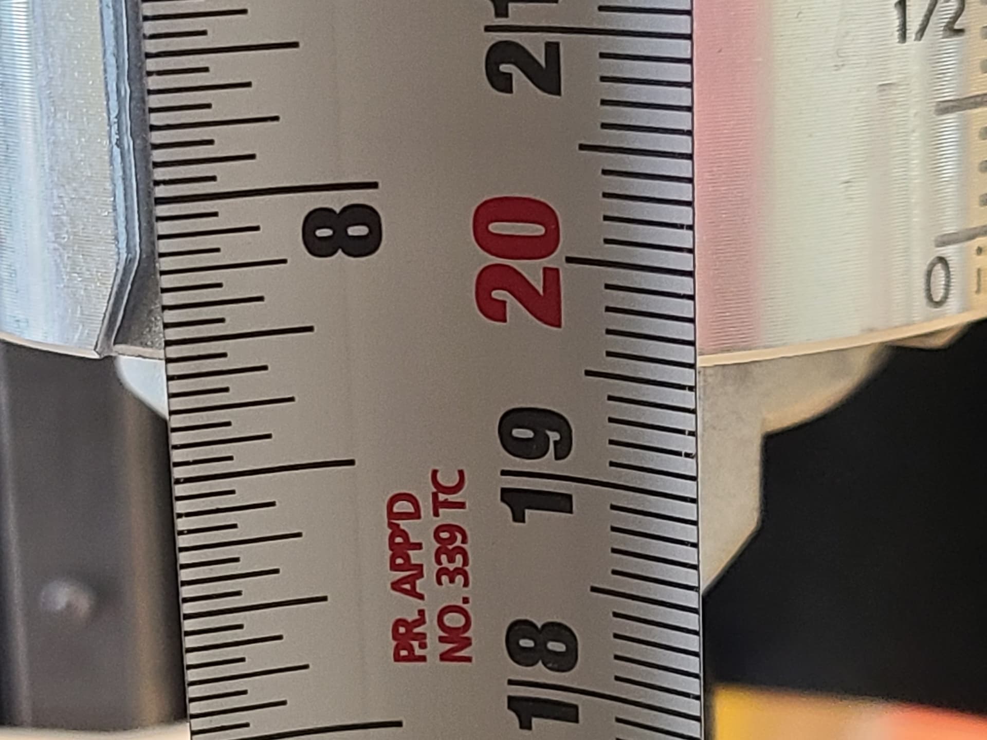

So I checked my bit ( Amana 46201 Solid Carbide Spiral Plunge 3/16 Dia x 3/4 x 1/4 Inch Shank Down-Cut #46201Specification : Direction; Down-Cut : Diameter 3/16" : Cutting Height 3/4 " : Shank 1/4" : Overall Length 2" : Flutes 2) To make sure it did not slip and go deeper into the collet. The bit was in the same place as I set it in the collect. 1/8" from the flutes into the collet. Might be my error there, but I dont think so. I am 1/8 inch from cutting through into the work bench subbase top. So I reran the gcode resetting the Z axis to the spoil board top with a piece of paper barely able to slide under the bit. Still no full cut through the spoil to be top.
I took some pictures posted here
This pic is of tri square set at 3/4 " and show it about 1/8 " from touching the top.

Since I do not know how to properly read the code and where to find the plunge data with in or if I am using the correct cutting length of 3/16 bit as the bit on IDC Woodcraft web site lists a 1 inch cutting flute length and I am using a 3/4 " cutting flute length.
I also want to mention that my CNC is mounted 3/4 inch higher than the subbase putting the IDC style spoil board even with the cnc bottom mounting legs. Pictures have reference to that and that I have sensors disconnected.
As far as I can tell I either have
  1. the bit too deep into the collet .
  2. There is a Plunge depth error ( I based this on opening the design file in Vetric and saw that the project depth was half inch) ( But the pdf manual and the video from IDC Woodcraft both reference a 3/4 " deep plunge after 3 passes.

Is it supposed to cut through?, maybe it cut part way on one side, then flip over to finish it. It’s just a guess.
I am not a g-code expert but from what I can tell looking at it, it looks like it makes a bunch of holes 0.25" deep and then cuts the perimeter. Looking at the perimeter part it looks like it ramps in and does 4 passes at -0.2", -0.4", -0.6" and the finial pass at -0.8". The rectangle it is cutting looks like it’s 49" x 33" minus the bit width. You mention 3 passes for the perimeter. Was that a typo?
You also said that the machine is not returning to XYZ zero. The code ends at XY zero and Z at 0.2". If the machine is not returning there, there may be something mechanical slipping although your photo shows a nice rectangle with no indication of slipping on the XY. I would check that the Z motor coupling is tight because slipping there could cause it to not cut through.
Maybe kinda obvious but have you checked the material is 0.75" and not over? Just trying to cover all the bases here.
Edit: Off topic but I like your setup! This might be the first time I’ve seen a full sheet on a LongMill, those new machines are HUGE!
Edit2: I thought of a way to check the Z axis travel is correct. I’m assuming that you still have the sheet of MDF on the machine and don’t want to move it so that your cuts line up. Without changing the XY zero I would put another piece of material 3/4" thick on top of the MDF. I would then zero the Z on top of that. Then I would remove the new piece and carefully lower the Z axis until it’s just touching the original MDF. If you’re not at -0.75 or really close then somethings up.

I checked that and had 1/4 inch of travel down before bottom stop on the Z Axis. I also readjusted the 3/16 Endmill downward and rezero the Z axis ran pass two and still no cut through on the right front corner of the spoil board. ( I messaged Garratt from IDC Woodcraft of the video linked in his instruction guide and Garratt instructed me to lower the z manually. As I am very green with the CNC after pass five and still no cut out I pushed pause in gsender, turned off router and used my hand to turn the ball screw until the bit touched the subbase and the restarted the router and hit the continue in gsender. Six pass did cut the remained but that is not how the CNC should be operated. This is what I was left with on the subbase see the three photos.

according to the video that is linked in the pdf the gcode does a Through cut with 3 plunging passes of the spoil board for the 49" x33" x 3/4" For some unknown reason to me the CNC running gsender does not cut fully through on the right side and after doing step five it appears the issue starts in the front center to right side after center point of the X axis. I have measured from the Z Axis at top stop to subbase and here are my results to the router bottom with the Z axis at the top stop I get 19.4 cm at the far left X axis and all the way forward of Y axis . From the center of the X axis still at all the way forward on Y axis I get 19.6 cm. From the far right of the X axis and still all the way forward of the Y axis I get 19.5 cm.
In summary there is a difference of 1 mm from the left side to the right side with a slight dip in the center of 2mm greater than the left and 1 mm greater than the right. The final cutting pass is at .8" on a .75" MDF board could that 1 mm be making such a huge difference being that 1 mm is equal to 0.0393701 inch and 2 mm is equal to 0.0787402 inch Reminder that the center part of the cutout cut through just fine it was the right front corner along the right rail from about 3 inches center to right and 4 inches right front to right rear. It is almost like the cnc is slightly lifting during cutting on the right side.

Check the flatness of your main spoil board. It may not be as flat as you think, or the underlying support of the table (torsion box??) may have some gaps causing a bow to happen
I can’t remember if the IDC file and instructions require you to surface the secondary board you are drilling holes into or not. If it doesn’t and your main spoil board is not flat, your cut-throughs will not be precise.
Since the issues seem to be on one side or corner, my guess is you have a slope in your spoil board, or the project wood is warped or the project wood thickness varies in areas around the piece (I find it hard to believe that the wood is a perfect 3/4" all the way around the piece. Not saying it isn’t possible just hard to believe).
The same for the main spoil board. Not consistently the same thickness, so there are low spots and high spots. You would need to surface your main spoil board
Check the thickness of the area where the bit did not go through the project all the way and see what the thickness is compared to where it did go all the way through. Use a caliper.
If it’s not the same, you will have to add a millimeter or two to the cut depth to get through the board - which will eat into your main spoil board, especially in the areas the board is high.
If it truly is the same, it’s not the piece that has varying thickness, but more related to the spoil board itself.

Rechecked level and my table is level front to back on left side, front to back right side and front to back center. Then I also checked the left and right rail’s subbase with a 4 ft level and both the right and left are level in the front to back orientation. Then I checked left to right on the table itself and across the tops of the Y axis right rail and Y axis left rail that too is level. I even checked the X axis gantry for level. Only issue I found is 8 inches from the right rail towards the center is a gap under the level I used a multiple feeler gages and measured .031 inch. See photo previously uploaded labeled Right Rail with groove after six passes step 4. This would account for the variance in height from the table to the X axis gantry bottom. Yet As I see it table is level with a slight dip (.031 inch) in 8 inches from the right rail front towards the center. I am going to rerun the G Code and watch what the Z axis does. I used a caliper on the mdf and the MDF prior to seal coat on the bottom was .75 now the reading is .76 and that measurement is consistent all four corners and all four centers. Sheet of plywood that is the sub base is .75 also
It sounds like the plywood is not perfectly flat which is to be expected really. After you mount and surface the spoil board all should be good as you are very close to flat and have been really meticulous, not a bad thing, so far in your assembly. That’s my two cents anyway.
