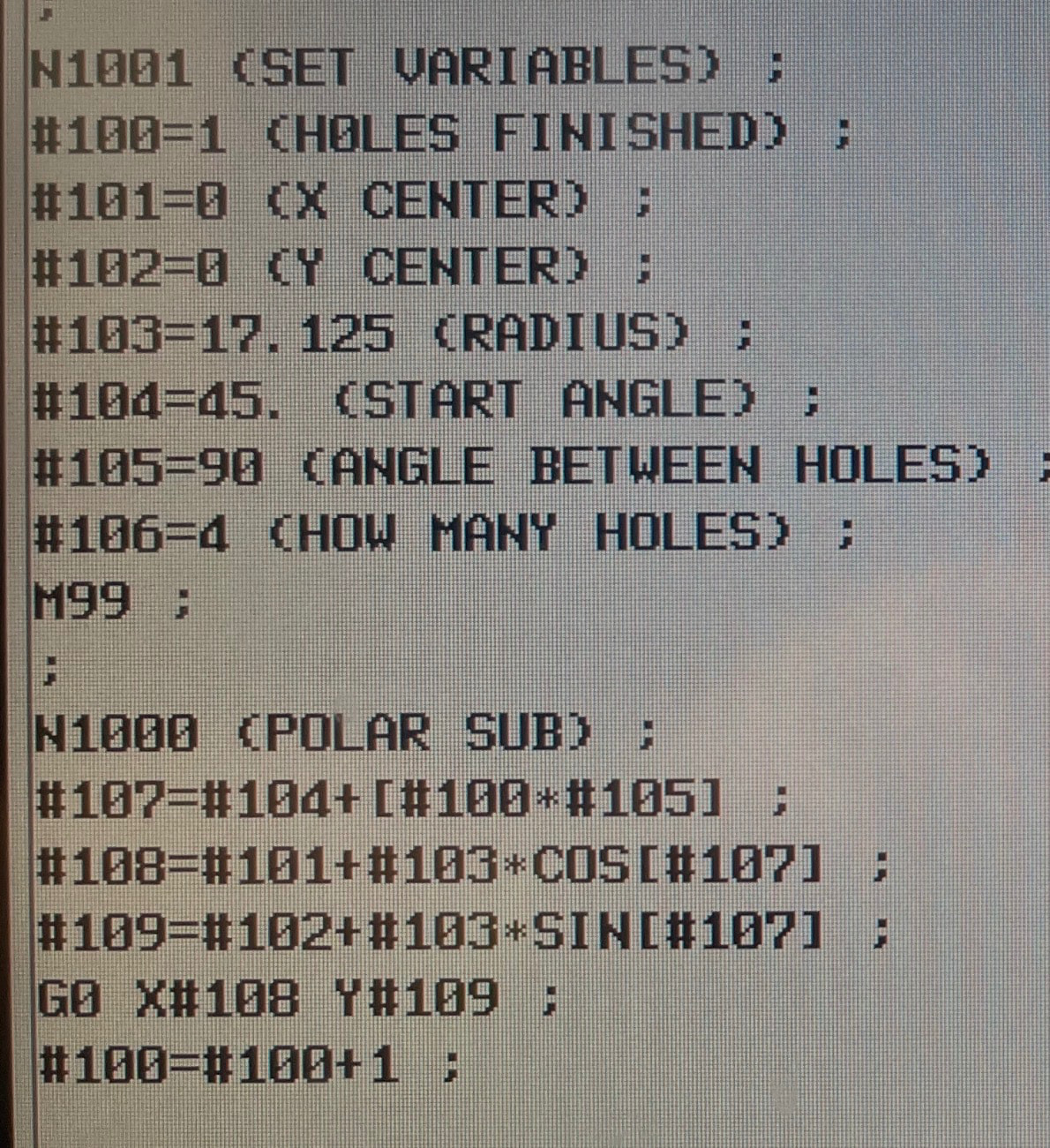

Mathematical macros
Does Gsender not allow mathematical macros?
for instance, this bolt circle macro:
If not, how are people working around this?
@scottwhisler Your syntax might be wrong. I think variables should be defined with % instead of #
Additional Features - gSender Docs
Hi Chucky,
Thanks for responding.
Yes, this code is from a macro I wrote for a fanuc controller. I just threw it out as a sample of what I’m looking to do. I have not found success yet trying to do bracketed math calculations.
I read that some GRBL controls don’t allow them, hopefully Gsender isn’t one of them.
You weren’t super specific here on your file type or controller/firmware type so this answer will be equally non-specific.
If you are trying to write a gSender macro, you can do basic math/variables using the docs provided by Chucky. These expressions are evaluated through a ECMAscript interpreter before being sent to your controller so you’re able to use the full JS library for math functions on top of basic arithmetic. This will give the same result on grbl or grblHAL controllers since it’s evaluated before being sent to the controller by the sender.
So for example, you could use Math.cos(myVal) in your example
If you are using grblHAL, and are looking to write more in-depth g-code files or SD macros (not gSender macros), you are able to use NGC expressions, which are similar to linuxCNC standard and probably the closest to your Fanuc example. This must be compiled in to your grblHAL firmware.
In general, if it’s expressions/logic inside a sent file, you’ll need to make sure that your controller supports it, it’s not a gSender responsibility, it’s the firmwares responsibility to evaluate.
See documentation here:
We are using NGC expressions extensively in our new ATC system macros, so if you’re looking for real-world examples you can check out that repo:

Scott, I wrote some macros that help probe corners, circular hole centres etc. with my 3D probe, and also one that uses circular geometry to calculate the rotary axis centre height (Z) by probing the outer curve of the chuck.
This uses Sin() etc amongst other maths, so hopefully gives you some insight into what is possible.
(PRB.YZ X-aligned Shaft CL-TOP with Trig-Centre-Calc Z zero)
