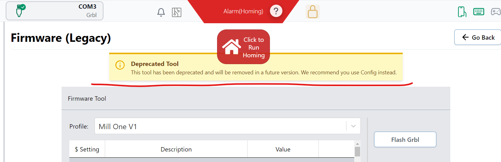

gSender 1.5.1 did fix the jogging issues, But I still have to connect to last active port in the tool menu for firmware every time for my machine to get all to work and just found out that the little pad lock at top of screen will connect to my firmware like in tool menu.
So here is what is happening with everything on I to connect GRBL on com3 then go to tool menu then firmware then (connect to last active port) then all works but if I only connect GRBL on com3 then home machine it works but like it’s some other default firmware and my machine doesn’t work right, If I go straight to tool menu and firmware and
(connect to last active port) all works but it will not give me a way to disconnect form the machine I have to turn machine off manually.
Is this me not doing something right or is a gsender problem ?

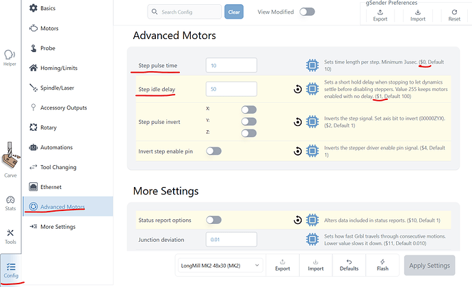

Gotcha, so I think maybe if you update your process you’ll see that things are hopefully actually working correctly - I’ll explain:
  1. The Firmware tool that you’re going to is actually deprecated which means that we left it in there since it was easy to keep but it also means that you can’t expect it to work fully properly
  2. How it works now, is that you should instead be able to find all your firmware settings in the ‘Config’ tab, and this should be filling with your machine settings right away without having to disconnect and reconnect again
This is the new way gSender is designed to work, we cover it in the documentation here: Setup & Layout - gSender Docs
Hopefully that finishes answering your question and if so then I can close this topic?
