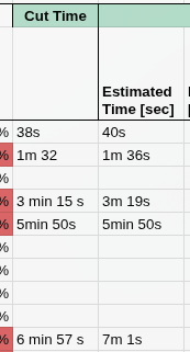

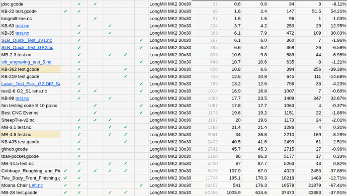

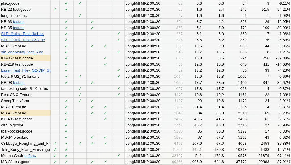

Some sample data as we run test files - a few data points with the new algorithm:
Old algorithm data (we’ll have this filled out similarly for new algo once all files are tested)
