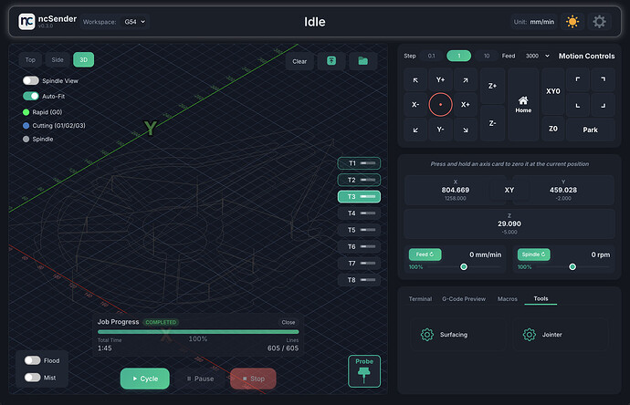

ncSender — Finally Ready for Public Try! 🚀
After a month of caffeine-fueled late nights and tag-teaming with Claude, Codex, and Gemini (with occasional frustration and yelling at the screen :sweat_smile:)… I finally did it.
ncSender is now ready for public testing! :tada:
It’s built with simplicity, speed, and extensibility in mind — no more monolithic all-in-one beast. Here’s a quick look at what’s inside:
:gear: Key Features
  • :puzzle_piece: Plugin architecture — Extend functionality instead of big code base core.
  • :triangular_ruler: 3D Touch Probe — Supported right out of the box.
  • :bar_chart: Feature-packed G-Code virtualization — Includes multi-view options like Spindle View and Auto-Fit, plus Out-of-Bound indicators and on-screen warnings to keep your jobs in check.
  • :laptop: Refined terminal — Cleaner and more powerful for advanced users.
  • :eyes: G-Code Viewer — Displays crossed-out executed lines so you can track your job in real time.
  • :hand_with_fingers_splayed: Touchscreen optimized — Perfect for kiosks or tablet setups.
  • :shield: Safety first — Long-press required for critical commands to prevent “oops” moments.
  • :electric_plug: Auto reconnect — No more connect/disconnect drama; ncSender silently retries in the background.
  • :house: Improved G-Code Visualizer — Home indicator, real-size workspace, and cross-section view of your machine area.

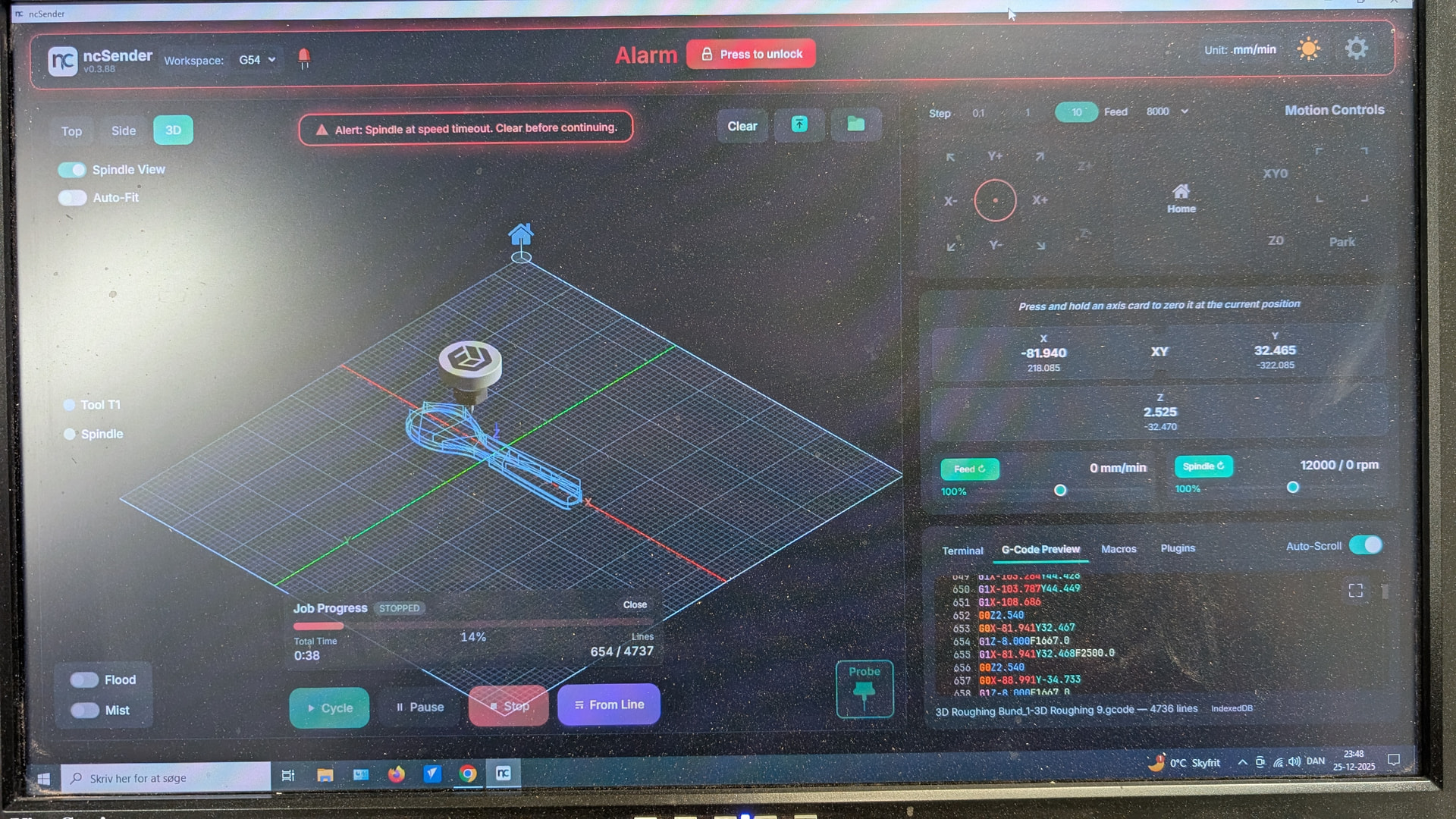

I had some Alarm 14 error on it, thought it was the grblhall, flashed back but the error is still there.
It’s the spindel timeout error that other has on the controller, using Modbus, don’t know if is’t a controller error yet, but it’s very annoing.
@siganberg
Not sure if it is a bug, but when you run a job and have to stop it, it stops down and require a homing and all control features is grayed out.
That means I have to start gsender up to get Z up over the job.
I think it should return to safe Z over the job.

That is not normal. Although its not gonna work 100% on sienciHal as I use some command that is not available with the old sienciHal firmware.
I thought so, that it could be the SienciHall feature. :slight_smile:
I could see that you stoped it in a job and that did’nt trigger a homing cmd.
So far everything works fine on old firmware, I had to switch back beause of Spindel timeout and a door open issue.
Still have that spindel timeout issue and had to shorten two door pins on the board, to get it to work, it was just locked in Ncsender and Gsender.
It can do a job tho, if I don’t mess with spindel rpms, while its running.

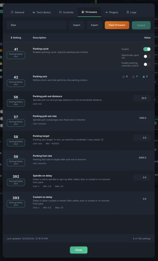

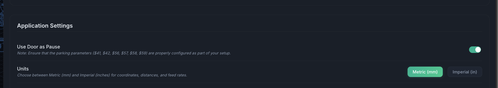

Maybe it’s the “Use Door as Pause” setting. Try turning it OFF. It’s ON by default.
That said, this feature is actually nice. I tested it before on sienciHal firmware and it works well.
You just need to configure some of the $xx settings, which is probably why yours is throwing an alarm. It’s likely not fully configured yet.
Basically, when this feature is ON and you pause a job, it stops the spindle and retracts. I find this very useful compared to gSender’s behavior, where it basically just stops XY movement while the spindle keeps spinning.
Also try the new version. The Stop should not send Door command anymore, instead it will send Pause command wait for 500 ms and then soft-reset by default.
Door and Parking is off.
Sienci told me to short the two pins on the board, because it would not stop the Door error, it was off in settings.
There is somthing wrong with the board i think, I’ll write to support about it after the Holydays.
I’m on the latest NC, I’ll try the pause and stop feature tomorrow .

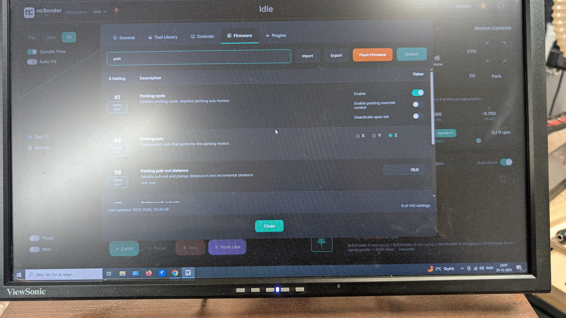

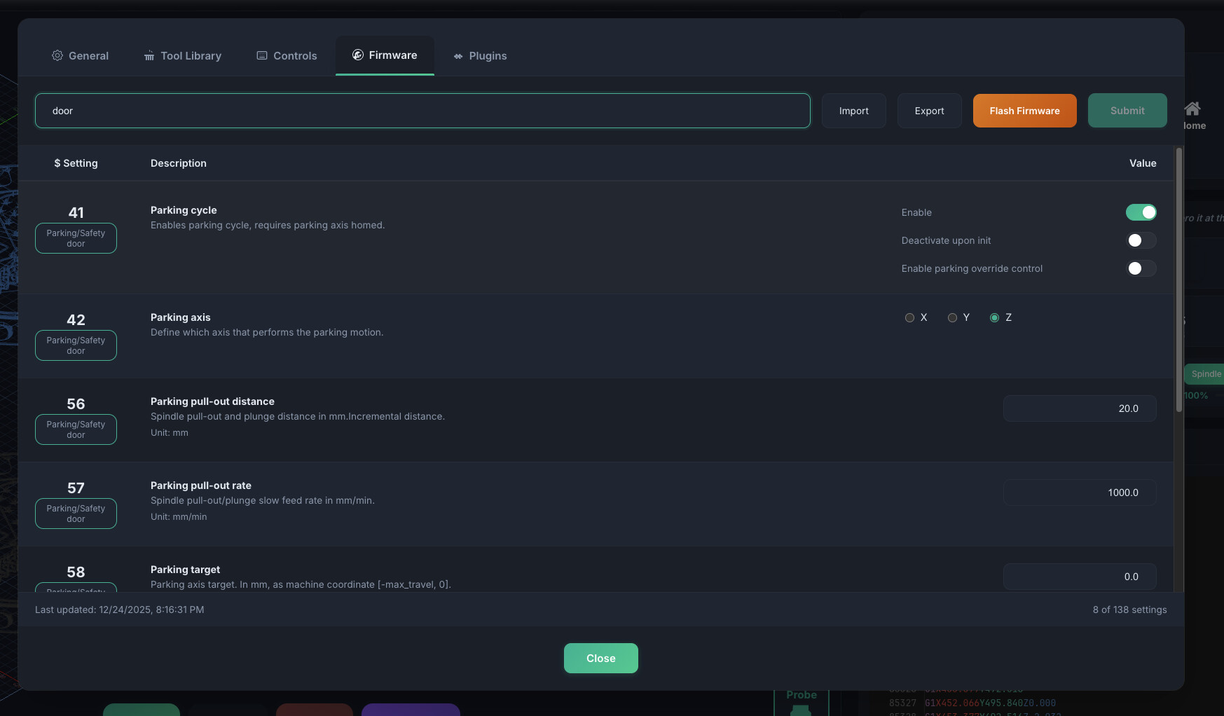

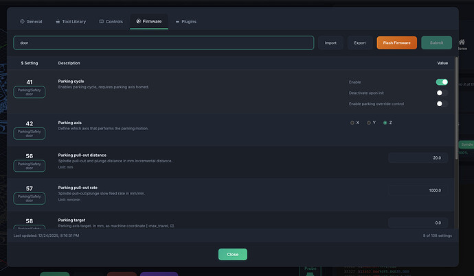

@siganberg
Hi Fransis
I have tried the pause feature it kind of works, but it does not retract on latest Fw. It set to 5mm.
The stop issue percist, it gives me a Alarm 14 (spindel timeout)as usual, but the spindel does not stop until I push it on the screen.
It’s the board not Nc.
What firmware. You mean you enable the “Use Door as Pause”?
This require you to change the Door settings to retract it.
Spindle issue are firmware settings related, nothing to do with sender. What VFD are you using?
Hi
I have set the same settings in parking as you, it pauses, but it won’t retract.
The pins on door switch on the board is closed, because of a sudden issue that I could not get rid of without shorten the two of the pins. Sienci told me to do that.
It’s a Hyanyang 2.2 kW, it’s a modbus/ controller issue like others has in here, I will contact Sienci when they are back.
Is this AltMill? If yes maybe you can use my backup firmware settings and just change the VFD settings and modbus address after you restore my backup firmware settings that you can find on my github cnc-stuff repository.
Also I don’t know why you need to shorten the door pin. I never done that on mine for 2 machines.
No, it’s a Ratrig with SLB-EXT controller and CLS motors.
I have fixed the pause problem, I did’nt ticked it in general settings, but now i have, - it’s working now.
