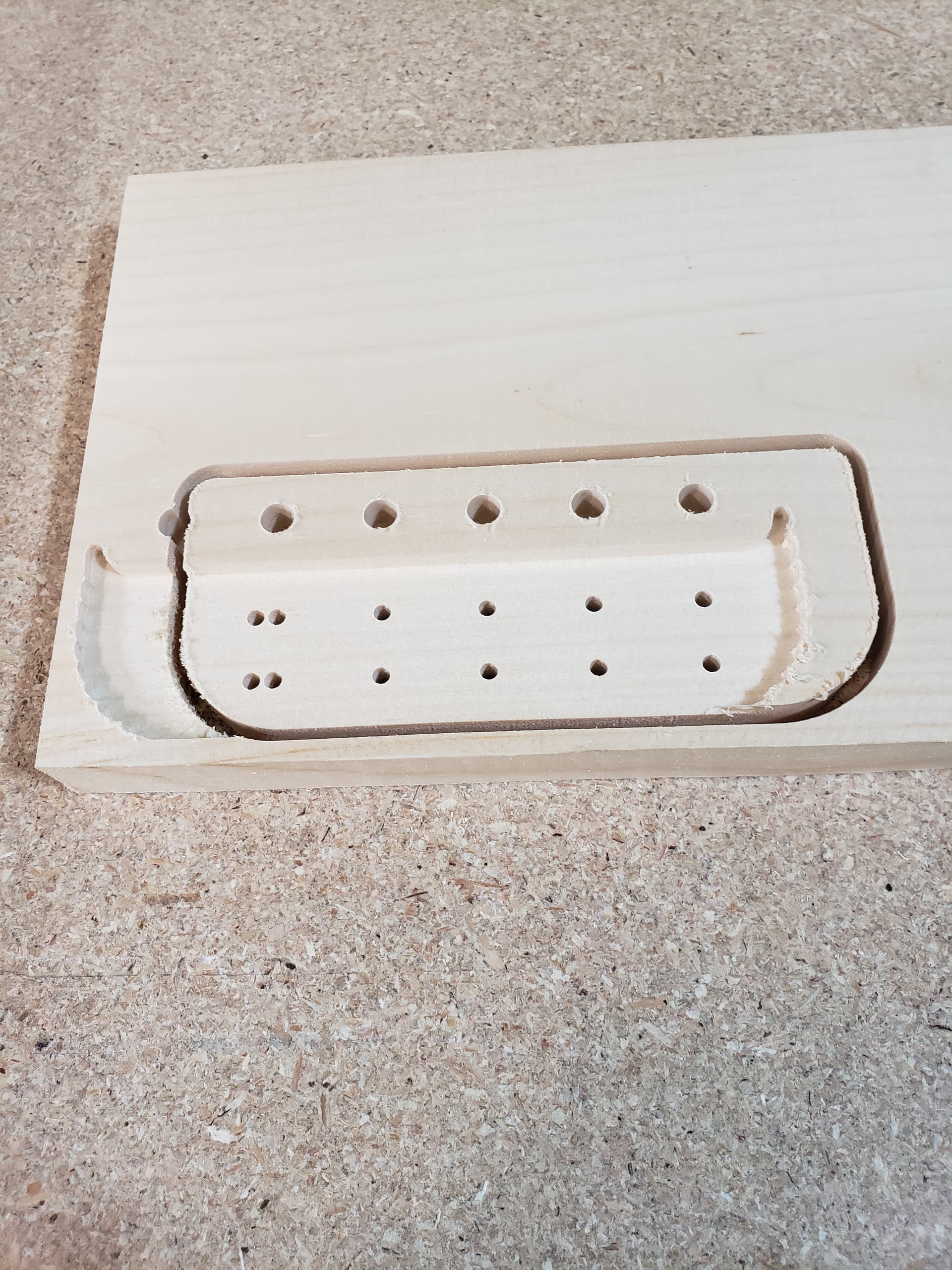

Why is this starter progect fron Sienci Labs. Keep cutting wrong??

I downloaded the gcode, loaded it in gsender, and everything looks fine. It is all lined up.
Yours though appears to have been going okay until it shifted to the right for some reason. Is that what happened? I’m wondering if something on the X axis is a bit loose or too tight

It looks like it is something with the Xaxis. If it is not tight enough it can cause it to slip when it encounters enough force. Gsender or whatever you are using to run the gcode will keep running smoothly even though the router stopped moving for a second.
Maybe check the couplers. See if the set screws are all tight and set correctly

Thanks for the help will check things again. The coaster cut fin also its just this one, just odd
2nd try after checking everything :man_shrugging::man_shrugging::man_shrugging::man_shrugging::man_shrugging::man_shrugging::man_shrugging:
Odd. It is a slightly different result though. In the first attempt, it was a different set of 1/8" bit holes that were right next to each other.

If everything is tight, and it is known the gcode is good, have you checked to ensure your workpiece is not moving.
Yes, have cut the longmill sign no issue the coster no issue. Just this one

@Vols2023 I should have been more specific. When you clicked on the link on the Sienci website, you were prompted to save the bit-holder.nc file. That is the file that the members here can look at to make sure something didn’t go wrong with the download. It’s not likely, but since you have successfully done other Sienci project files and you have confirmed that the material is not moving, ensuring the nc/gcode file is good will eliminate another possible cause.
This is what i tried today different project starte great and then goes to sideways. Think something is wrong with the machine.
Same shift as the bit holder
@Vols2023 Tim check coupler as @Swinly said, also may have issue with backlash nut or wheels too tight. All on the x axis.
I adjusted the v wheels can barely turn with fingers, will check coupler
Coupler is tight, backlash the bolt is finger tight, and can spin x axis with fingers
Even when the couplers seem tight, sometimes they’re still not quite tight enough and a lead screw can slip. My Z axis did this when I first assembled my machine and I had to eek out just a little bit more squeeze from it.
