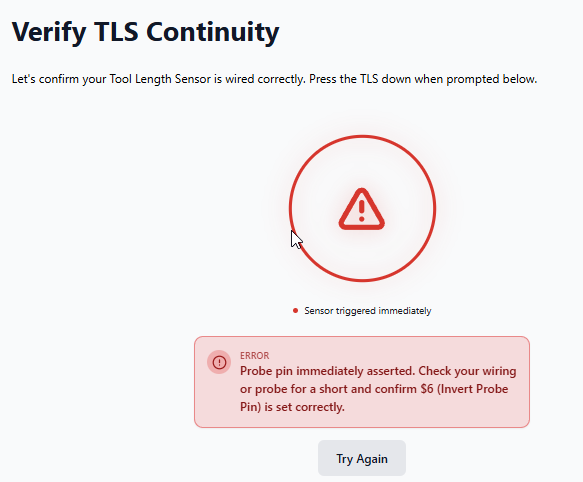

I went through the setup wizard for the TLS, and got the following error.
After exiting the wizard, it set the probe and tls switches, as my screenshot shows. When TLS is greyed off, the Green Probe stays lit, no matter if the Probe and or TLS are connected or disconnected. It is almost as if something on the SLB is shorting out the TLS port.
Also, I have found the LED’s on the SLB, Probe lights up as expected when TLS is inverted in GSender.
TLS LED will not light under any circumstances with TLS inverted or not, with the TLS connected or disconnected, button pressed or not.

Spoke with Danial again in support, we confirmed the board is showing the correct value when shorting out the pins on the board with the TLS led lighting up. So the TLS itself is faulty so is replacing it.
