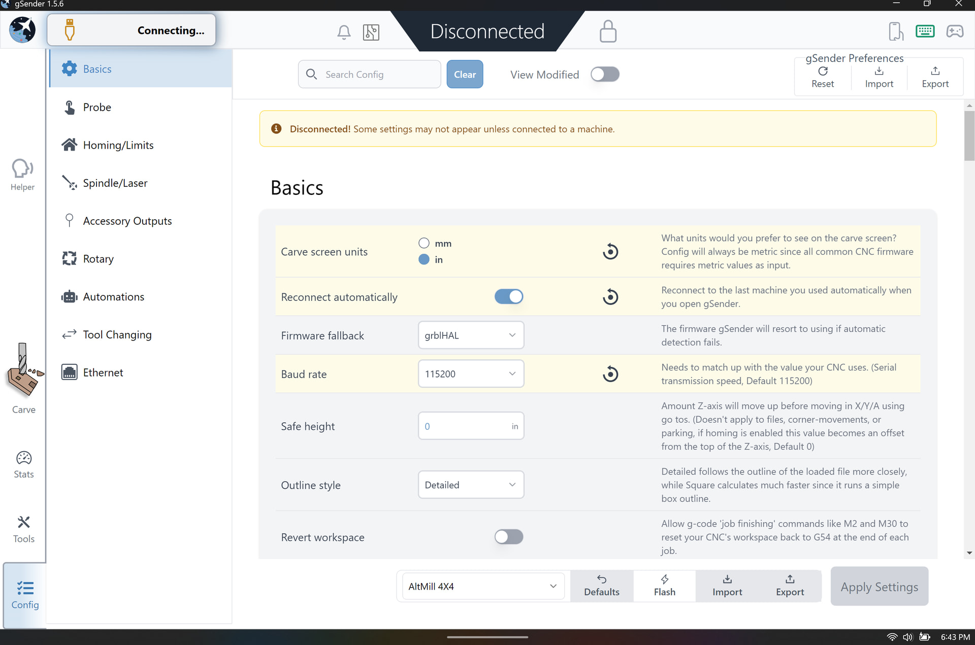

I just received my Altmill MK2, but am waiting on the spindle. While I wait, I figured I could at least run it around a little and get familiar with things and maybe attach my laser to it, but I cannot get gSender to recognize the unit at all. Here is my setup:
  • Altmill MK2
  • SLB-EXT
  • No Spindle (honestly… could be the problem?)
  • Surface Pro Snapdragon (ARM), 64bit
  • USB-C Cable (shows as COM3 in device manager, Hardware IDs: USB\VID_0483&PID_5740 REV_0200; USB\VID_0483&PID_5740)

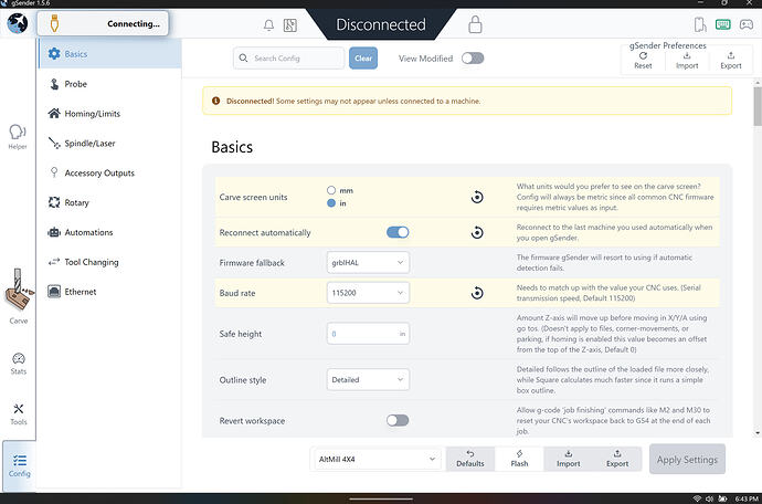

  • gSender 1.5.6. Configuration unadulterated, log file available if I could upload.

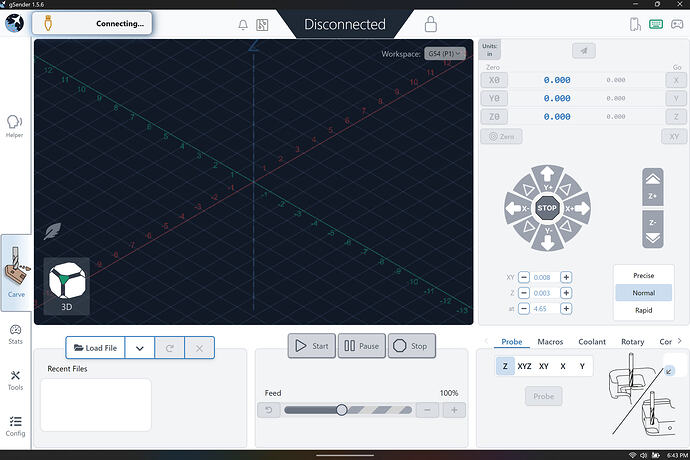

The current state is that gSender constantly displays “connecting” regardless of USB connection, meaning with nothing plugged into the laptop, it also says “connecting” almost immediately upon opening the program. Plugging the USB in causes Windows to chime in acknowledgement with no change in gSender. Hovering over or clicking the “connecting” icon has no impact.

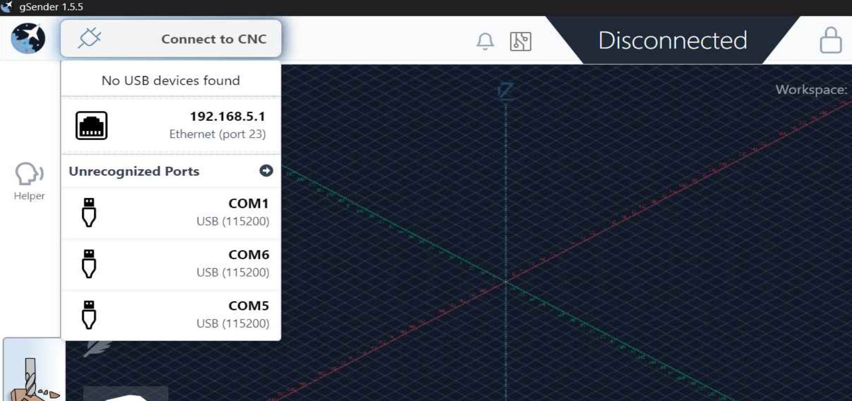

If you have not already resolved this:
Turn off auto-reconnect
this should then change the “connecting” message to a menu you can better identify what is going on.

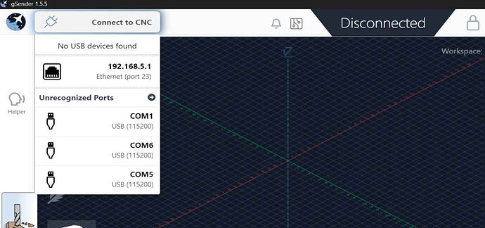

Plug in your USB and one of these ports (unrecognized on mine) should be your SLB-EXT. Click it to select and connect.
Hopefully that helps but as others have stated, I would definitely go the ethernet route.

Ding ding ding! Turning off auto-connect solved my problem. I also have an ethernet adapter on the way per the other’s advice. Thank you everyone for the help.
I did worry that the ARM based machine was part of my problem, but I can now attest that the machine/gSender work just fine with it; tho all I’ve done so far are some manual commands and jump around as much my headache will let me.
