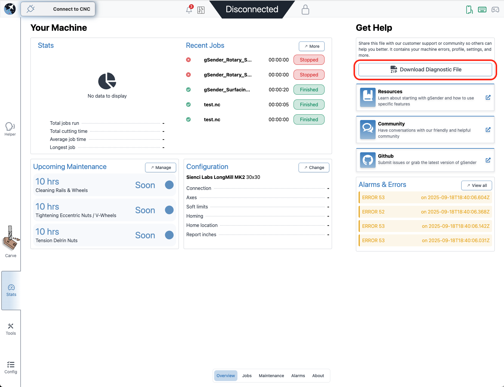

If you’d like, you could share your diagnostics file to help us debug the problem. You can download the diagnostics file from the stats page:
Thanks for getting back to me.
Unfortunately the overview screen is not functioning at all.
No job total no record of alarms and the download diagnostic file button is nonresponsive.
Should I download a fresh version of the program?
Thanks Stan
Just discovered that a few features were not working. Thought it would signal a new update like before but did not happen. So I uploaded the recent G Sender and although the normal speed was still wrong the diagnostic page was working. I have attached the file. Hope that it helps.

Attached is the diagnostic file.
diagnostics_9-19-2025_20-11-13.zip (59.1 KB)

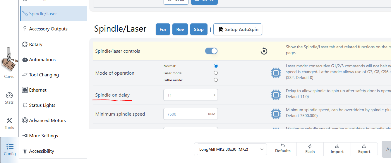

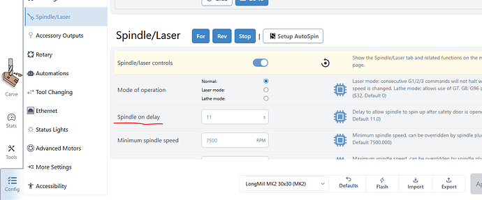

Regarding your other issue, can you give a bit more information? When you get the time out is it a message in gSender? If so then perhaps look at increasing your ‘Spindle on delay’ since that will make the machine wait a little bit longer for the spindle to spin up and then you shouldn’t see the alarm anymore
