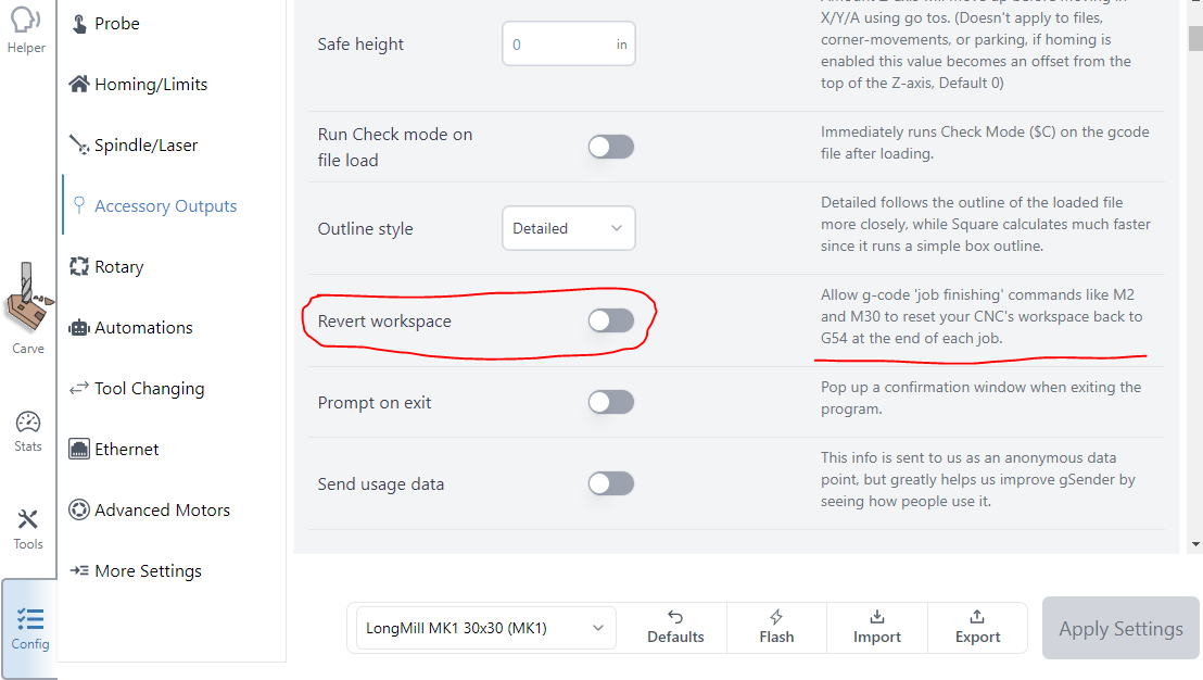

Hey all, just wanted to round out this older post with some final help and solutions.
Firstly, as @gwilki mentioned, the majority of these issues with workspaces reverting are a simple matter Fusion, Vectric, or whatever other software putting an M2 or M30 at the end of the job to signal “end the job and revert everything back to default” and thus both grbl and grblHAL will revert the workspace back to G54 like they’re told.
I don’t know what the reasoning or origin of this is, likely it’s a spillover from industry where CNC operators went to school for a couple years and had absolute micro control over their programs, but either way I can totally understand present-day users getting caught off guard by this and having jobs ruined. To circumvent this issue we first had a ‘patch approach’ mentioned in or troubleshooting docs where putting %global.state.workspace=modal.wcs in the program start code and [global.state.workspace] in the program stop code would ensure that the current workspace on program start would be kept on program end.
Nowadays, newer versions of gSender have a new Config setting called ‘Revert workspace’ and we’ve made it so that gSender will maintain your starting workspace by default and only if you turn this setting on will it disable this functionality. We felt this was the best approach to making things make the most sense to everyday users, meanwhile giving power users the ability to disable the ‘safety’ feature if they want M2 or M30 to revert it in line with their industry knowledge/expectations.
Hope that all helps out
