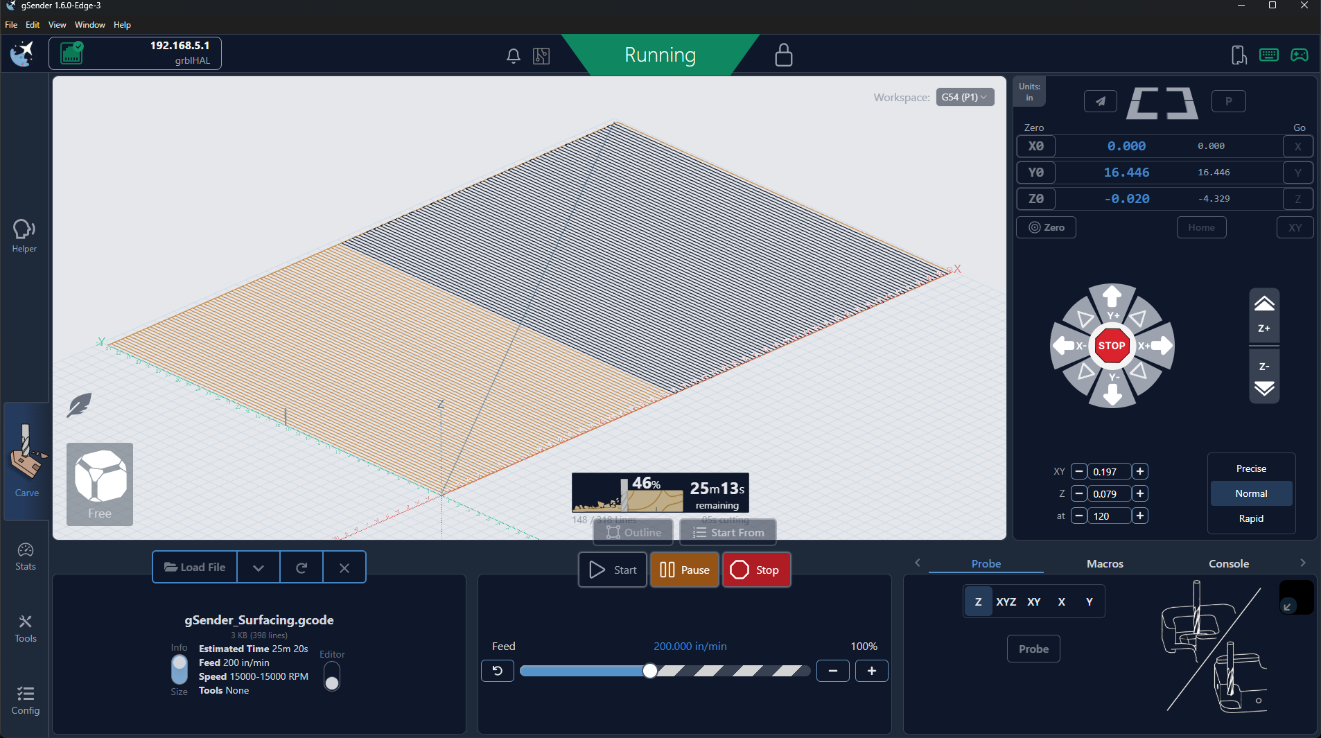

Percentage always 99%
I dont know if this is just my gsender edge but at the start of a file it says 99% and it stays like that regardless if im at the start or end of a toolpath. I am on the current latest version of gsender edge
@duke_b4u2 This seems appropriate
Can you share a bit more information, like the file, type of file (3 axis, rotary, etc), firmware type? We’re not seeing this internally.
3 axis longmill MK 2.5 48x30 grblHal, today I was doing another program surfacing my spoilboard and when i ran it it started at like 40 something percent instead of starting at 0% finished. also im on gSender 1.6.0-Edge-3 I would upload my exact config but its not letting me right now. I feel like I may see a reason this is happening though you know the orange lines that says where its going to cut? these orange lines at the end of the orange lines looked roughly 40% of the board when I started so maybe its calculating at the end of the orange lines and not the tool its self? thats my best guess for right now. tell me if there is any more info you would like
I can send video of this happening rn I have 4m 50s on a spoilboard surfacing it says 99% even though this is a 31m 35s cut. it starts at 99% if its a smaller file but this large spoilboard surfacing which is running as im typing this infact once it gets to a point it just reads 99% for like most of the time.
