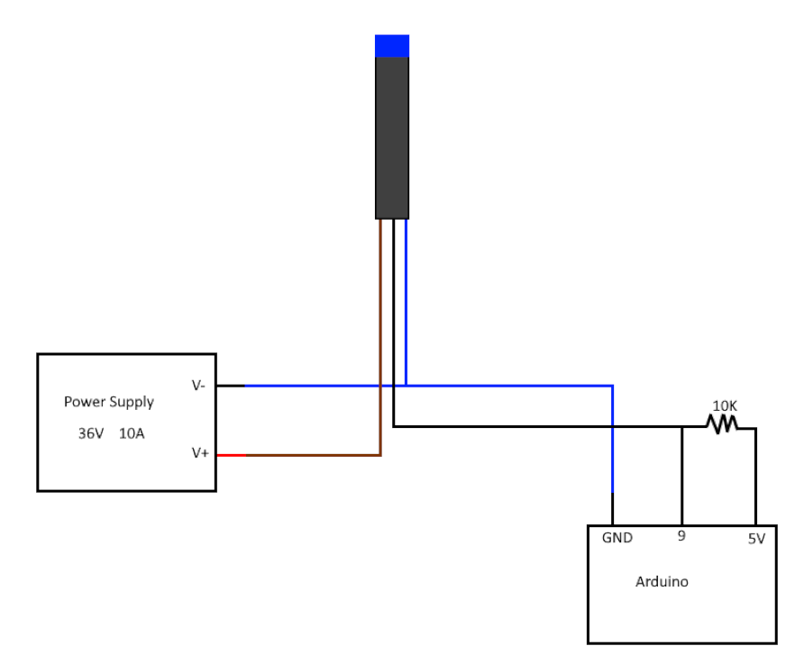

I am using gSender, grbl and Arduino Uno to build a CNC machine. So far all three axes are moving. I have started putting in the limit switches. I am using NPN proximity sensors and have only one installed so far for the left side of the X axis. The sensor has three wires. Brown for +V, Blue for GND, Black for signal. I have wired it as in the sketch below.
The problem is that gSender shows an Alarm when I connect the the Arduino controller and says that a hard limit was triggered and I cannot clear the alarm. The proximity sensor is not near any metal and I do not know why it was triggered and why I cannot clear the alarm. I am at a loss at the moment. Can anyone point me in the right direction?

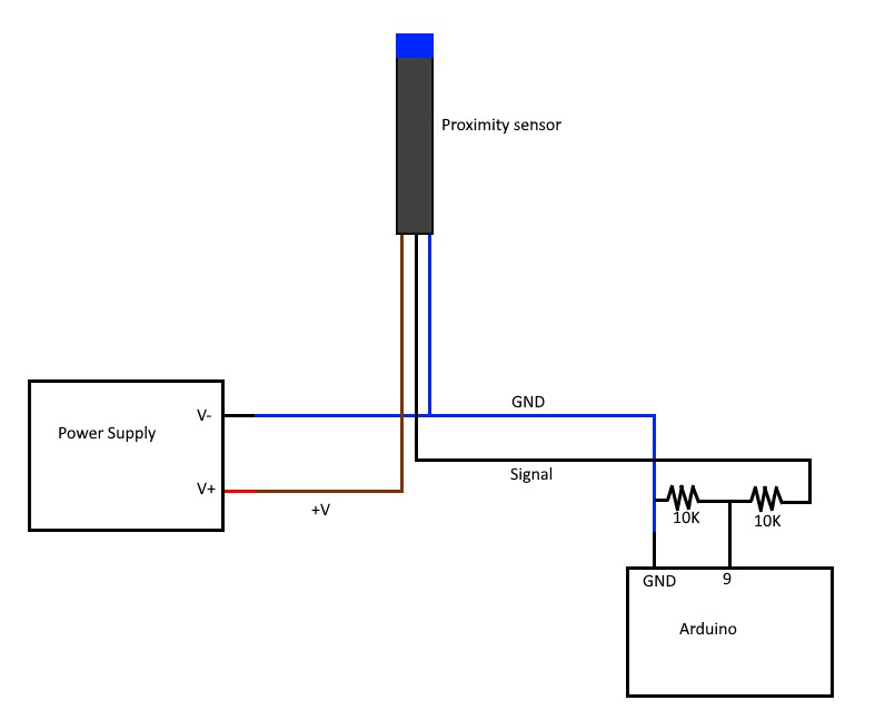

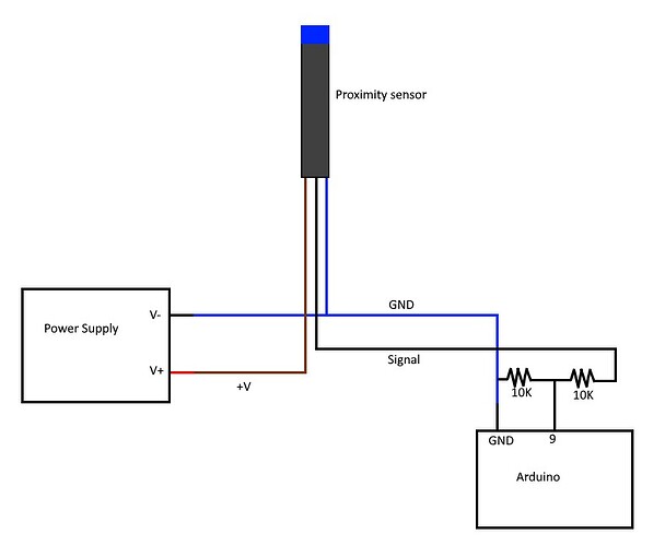

I also had the wiring like below, but I also could not clear the alarm here. Before I built the frame of the CNC I had all the components (motors, drivers, PSU, and one proximity sensor) wired to test and then I could clear the alarm.

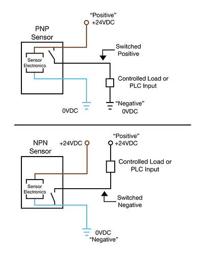

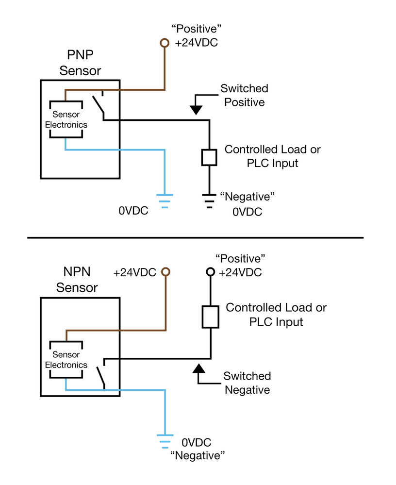

Take this with a grain of salt because I’m no expert in this area but are you sure you don’t have it wired like a PNP insead of a NPN?
According to this diagram I found, a PNP has two negative connections and one positive like your diagram. The NPN has two positive and one negative.
The article the diagram came from is here.
Like I said I’m not strong in this area but I read up on it a little when I was thinking about getting a 3D probe. I haven’t got one yet so I haven’t done the wiring for PNP or NPN myself.
EDIT: I found another article that shows the same diagrams but does a better job explaining things IMHO.

What is this 36V 10A power supply doing in a digital signal needing 5V?
