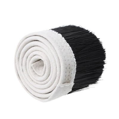

@HKingUK You might want to look at something like this on amazon uk

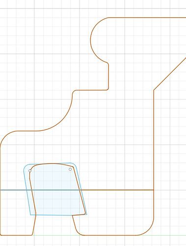

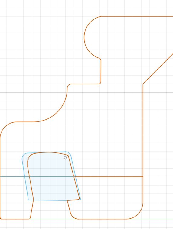

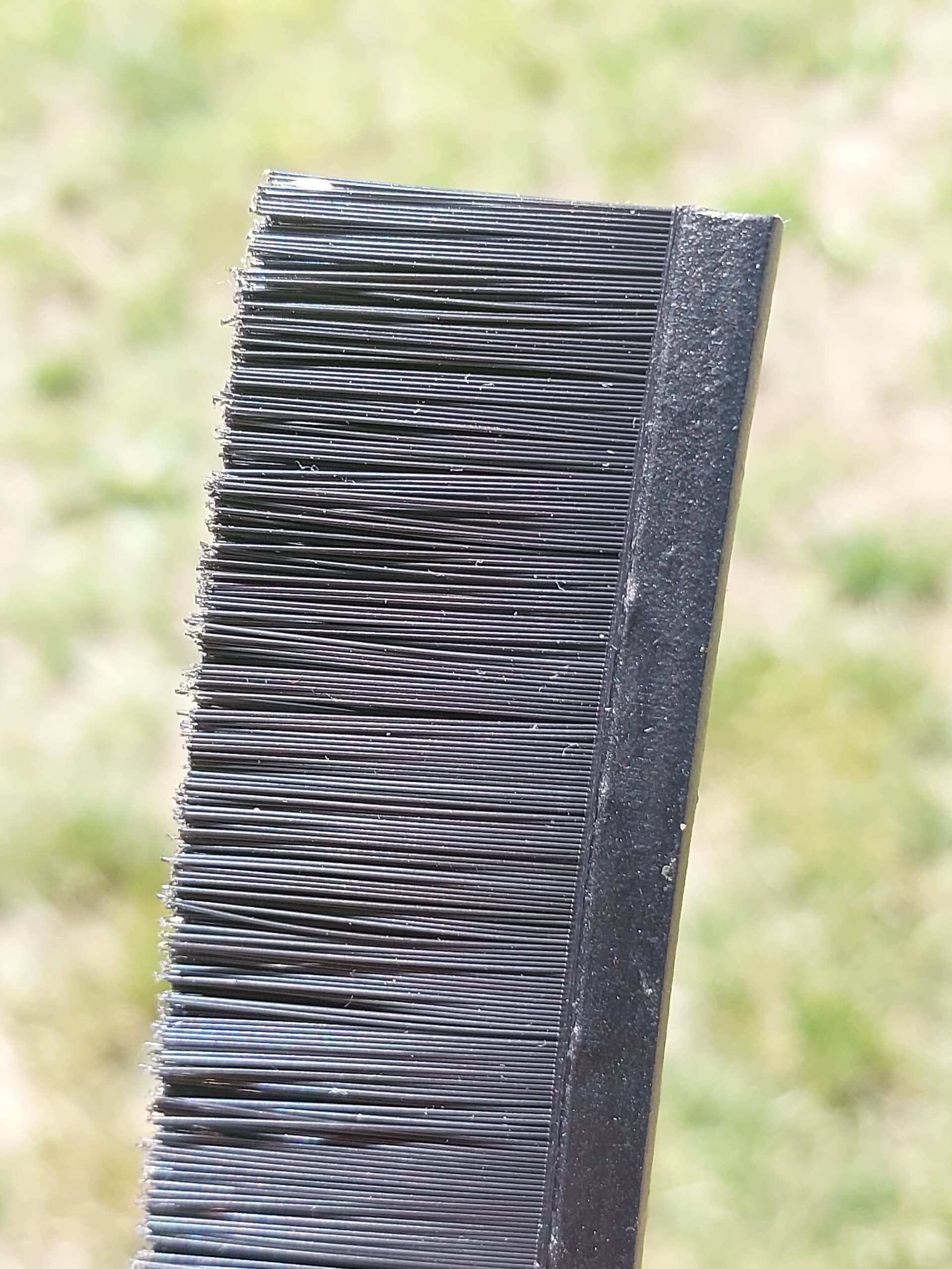

I was very surprised a the lack of response on the original brush material. For North America the Mcmaster-Carr flexible brush is very high quality but will not fit the original sienci
stl file. Opening or closing up the gap in the stl is fairly easy in the free version of fusion 360, using sketches and sweeps. Some of the brush material is not flexible. If you do find something that suits you in the UK, its not hard at all to modify the file and print out a new brush holder.
I uploaded the .f3d file here for the brush holder. Altmill 80mm Dust Shoe - No Windows by don-f - Thingiverse editing the sketch 2 to whatever size you need should cut down the work required to fit just about any brush material you find. This file with my printer calibration fits the 7/32 McMaster brush very tight. It takes a lot of pushing and pulling to get it in place. I made it that way. Being new to all this, I didn’t know if having the brush loose would be worse than tight. Just putting that out there in case someone wants to enlarge it even more before they print.
I don’t know if these will work for you, but here’s a couple of links.
Those in the links are crud, see how they are sewn together? Maybe passable, but only if that’s all you can get. The Mcmaster-Carr brush is molded. It captured the bristles, even pulling on them with pliers didn’t do much to hurt them. There should be other similar product in the UK.
