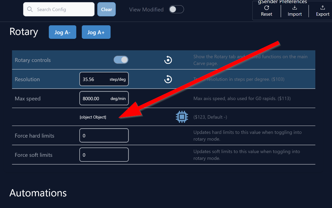

When switching back from Rotary mode to normal mode, the Y Axis resolution and rate is reset back to some arbitrary value. I saw another post from a year back saying there were plans for a default value to set it back to ( ) - this is missing from my UI, unsure if this was ever implemented
This may be the result of the update in the previous point not working but there is a UI bug in the Rotary settings where I just get a [object Object] value on the screen:
I am therefore unable to use my Rotary axis at all in GSender
. not with the Y axis moving all the time and it is a pain resetting my Y Motor values every time I switch back to non-rotary mode, if I forget my next job is shrunk to quarter of the Y size (as it resets the resolution to 200 instead of 800).

I see one thing in your screencap that is not the cause of your problem, but will cause other issues down the road. You have $103 set to 35.56. According to the user manual for your rotary, that value should be 177.777.

Thanks gwilki, thanks for pointing that out, you are correct, the value is incorrect, however my value is slightly different as I have a non Genmitsu 4th axis chuck
. I did all the calculations and now have it perfectly dialed in, rotating the correct amount of degrees in Universal GCode Sender (actually the correct value for me $103 is 71.11)

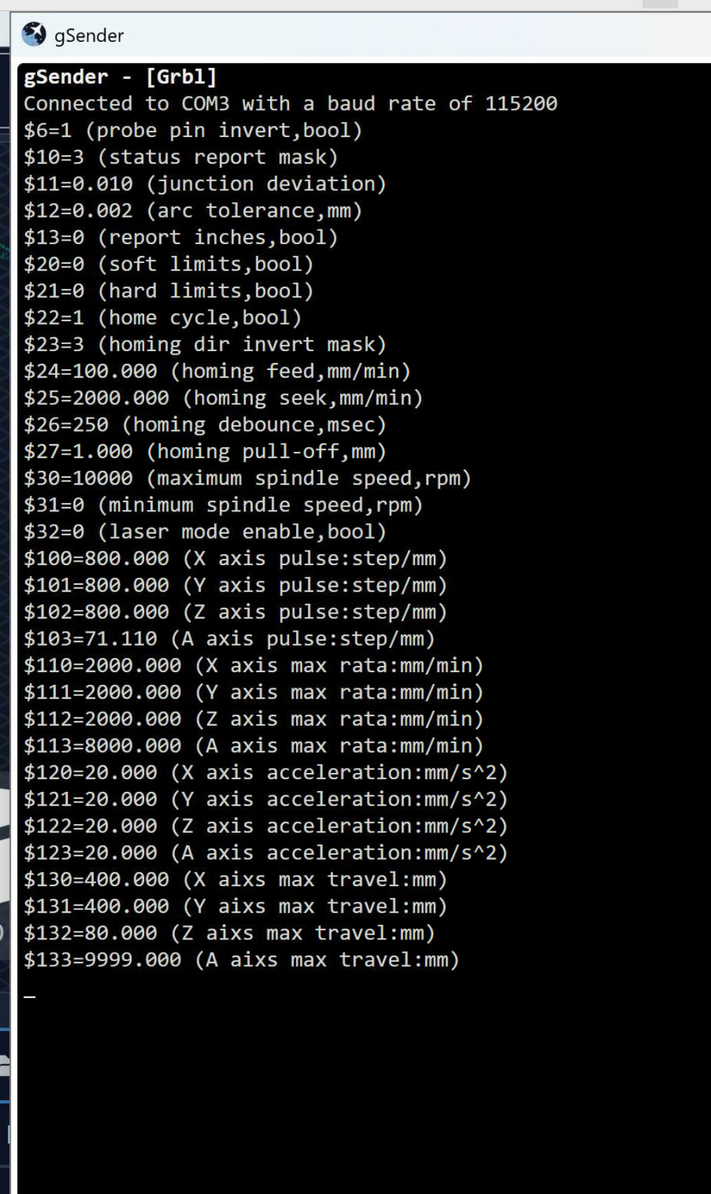

We could definitely fix the auto-connect issue here and that seems like it would resolve these issues :+1: the only information we’d need is if either @CplMulder or @SOHR you could copy from the console or send a screenshot of the initial connection lines for your controller in this thread - then we could modify the auto-connect to look for those lines and consider them as grblHAL instead of grbl. For example:

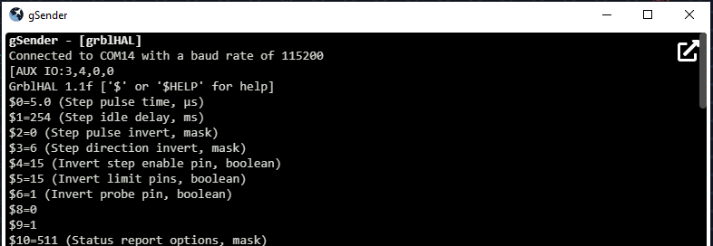

Hello Chris,
In recent tests, I’ve discovered that while I can establish a grblHAL connection in version 1.4.12, when I start a normal 3-axis machining operation with grblHAL, it is regularly interrupted at each milling line, and I have to manually restart the process.
It’s also worth noting that the $$ command in the console is not possible with grblHAL.
Currently, I’m working with version 1.5.6 in “grbl” mode for normal 3-axis machining, and it works perfectly.
For 4-axis machining, I had to switch to ugs-sender.
I have made 2 videos and uploaded it to my google drive.
One of it it will be show the connection with 1.4.12 and in the other one 1.5.6
Also .txt with concsole info.
Here is the link:
When it is connected to grblHAL in vers.1.4.12 all axis works,
$$ in console don’t work.
When i start a normal 3-axis machining operation with grblHAL, it is regularly interrupted at each milling line, and I have to manually restart the process.
Hope it will be helpful.
Let me know if you need anything else.

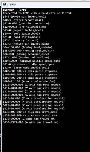

Mine is as follows :
Or in text format :

Thanks Kindly Chris
Hmm, I’m not sure why bu I’m not seeing you’re controller initializing text at the top like I’d expect, that’s odd.
