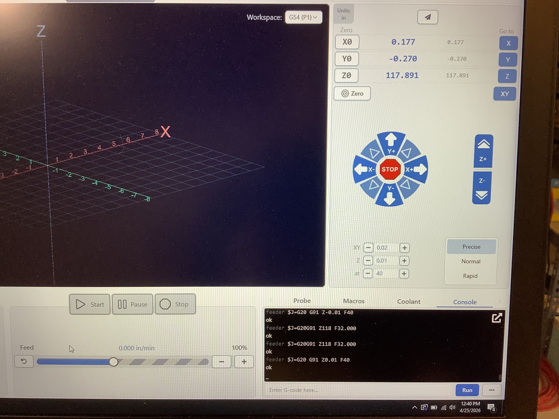

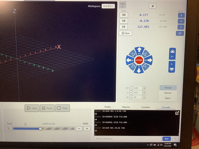

OK, here’s something I noticed. I was performing some precise single jogs in both the positive Z and negative Z. Then the runaway occurred. I am attaching a picture to show the last few commands in the console. Somehow a positive Z 118 was executed. I’m not sure where that came from but I looked further up the console and it showed up several other times as well. I let the Z axis continue to go in G Center after I hit the E stop on my machine. As you can see in the pic it finally stopped at about approximately 118 in the Z positive.

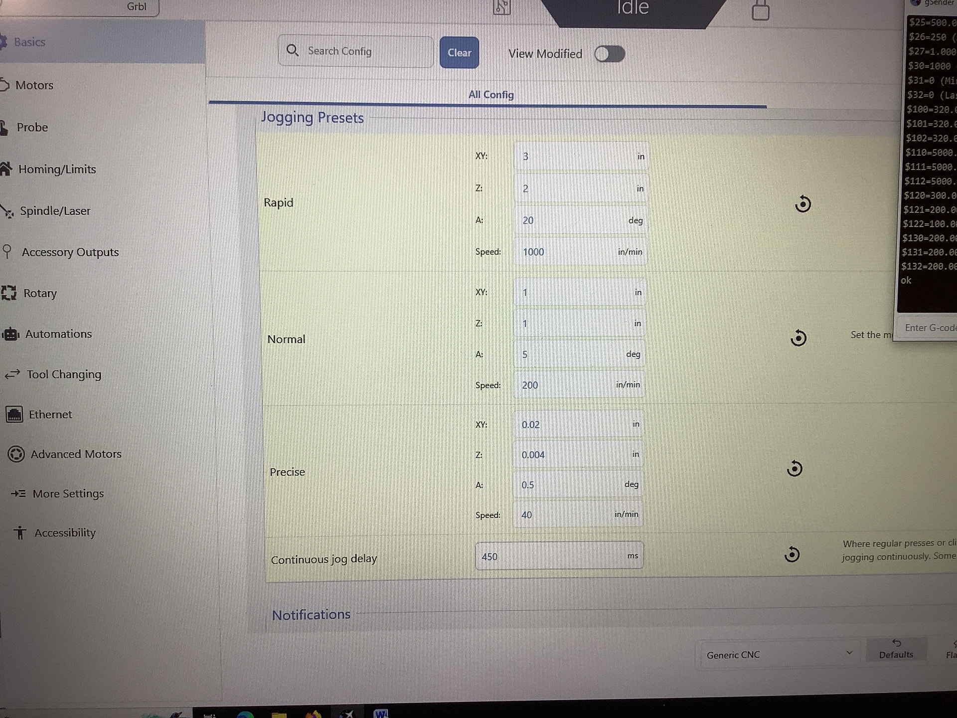

I figured out where the Z118 command is coming from. That is the command I get every time I hold the mouse down longer than the delay time I have in my settings(currently set at 450ms). Of course we know this action produces a continuous jog for sure, however, it doesn’t know to shut itself off when I release the mouse. Also, I’m trying to understand why it’s always 118 inches?

I have not been able to get repeatability in any definitive way; however, I have found a way to make it happen with a fair amount of consistency. It involves varying the dwell between consecutive jog clicks. The mouse must be held down between clicks. Then slowly increasing the time. In other words, I hold the mouse down 1 sec. between 1st and 2nd click, 2 sec. between 2nd and 3rd, and so on. In this way, you are slowly reaching the point to where it will consider the action to be a constant jog command. My setting for constant jog is 450 ms delay.
It seems like there’s a point at which I approach the 450ms that it gets confused, and that’s when it happens. Anyways, I can get the most repeatability doing this.
