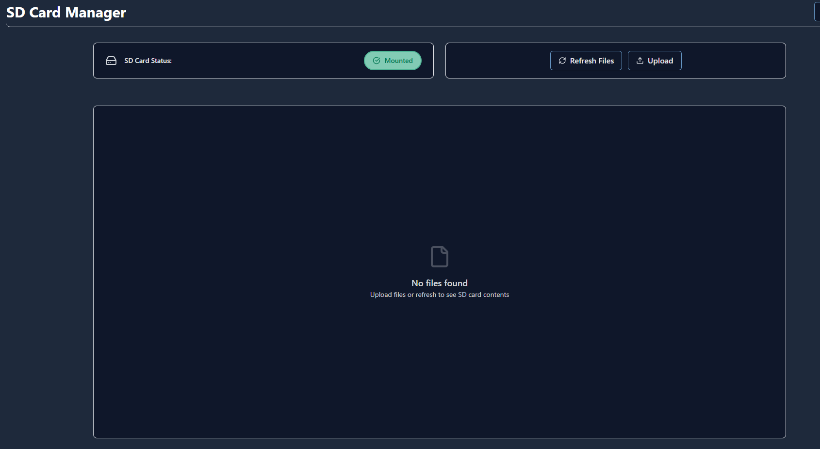

If I open tools and the SD Manager the card shows as MOUNTED. No files are listed. I try to load a file and follow the prompts but nothing really seems to happen. If I click REFRESH the ERROR 60 shows in the console and the SLB disconnects instantly. The only way to reconnect is to hard reboot the controller. At this point I have no idea what to try next. Any help would be most appreciated.

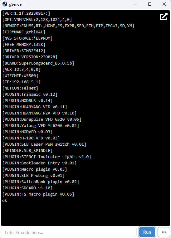

As far as I know I have flashed with the correct firmware. The file I downloaded was SLB_5.0.5b_NGC.hex. At the end of the flashing process it shows Successful. $i shows BOARD:superlongboard-B.05.5b, but I can’t find any reference to know if that is correct.

It appears the issue I am having relates to the Tools>SD card manager (v1.6.1) Whenever I do anything in the tool it throws the 60 error and shuts down the SLB. I find if I avoid the tool and only use the console it then reads the card and shows all the contained macros. Not sure about stability yet so I need to test further but I shall mark it as solved. Thanks for the guidance so far, it helped enormously.
