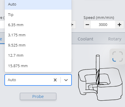

This might be somewhat unclear but I do not (at this point) want to get into the hairy details. My question is in regard to the auto probe. In the gSender settings you select which probing system you use. That is currently set to ‘auto zero touchplate’. On the right side of that setup screen is a listing of tools and you can even add additional tools.
What is the point of those settings? They appear to be non-selectable but there must be a reason why they are there.
In my probing to set up for the second side operations I have never selected a particular tool. Since the macro that runs measures both sides of the autoprobe block for both x and y. I assumed that it would just calculate the middle point which would seem to indicate that diameter of the endmill is irrelevant. I suspect that I have a basic misunderstanding here somewhere because there are tools listed and I am not using these listed tools anywhere in my procedure.

I still would like to know why there are tools listed in the probe setup screen.
They populate the quick select for probe operations. There’s longterm plans to incorporate the tool library in other ways but that’s down the road.
Thanks KGN, can you elaborate on the ‘probe operations’ please? Under what circumstances would I need to select a tool?
The bit diameter (well, actually the radius from the bit diameter) is used when touching off X and Y for XYZ probing.
I am sorry to be dense but I am doing x/y probing with the auto probe and gSender does not allow me to select a tool. I do not understand the need since gSender can determine bit diameter when it touches off the auto probe block. Am I missing something?
You’re missing the fact that
a) Not everyone has an auto Zero touch plate where it calculates the bit diameter for you.
b) You can still use a specific bit diameter when using the Auto Zero probe which removes two of the touches for a quicker probe cycle. This lets you use the Auto zero block like a more traditional touch plate.
Ahhhhh … I figured it out with the help of your picture. I had not noticed the quick select field in the probe operations when the mill was connected.
