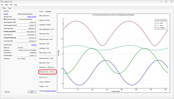

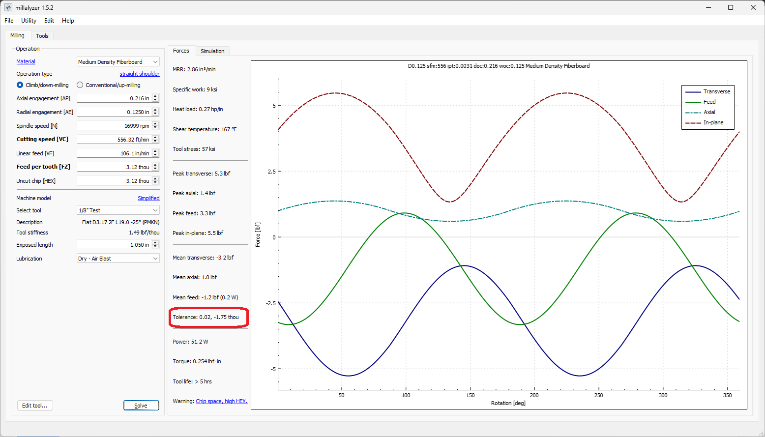

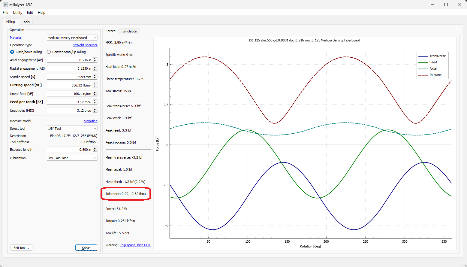

Until deflection gets really out of control it will look like a good cut. The amount you are talking about here won’t be obvious. It’s also not really an aggressive cut. That’s about 1.5x the rule of thumb number for a minimum. Plunging in the ramp also gets rid of the most obvious sign of deflection (depending on the cut direction).
As an example here’s what that looks like in millalyzer assuming a 0.50"/12.7mm length of cut, generic geometry, and a normal stickout.
This wouldn’t result in the error you are seeing.

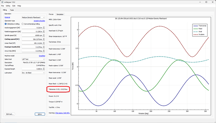

If this is a ā€œlongā€ cutting length tool (0.75"/19.05mm) it would look something like this.
That’s about 3x.
You are doubling the error as it goes in both directions and true deflection numbers depend on the stickout, carbide grade, flute depth (core), runout, etc. That said though, unless it’s a much more whippy tool than this it’s unlikely the issue in a 0.010"/0.25mm small hole. Even in this ā€œlong toolā€ example you only get about half way there with this plus the assumed correct tool measurement.

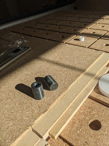

I print them exactly the way you think, upright (but upside-down). I have an ever so slight taper on one side (for easier insertion) and when I print the dog it is with the flat side down to get a better/cleaner taper. It also eliminates any issues of elephant foot.
There are a couple of gotcha’s I have encountered. I first printed things in PETG (my default material) which can move/distort more than PLA. I first printed the dog with a fairly thick outer wall (probably 3 mm) but found that if you get carried away with clamping forces of your stock from the side, the dog will deform. In most cases this is not an issue but for those occasions that require more precision (double sided work where the dogs are used for precisely locating the work piece)) I print the dog mostly solid. I have a section up on the top that still has the wall with the hole in the middle which I can grab with pliers to pull the dog.
I have never run into a dog shearing and should it break off, it is relatively easy/quick to mill the dog out (don’t try milling it out completely - leave a thin wall so you don’t screw up the dog hole)
Can you post a picture of one of your dogs? The one thing I’ve done was mill my board as rings, not holes for the PVC, I think if I 3d printed, they’d need to be solidish. If you’re not using PETG what are you using now? I tend to use ASA for heavier things, but I wonder if TPU would workbetter
