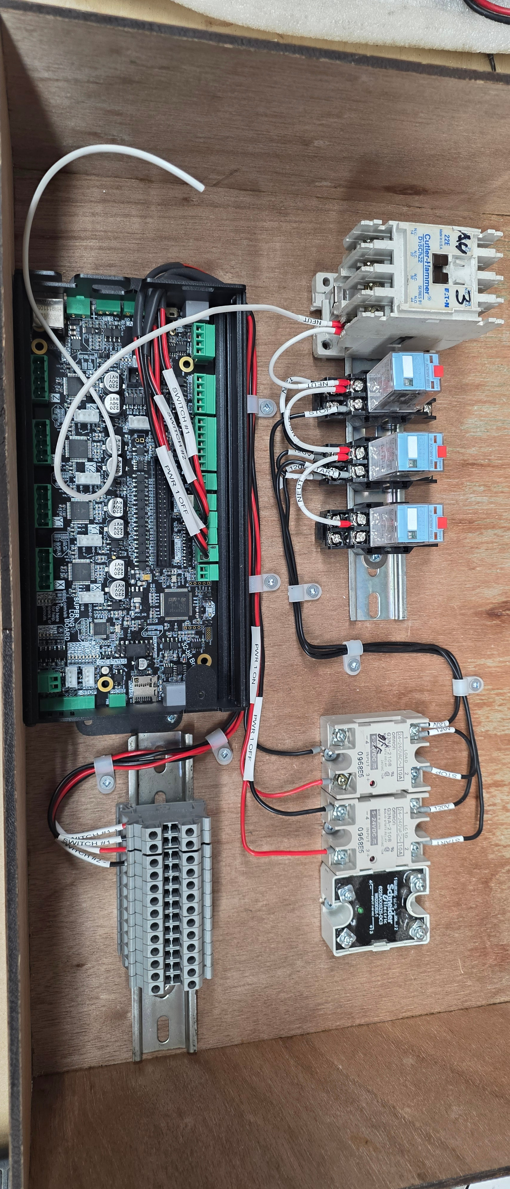

Ok so i have kind of a long story.
my slb will continue to turn off the flood controle in the middle of a job; that inturn turns off my dust colection and router.
as you can imagine this usualy results in some choice word and a briken bit and wrecked wood.
some of the things i have tried :
I have grounded the entire machine including the router X and both Y axis the dust colector including wrapping the hoses in copper I replaced the ssr and used shielded beldin to wire to them
this seemed like it worked for a while but then as we got in to winter the problem started coming back
I am convinced thet it is static from my dust colection
so this is my next try i am wiring the solid state relaysto turn on convetional relays wired as a holding contact so once it is turned on it stays on until it turns on the stop relay to kill the circut
i will then use the M 64 P2 | G4 P0.5| M65 P2 for the start
and M64 P3 | G4 P 0.5| M 65 P3 to stop once the program is compleat
the other problem i have is any time i use a button on the Estop or press the e stop it disconects the longboard from g sender and i have to cycle power to get it to reconect havent figured a work around for this one yet might try ordering a new pendant
This is the start of the rewire of the relays
Any help or sugestions would be greatly appreciated

Just a random thought about this, I wonder if using a rubber interconnect between the Dust Collection Hose and the Spindle dust collection point would eliminate any static reaching the cnc machine?
”Rubber, a versatile and widely used material, plays a crucial role in mitigating static electricity, especially in environments sensitive to electronic components.”
  • Frozen Ground: Frozen soil has significantly higher resistivity (10-50 thousand ohm * m) than moist, unfrozen soil, reducing the efficiency of electrical grounding.
  • Insulation: Snow and ice act as insulators, hindering direct contact with the earth’s electrons.
  • Static Electricity Increase: The dry air in winter, caused by low humidity and indoor heating, allows for greater buildup of static charge on surfaces.
With that being said, how about a deeper ground copper stake. Also I wasn’t sure if you are asking about the accuracy of your wiring set up or something else. If you are concerned about that then do you have a schematic and a part numbers for your relays. Sometimes with an output you can see a square wave with a high Hertz which some relays have trouble reacting to. Nice control set up though.
