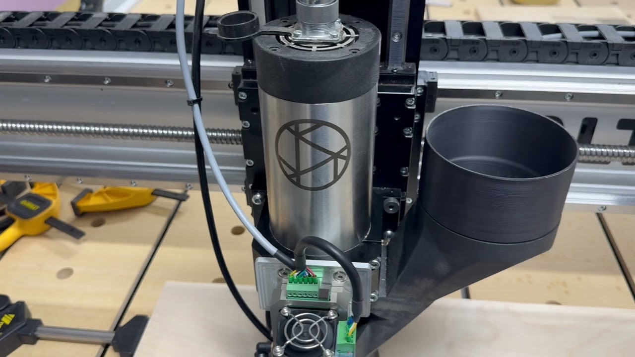

Thanks for the quick reply. Best guess is the Z axis assembly. Could be the ball screw above the assembly.

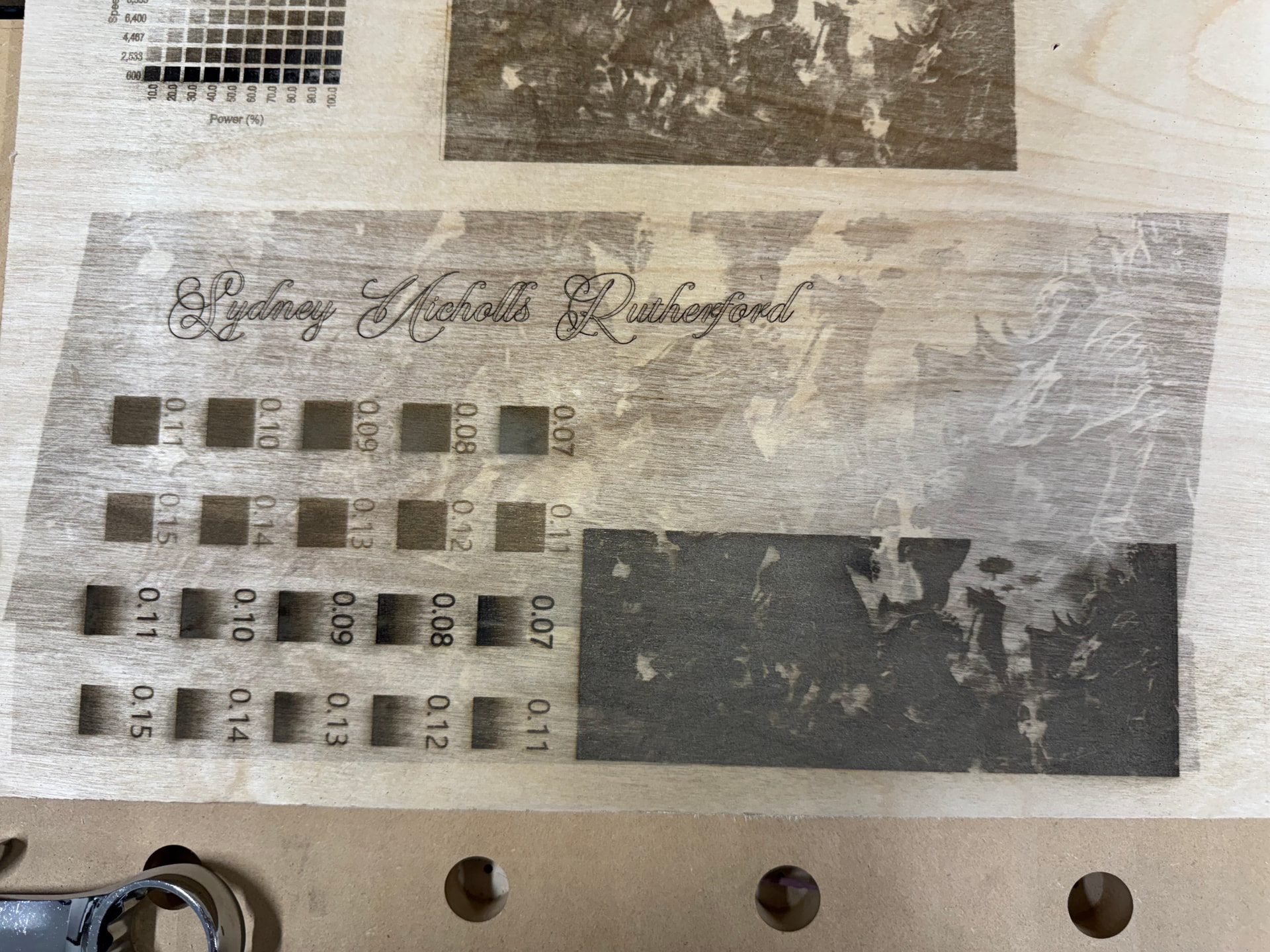

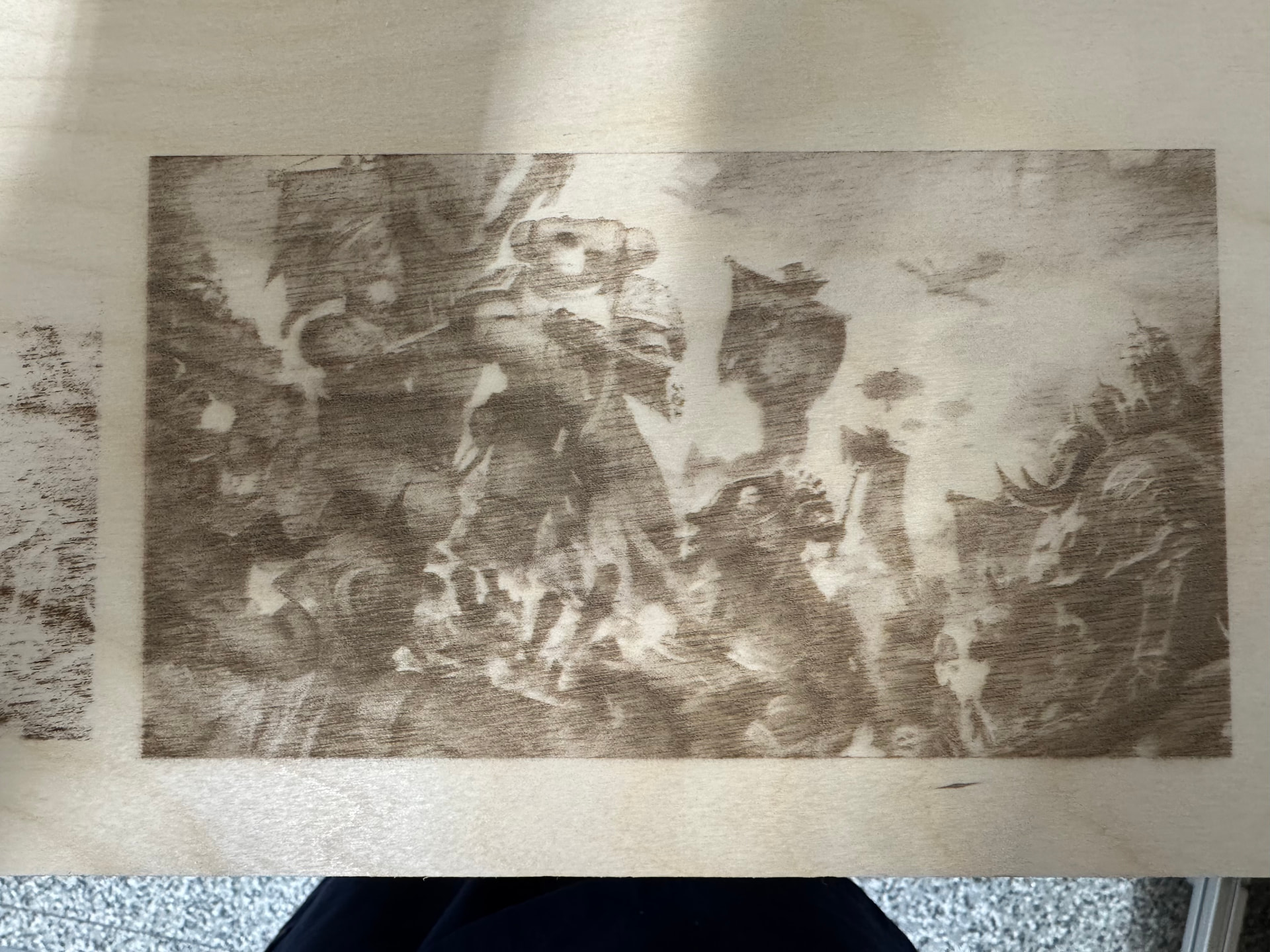

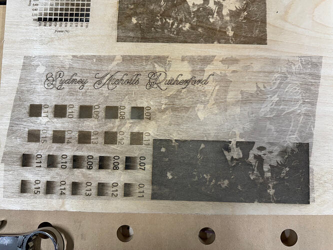

Here is the worst example of the drifting. There is a lot of testing going on here but the faded picture at the bottom which is badly drifting to the right is the worst example. I believe this was 15,000 mm/m.

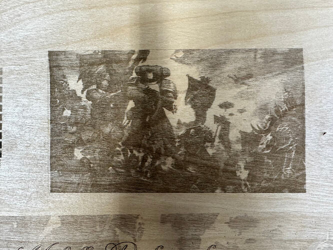

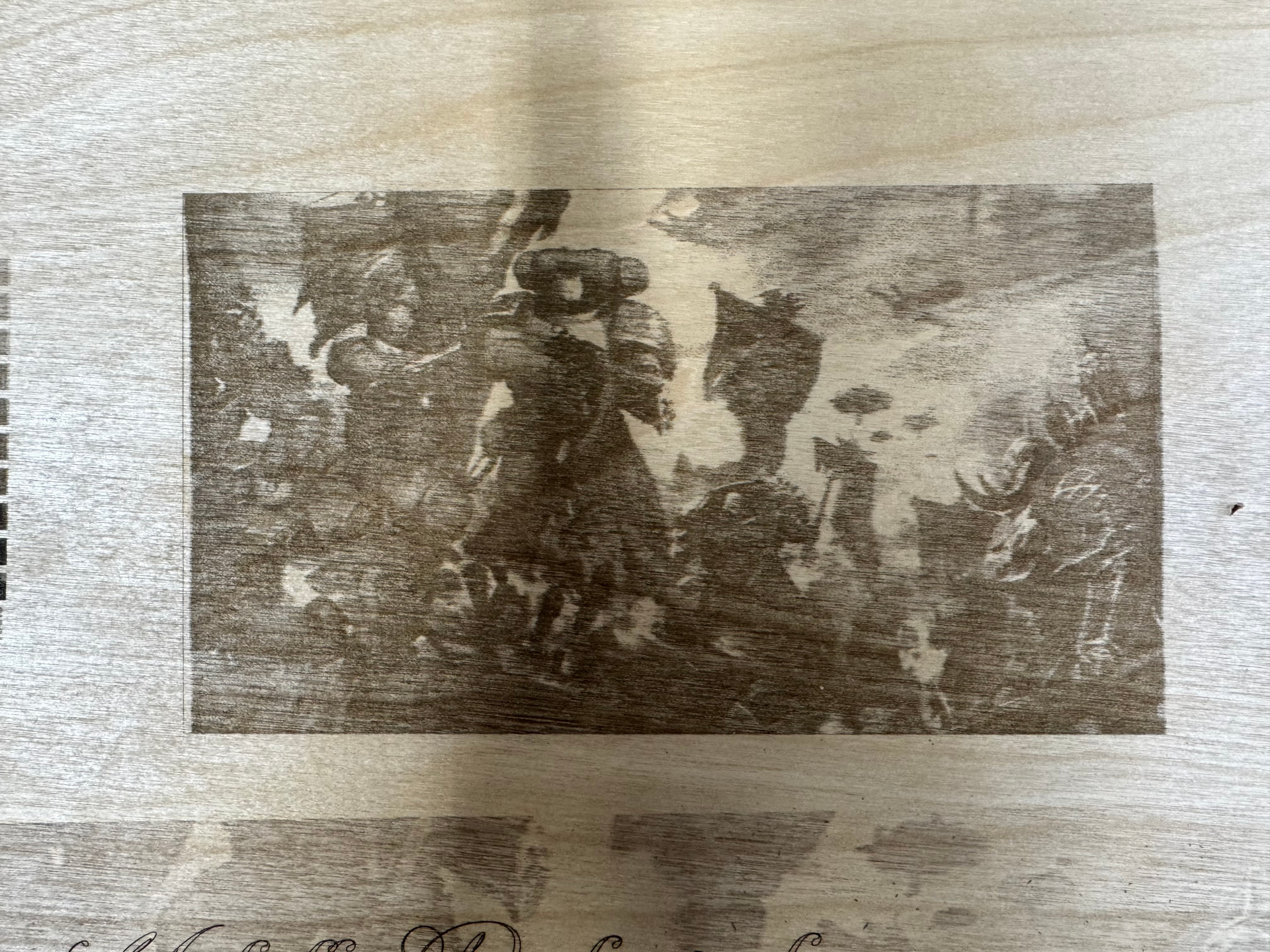

This one you see much more subtle drifting at the top. Doesn’t really distort the overall picture. Think this was like 5,000 mm/m.
This one I think is perfect at 3,000 mm/m.
