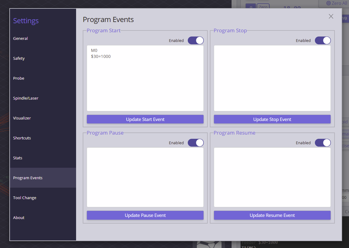

So now I wonder, if at start event you just send $30=1000.
Would that work around the problem untill this gets fixed by sientists? or am I being simplistic again. :face_savoring_food:

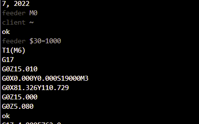

I tried your suggestion and added a start event as $30=450 in 1.5.2. I chose this value only so that it would stand out in the console screen. I’m not sure exactly what happened. I started a file. There was no movement shown in the visualizer. I stopped the file and entered $$ in console. $30 did show 450. However, as I did this on my test machine, I have no idea if the job was actually running. As I said, nothing was moving in the visualizer.
If it were me, until this is addressed by Sienci, I would go the macro route that @DavidS has gone. In fact, that is what is used do until I realized that, when using the Makita router, I could simply leave $30=1000 and $32=1 all the time. That way, David can change the settings and ensure they are, in fact, changed before he runs the job. Using the start and stop events only works after the job is started. If it went wrong, it’s too late to fix it.
