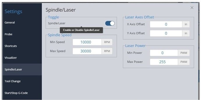

Hey Joe,
The first time I tried my laser it wouldn’t fire either. My mistake was that I flipped the toggle at spindle/laser to laser in gsender settings and thought I was done.
That would have worked if it was a selection toggle. It isn’t. It only activates the spindle/laser tab that is defaulted at spindle use. To use tha laser I had to hit the tab toggle to laser at the activated section.
After that, the laser was active. But.. this was on a longmill, with a lb and no spindle.
I bet you have this covered and your problem is different. Then again, you never know how a cow catches a hare, ey?
Anyhooo, here’s the section on laser settings for gsender. It might contain information overlooked.

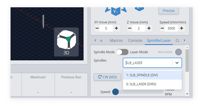

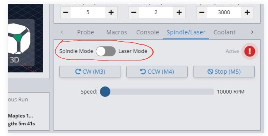

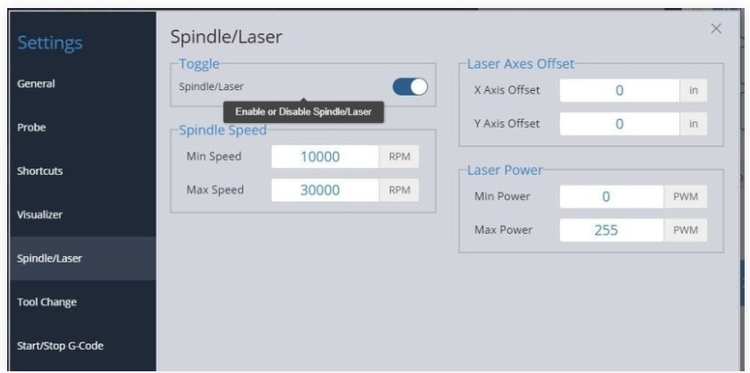

@thankjun Unfortunately, the screencap that @Spamming_Eddie posted does not apply to your controller. Here is the correct screencap from gSender.
You will note that you have two items to change/select. There is a spindle mode/laser mode slider and a spindle/laser dropdown.
For the laser to fire properly, you need to select laser in the dropdown BEFORE sliding the slider to laser mode.
When you want to change back to spindle, you select spindle from the dropdown BEFORE sliding the slider to spindle mode.
