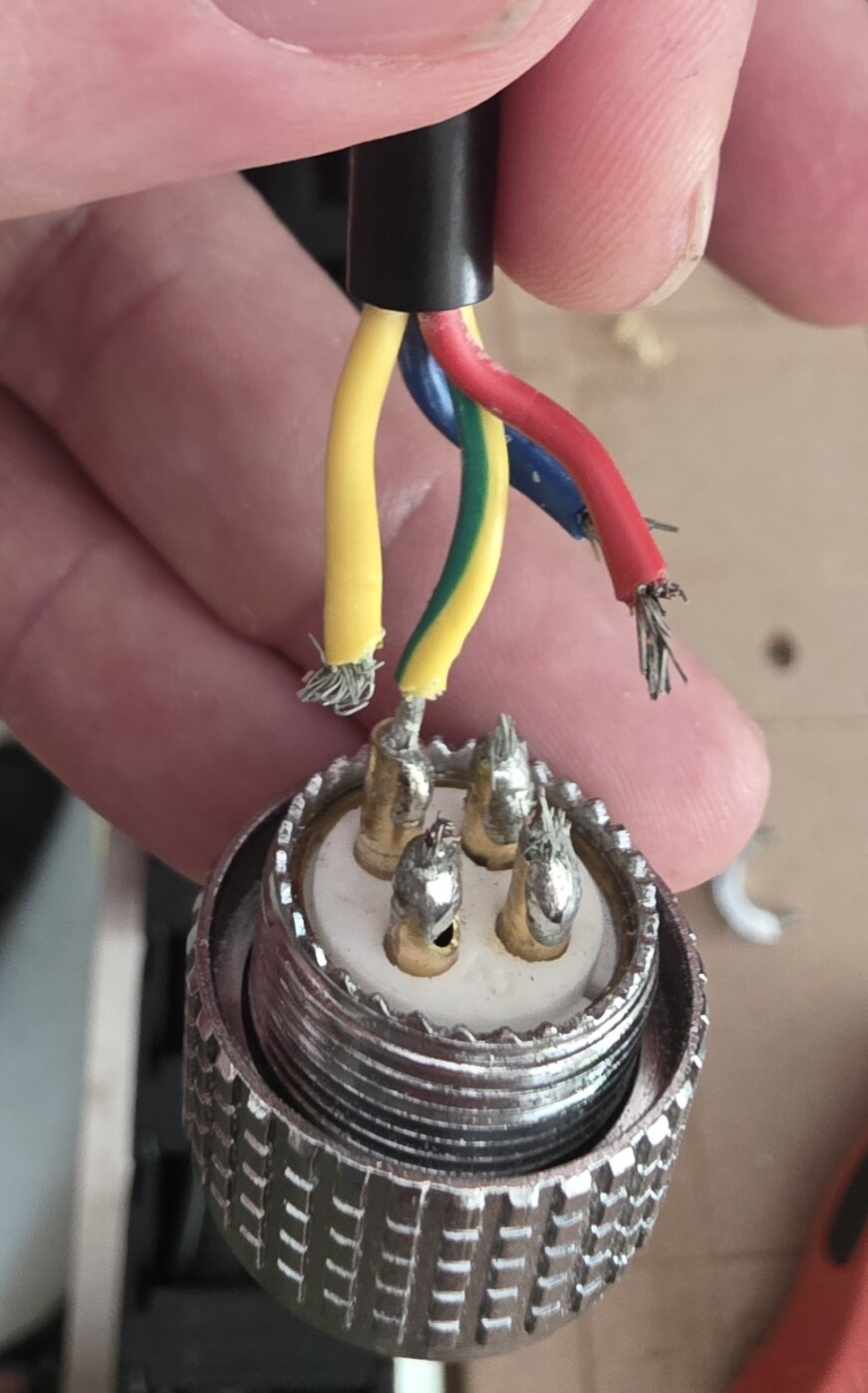

The motor cable got hang up and when I came down in the Z Axis, it ripped out 3 of the 4 wires.
Does anyone know what pins I need to solder them back too?

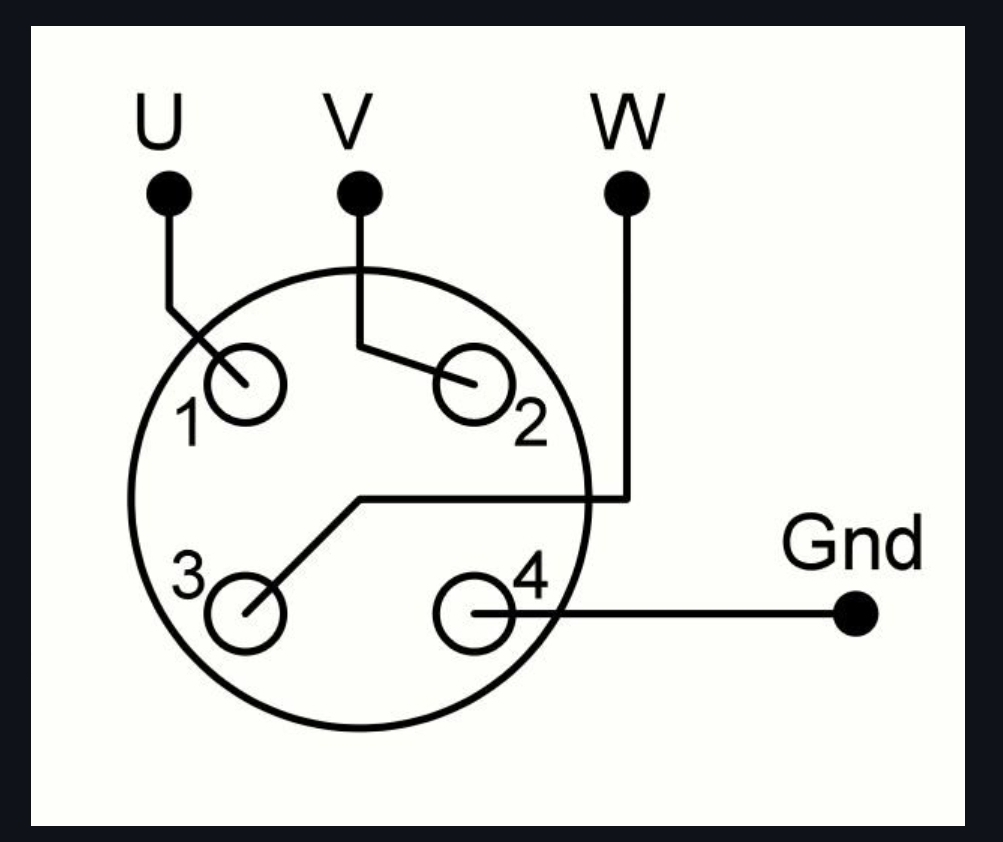

As far as I can see, the gnd is at pin 4
The other wires are found at the U V and W possition.

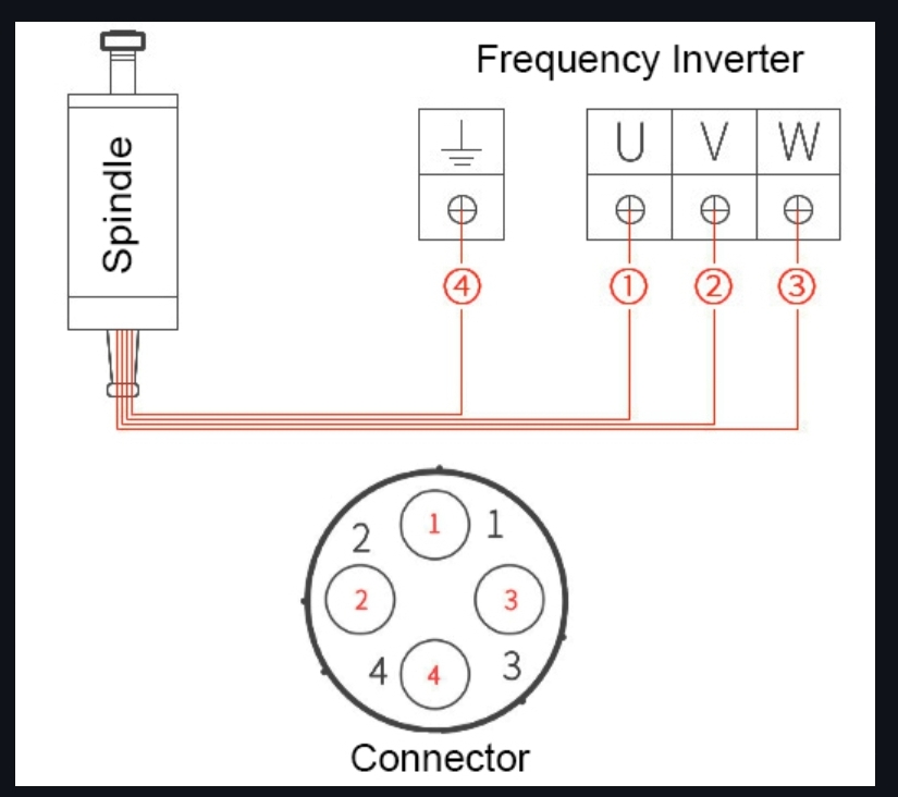

(Screenshot came from this sienci manual page)
I have looked at some different brands and most (concerning word here) are wired like below.
U=1
V=2
W=3
Gnd=4
So, if you can confirm your ground is at pin 4, I’m pretty sure you can figure out what color goes where looking at what wire is the U, V, W in your VFD.

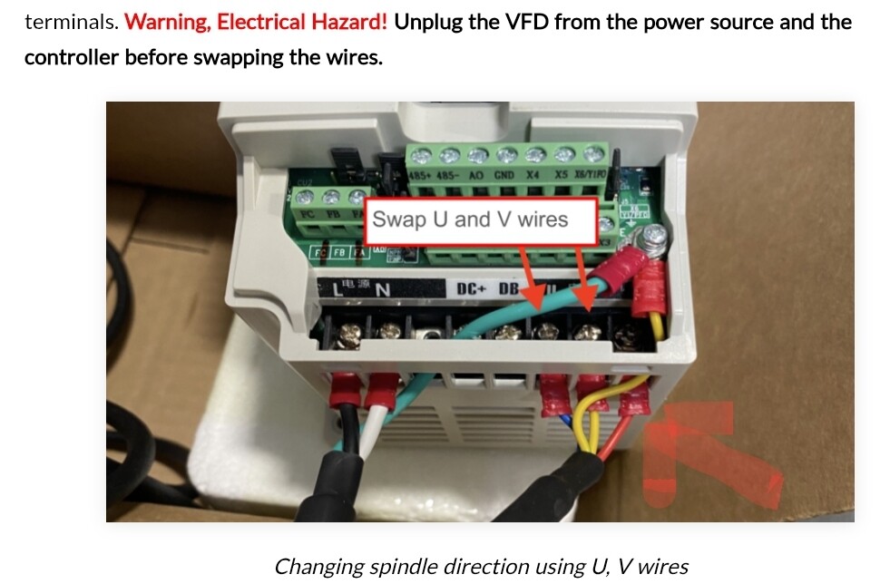

Oh the yellow/green is the gnd wire for sure. So if its on 4 uvw go on 123

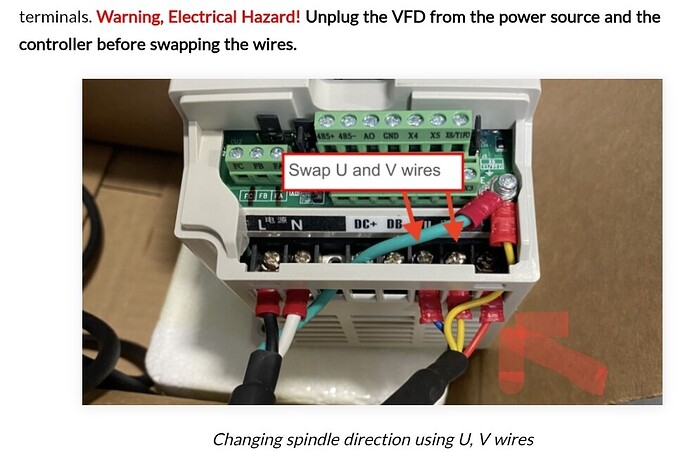

Just make sure you look at what color goes with what letter at the vfd.
(If you get uv mixed, the spindle will run backwards.)

Just checked, it is on 4. So I’m feeling 99% now.
I’ll take a picture before I put it back together. That way WHEN “gulp” it works maybe it’ll help someone else.

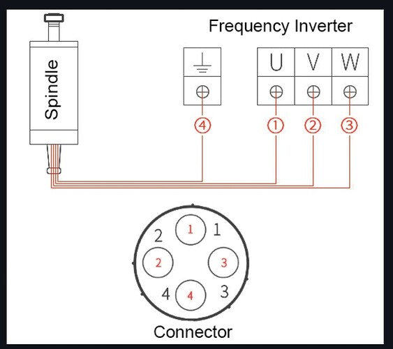

I can’t give 100% certain advice since all spindle are different, but I wrote this as a general guide

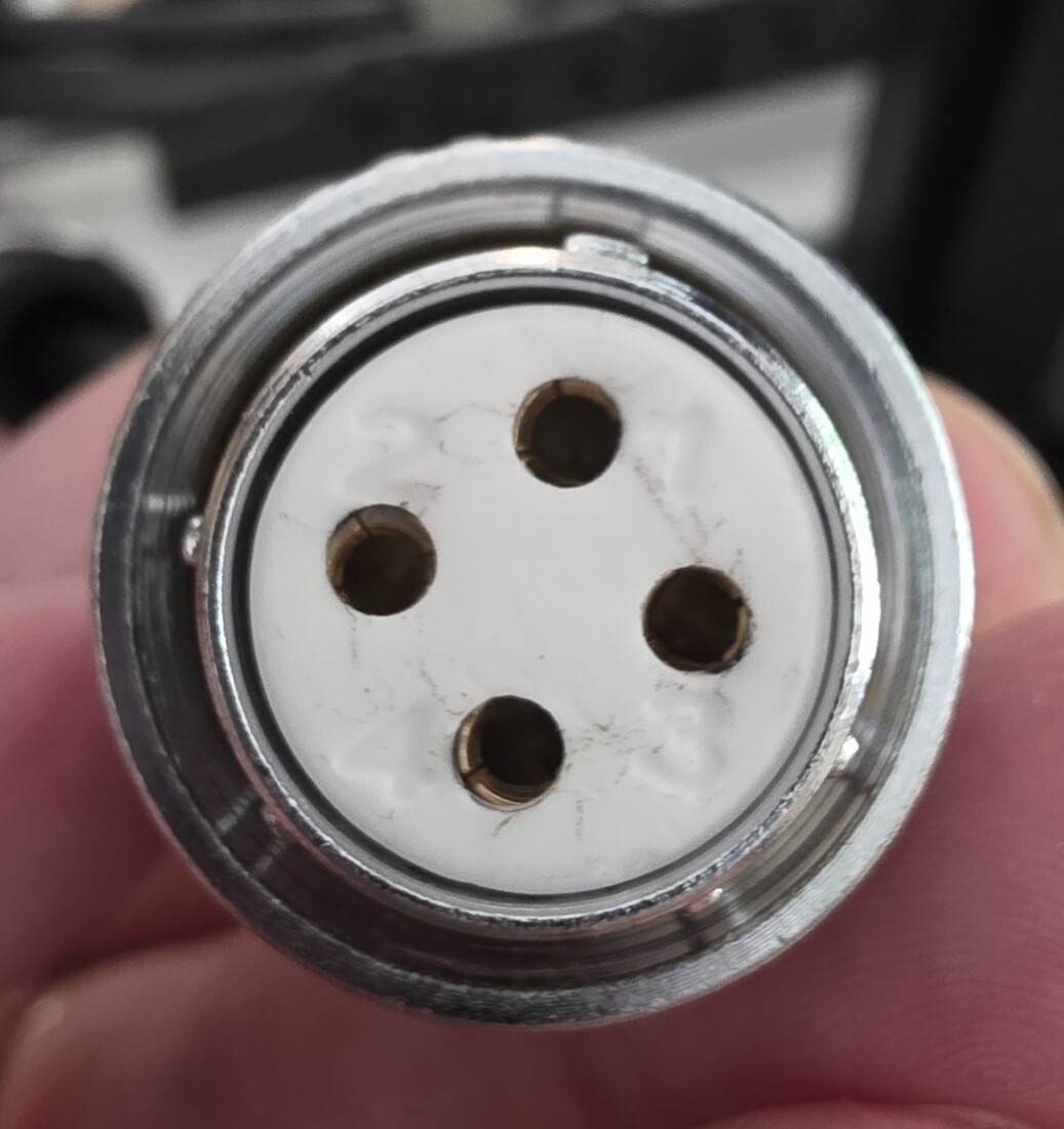

The Beast is up and running. I can confirm the wiring for mine is as follows.
  1. Yellow
  2. Blue
  3. Red (Power)
  4. Yellow Green (Ground)
If your spindle spins in reverse. Just swap your blue and yellow wire or the U & V positions
