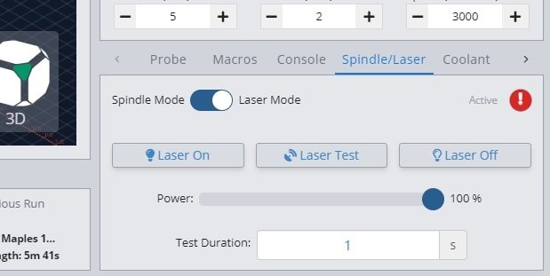

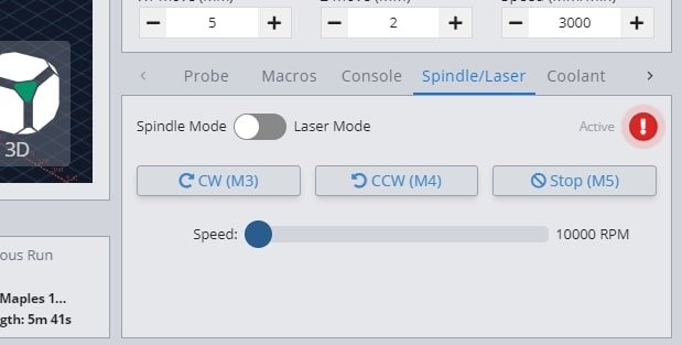

My mind wondered if you maybe selected laser in stead of spindle at the spindle/laser toggle. You mention not being able to change from 100% and on my old gsender I only get % selection when my laser is active. (Toggle = blue)
When spindle is active you get rpm (toggle is grey)
Found here:
If that isn’t it, maybe you can download the edge version. You can run that one instead of your 1.4.11 to see if the problem remains the same.
Thanks, it’s definitely set to Spindle mode.
