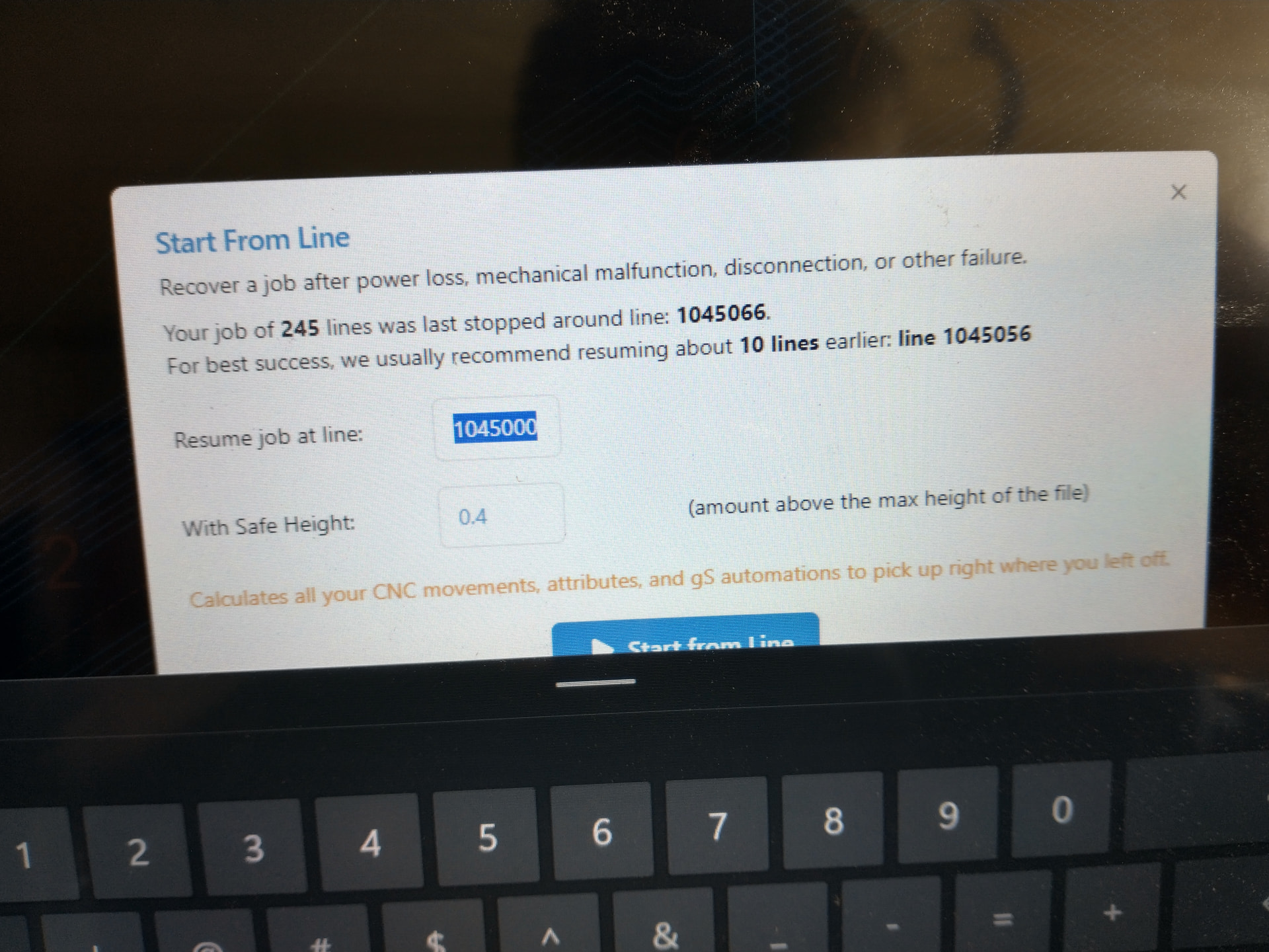

Start From Line dialog box contains misleading information
The Start From Line dialog box shows the line at which the last job finished. If you load a new job and use the Start From Line option, it gives you the amount of lines in the new job but the lines stop count of the previous job.
Now, I realize that if you use this option, it’s likely for the same job. I only noticed when troubleshooting something else.
While on the subject, if the DEV team is reading this, where is the Safe Height value in this dialog box obtained from? It’s not in the gSender settings nor in the g-code.
I’ll take a stab at that question with some WAG.
Now that scanning the file for errors is working in gSender again I’m guessing that the file is scanned to determine the ā€œmax height of the fileā€. That would be the same scan that provides the dimensions of the carve. Then whatever you put in the safe height is added to the max height. Whatever you set it to, if it survives restarting gSender, is most likely saved in .sender_rc or in the config folder.
The default of 0.4 is probably hard coded in gSender and used to create the config file on new installs. A further guess is they chose 0.4 to be just high enough to not hit the carve but they can’t add too much to what the file uses without risking running out of Z.
It doesn’t need to be in gSender config section IMHO because it’s always shown right before it’s used.
All supposition on my part but maybe I’ll get a brownie if I’m right!
@_Michael Agreed that its likely hard-coded. What was throwing me off is that it was 0.4 for me but 10 for someone else. And my gSender is set to mm whereas the other user was set to inches. So our settings should have been the other way around ( me at 10 and him at 0.4).

This should be fixed in the next gSender release.
The safe height is hardcoded default - we’d maybe consider having it be the safe height (if configured) and use the default value otherwise.
