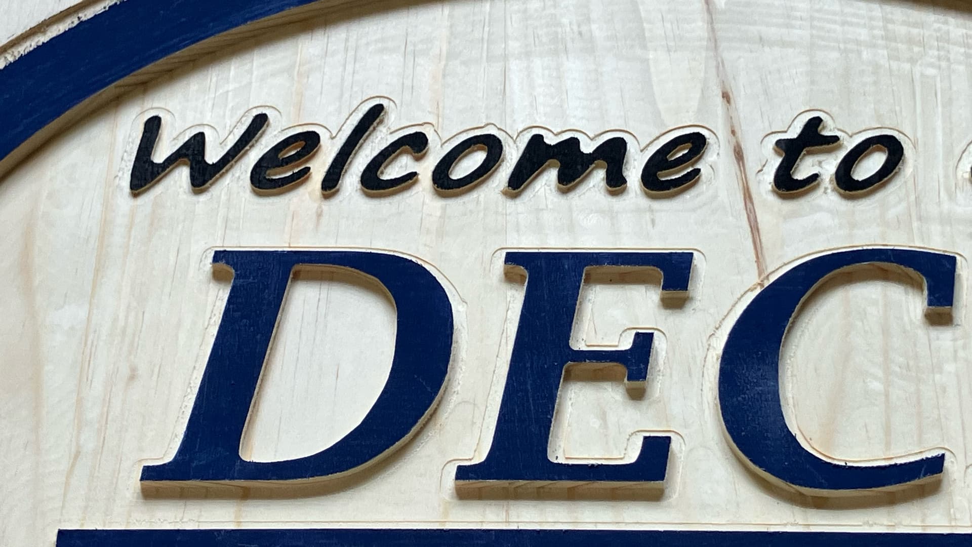

I seem to be getting two different z zero settings with the touch plate: the z zero for a 1/4” bit is about 0.2 mm off from that of a 1/8” bit.
The 1/8” bit uses an adapter for the collet. Could this affect the conductivity? Could the conductivity between 1/8” and 1/4” be enough to cause this ?
