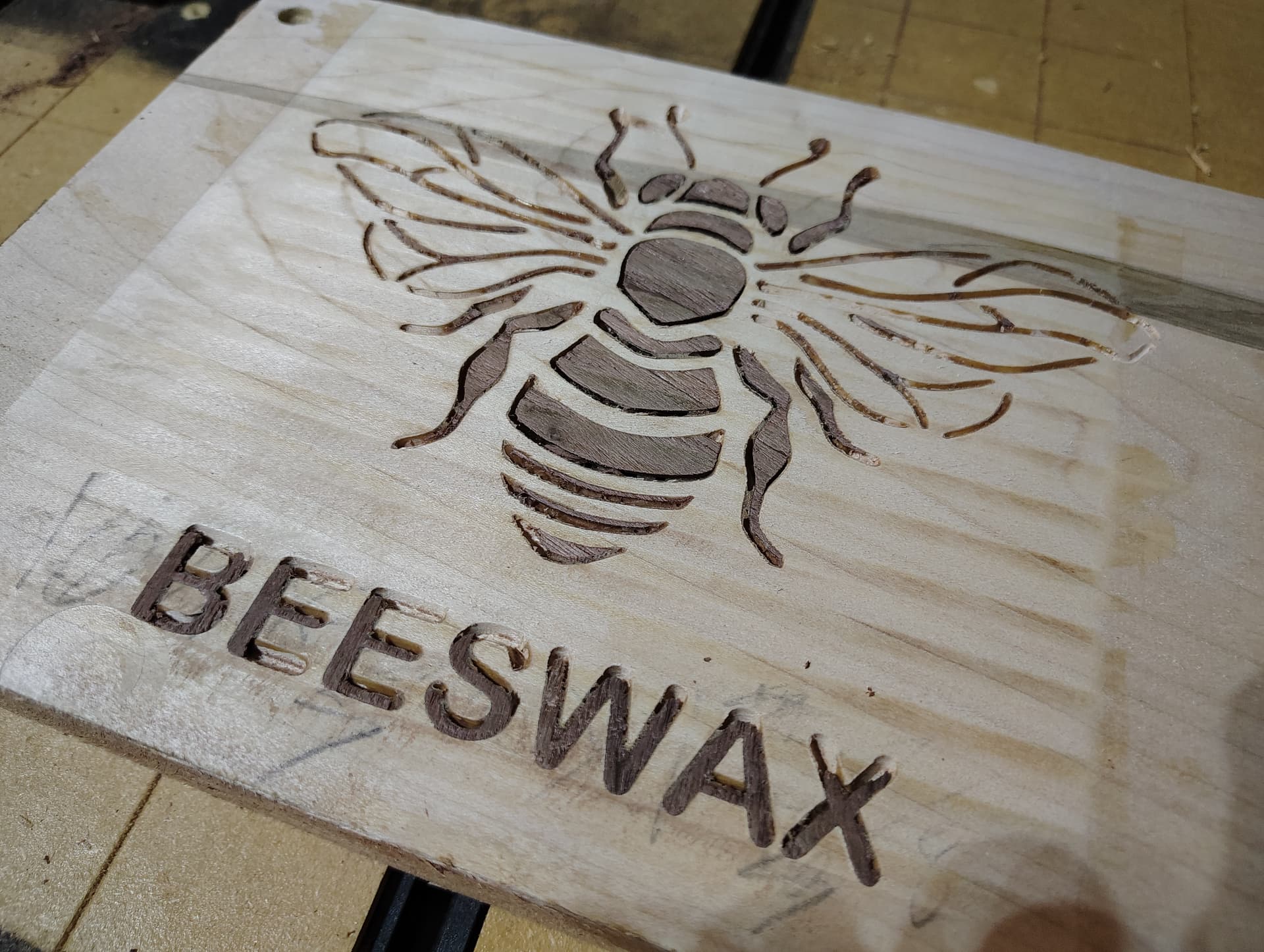

Still fairly new to the CNC world, trying to get some experience with creating inlays.
I’m unsure if this is something the forums are for, or if this is even the correct place in the forums. If not, just let me know.

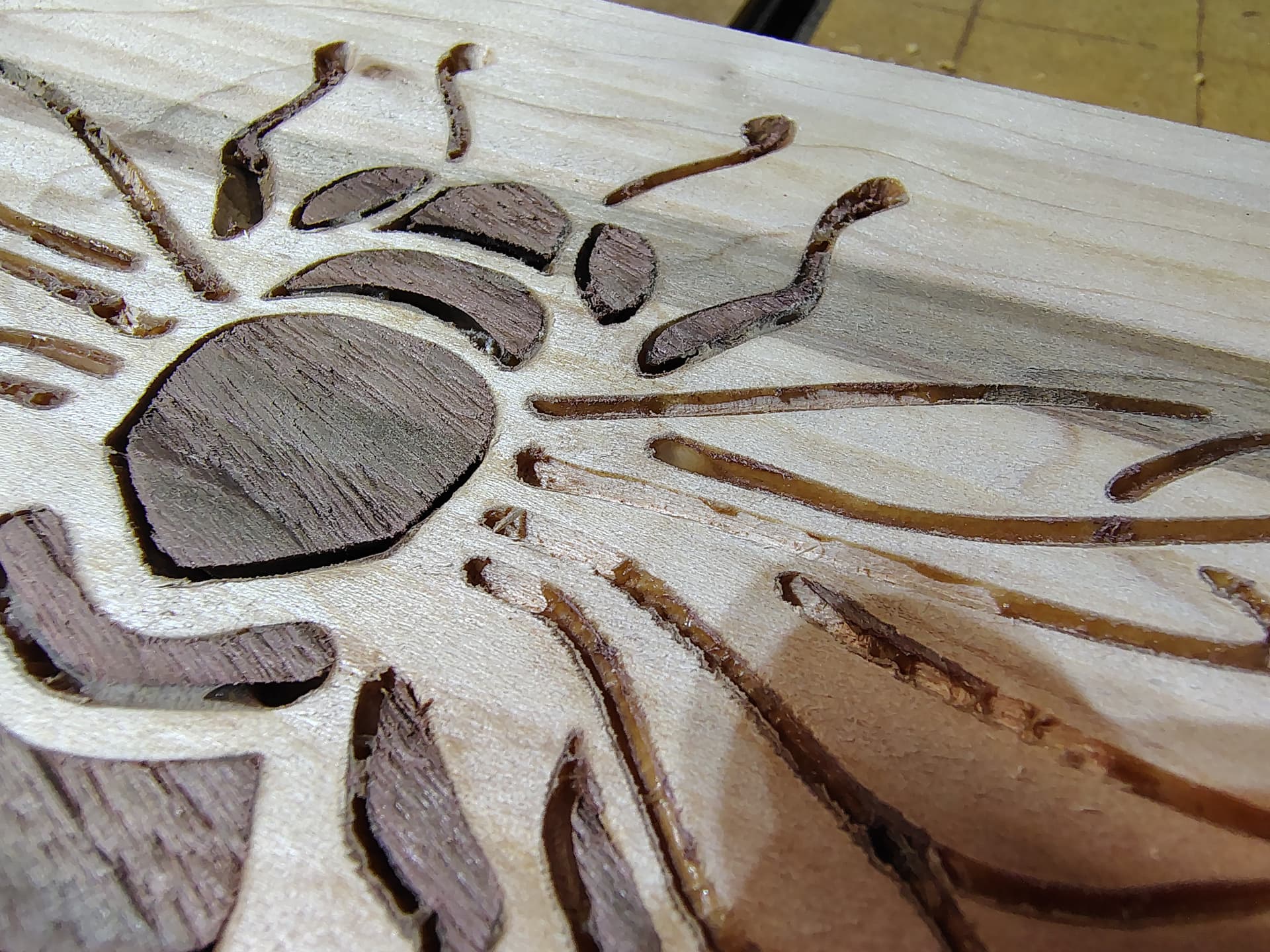

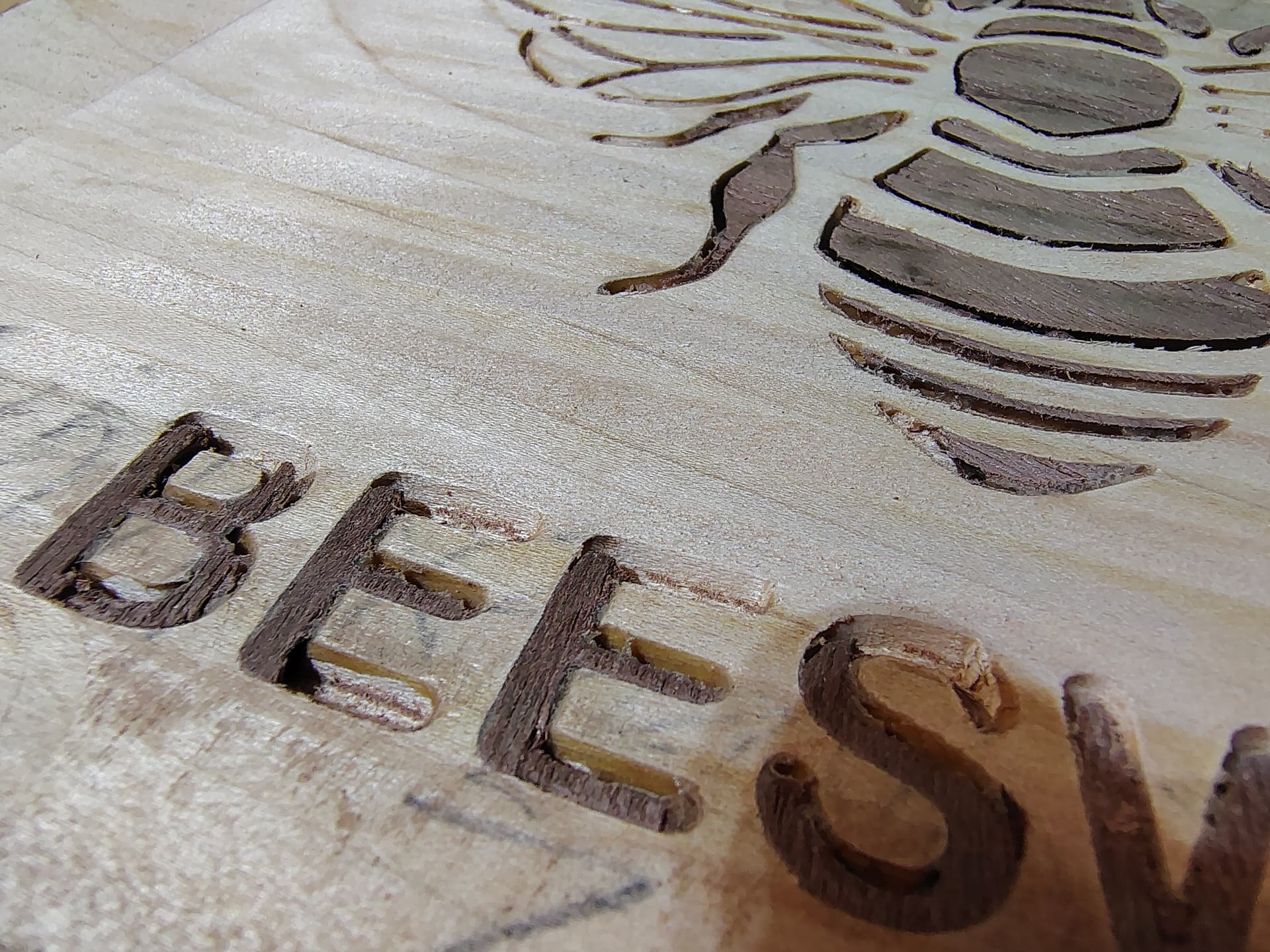

I’m having difficulty with inlays. Currently working on a cutting board for a friend, but have been testing my inlay skills on test pieces. The plugs aren’t “filling in” the pockets completely. So when the extra plug material is removed, there are areas where the plug is missing, & sometimes only glue is left. In other areas, there are gaps around the plugs. Also getting some chip out on the smaller/ finer details of the plug.
I’m unsure if I’m not applying enough clamping force, using the wrong bits for this job, not using the right feeds/ speeds for this job…
Here are the details of my last inlay job:
