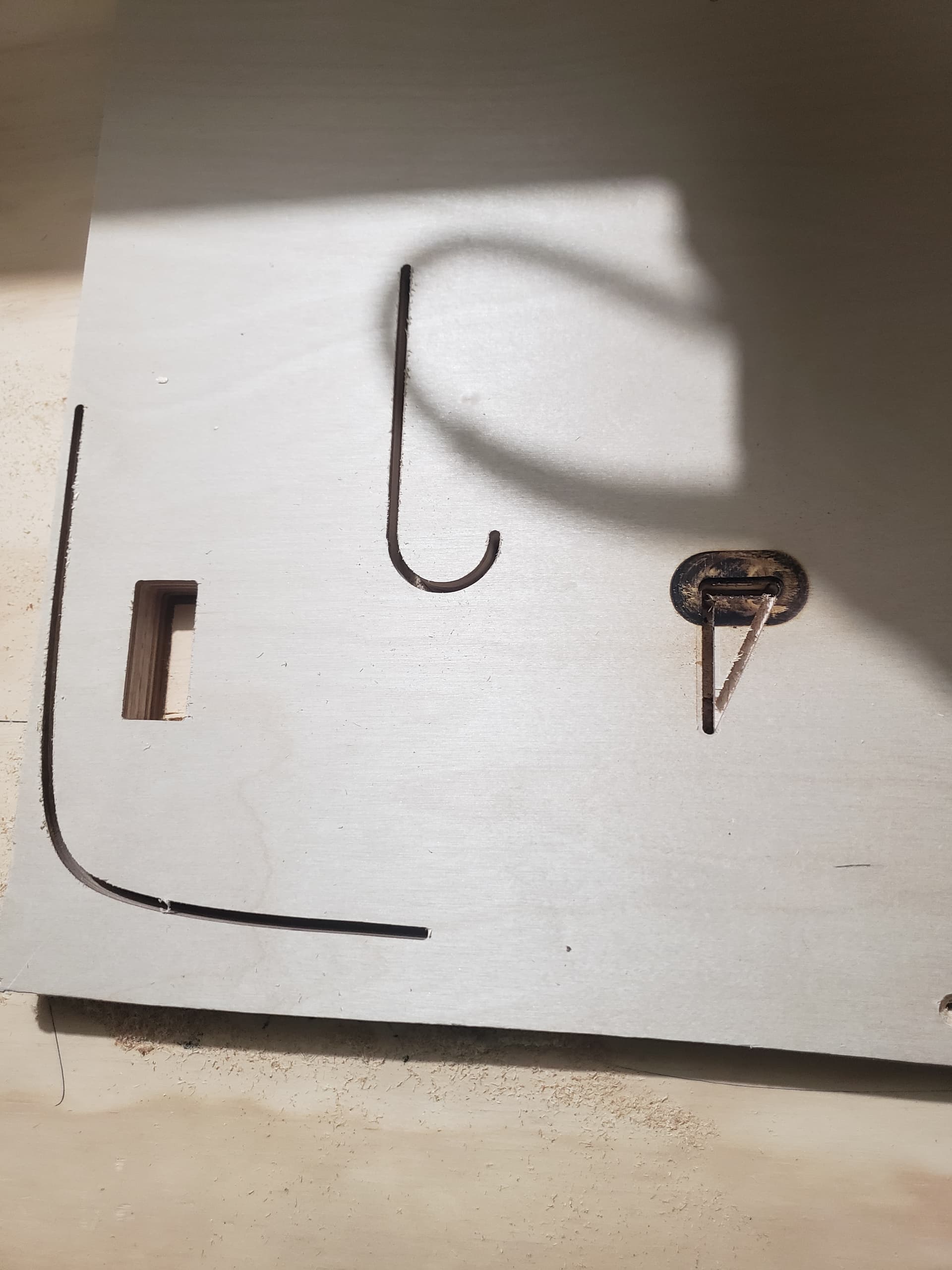

So, when I’m running a file, the z-axis is plunging way deeper than it should. I have the proper material thickness on the depth, it’s zeroed out properly before I run the file, and I’m using the latest version of gsender. I’ve run the file without the material on the table and it still loses depth, and fairly rapidly. Any help or tips would be greatly appreciated.

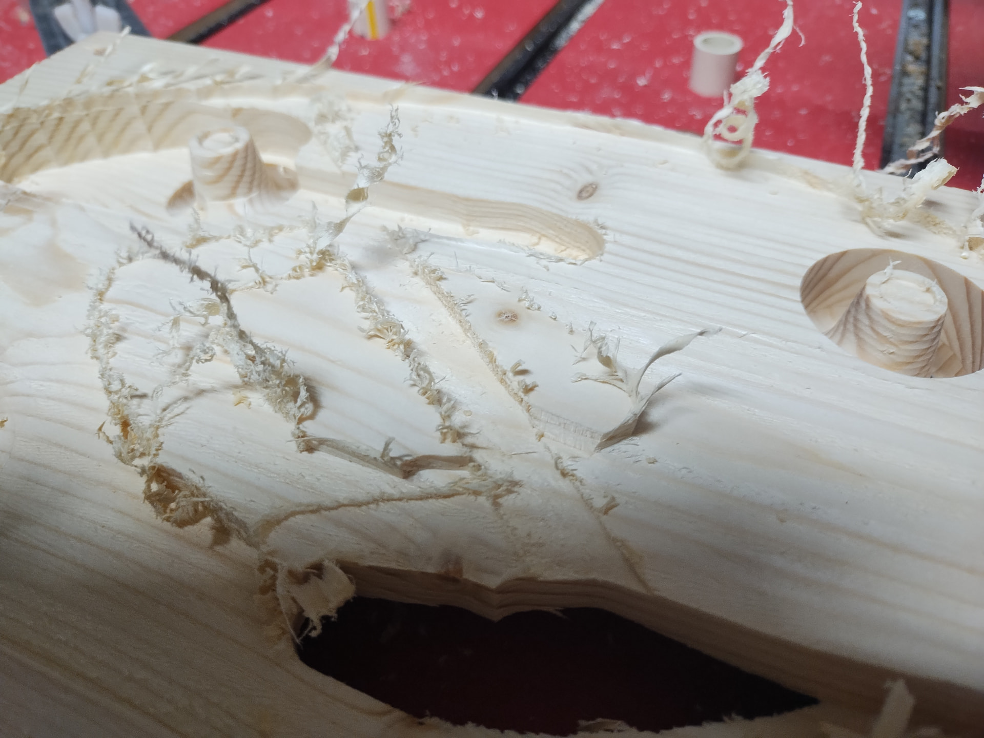

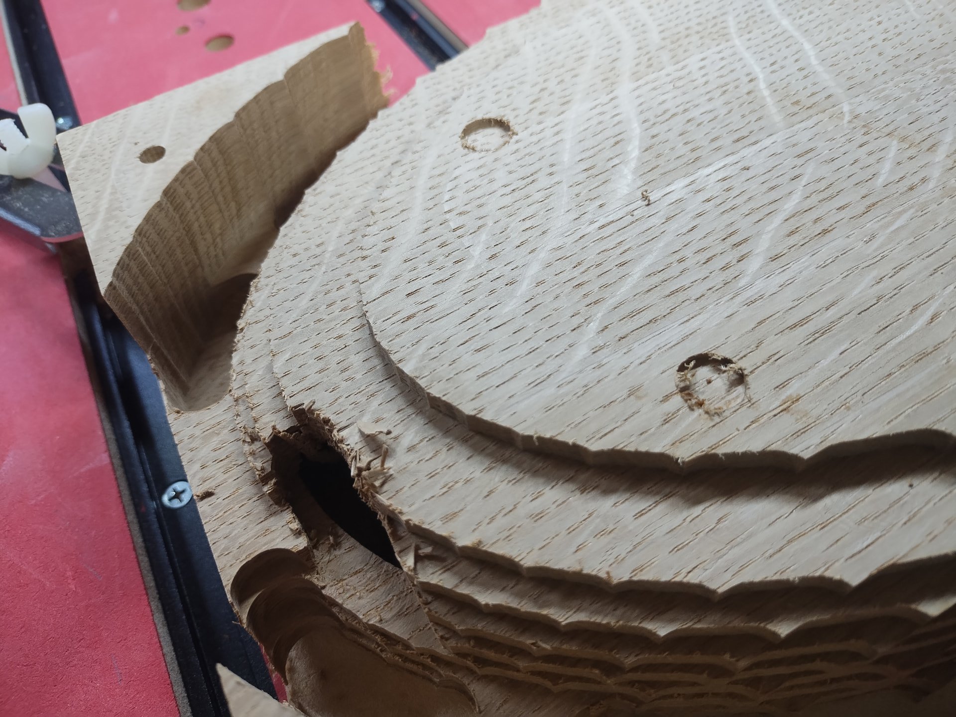

Well, i have a bunch of problems with my “z” axis plunging too deep and tried a bunch of suggestions but nothing worked. turns out the first problem “I” discovered was that the wires going into the Z connector attached to the stepper motor were breaking. the wire covers weren’t being support so the wire was breaking or barely hanging on where the cover-wire junction. the second problem i found was the connector jack on the stepper motor was bad. if you pushed on the connector while the Z axis motor was being driven, the Z motor would stop and start when you pushed or released the connector. mind you I was only pushing with my finger. Sienci sent another stepper motor for my Z axis, the problem was solved. I can tell you how many carvings were messed (I had a graveyard of ruined carvings). so basically what was happening is the motor was being commanded to move up but it wasn’t, so when it was supposed to be at the new x/y position, it was being command down and it was moving down (problem was it didn’t move up so was plunging down even more). i would imagine the same thing could be happening on other axis also. on the pine bowl (if you can see them) the diagonal cuts happened because Z didn’t lift the spindle so the diagonal cuts are rapid movement cuts.
hope this helps.
