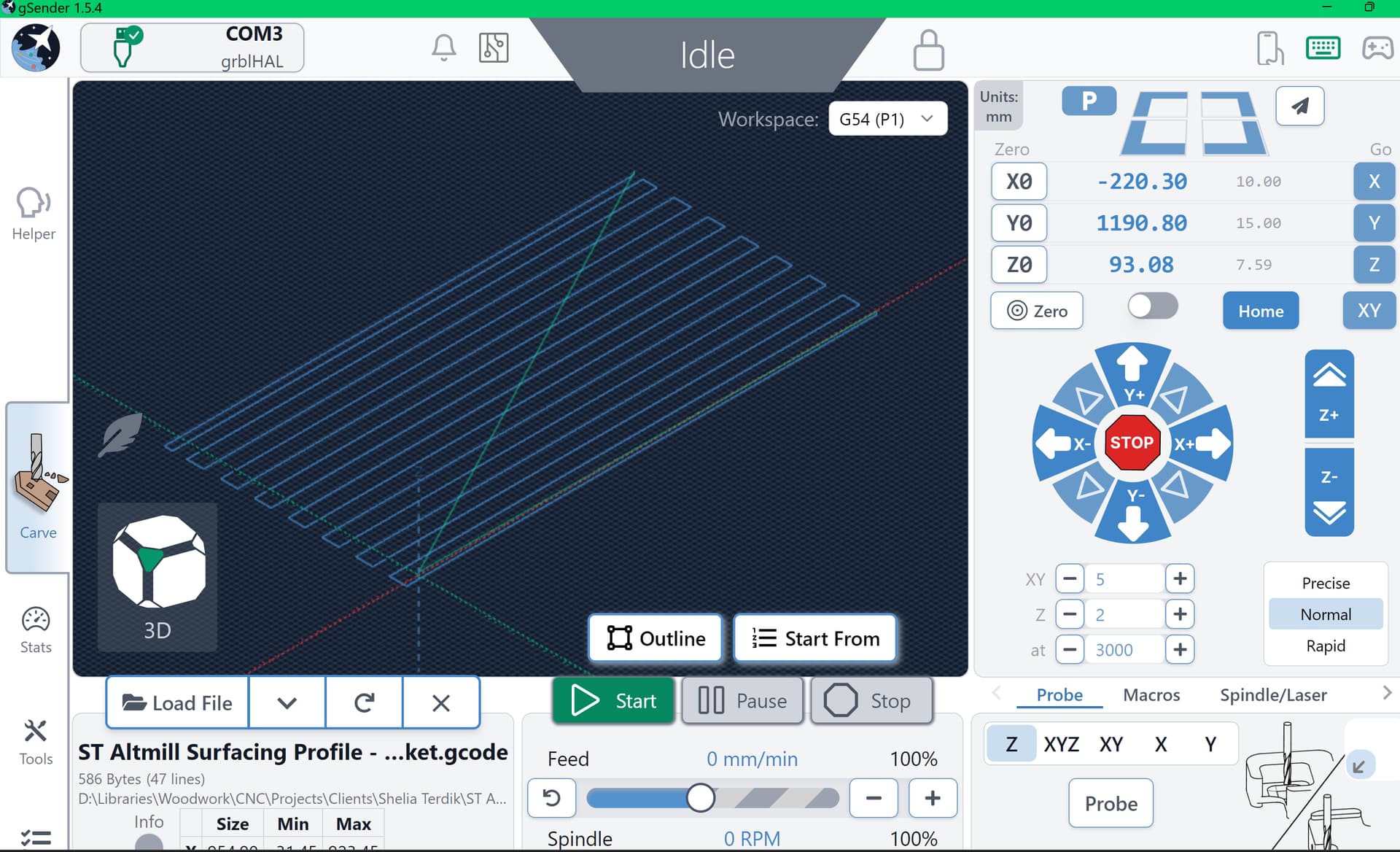

I have an AltMill v1, and I’m a newbie. I’ve managed to make some progress, mainly with surfacing project boards. Tonight I needed to surface a new project board. After loading the gcode and setting my Z zero I clicked on the run button. The spindle moved to the correct location and started to run the gcode. After it made a few passes, Gsender disconnected, but the spindle continued to run and move. I clicked on the stop button, everything stopped, and the com port disconnected. Reading in the forum I found other postings similar to mine. Sometimes I could get the com port to work and other times I got the darn error about the com port not working.
I tried (1) rebooting my laptop, (2) I changed the USB cable, (3) I powered off all connections (120v & 240v) connections to the AltMill. Reconnected the power, started gsender, I could connect via the com port but I could NOT move the spindle, none of the jogging buttons worked.
However, when I clicked the Start button, gsender would run, and I could see the progress in gsender. The spindle was turning the bit, but it was not moving in any direction (Z, X, Y).

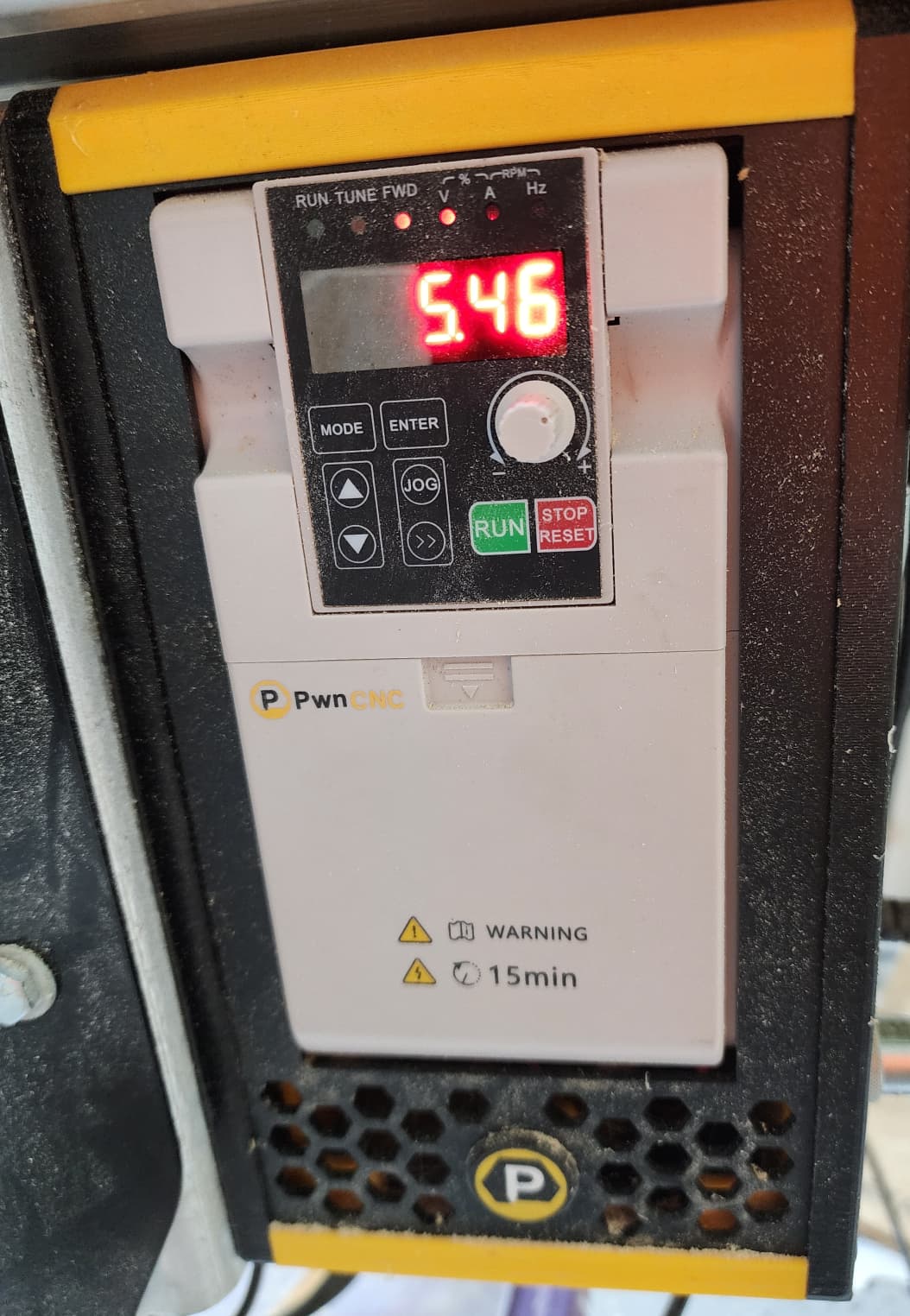

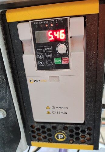

Here’s my VFD
