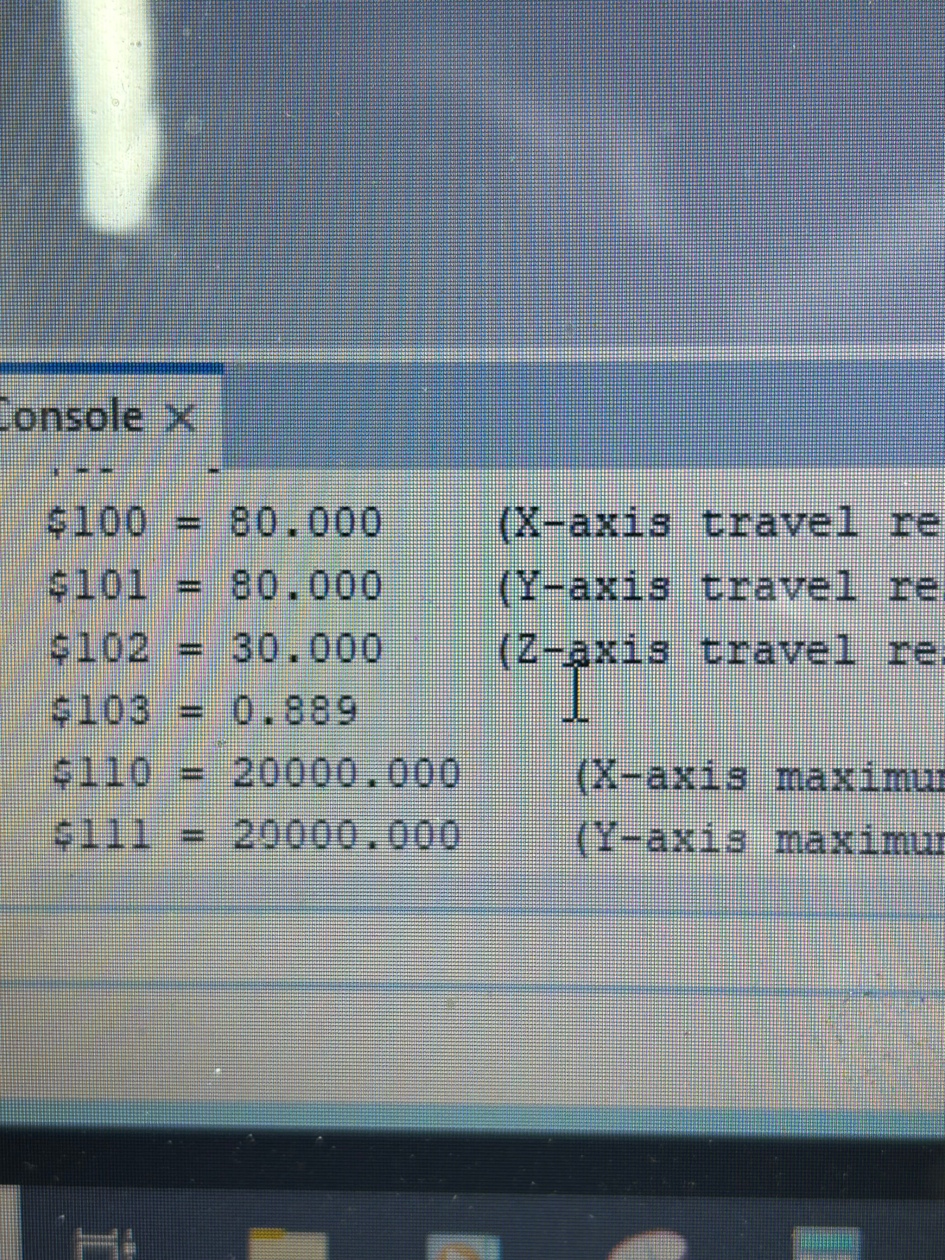

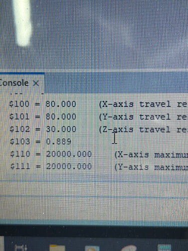

I am running GRBL, not Hal. I have a $103 setting in GRBL which I have set to 0.889 to suit the little trial stepper I am using.

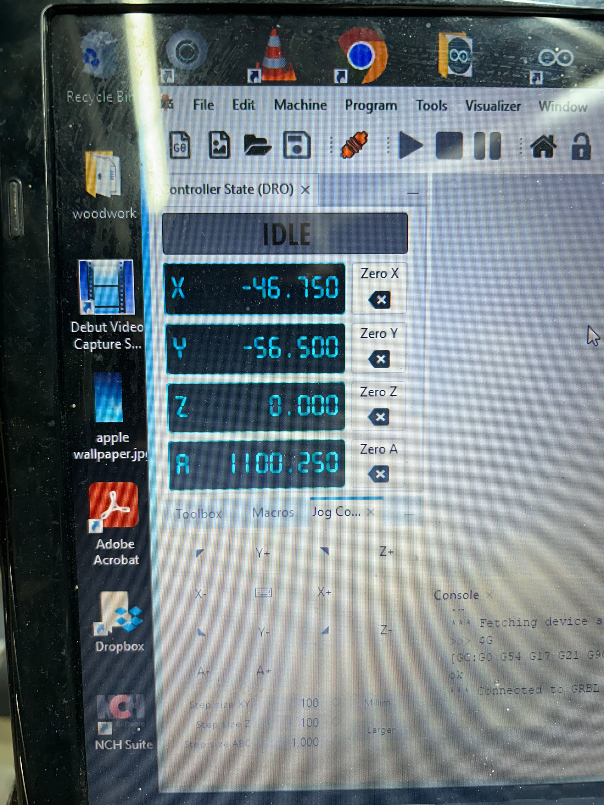

UGS recognises the 4th axis and has it set as A and I can activate that A stepper from UGS’s Jog menu.

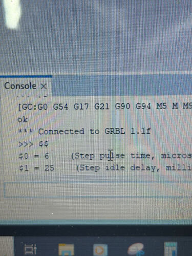

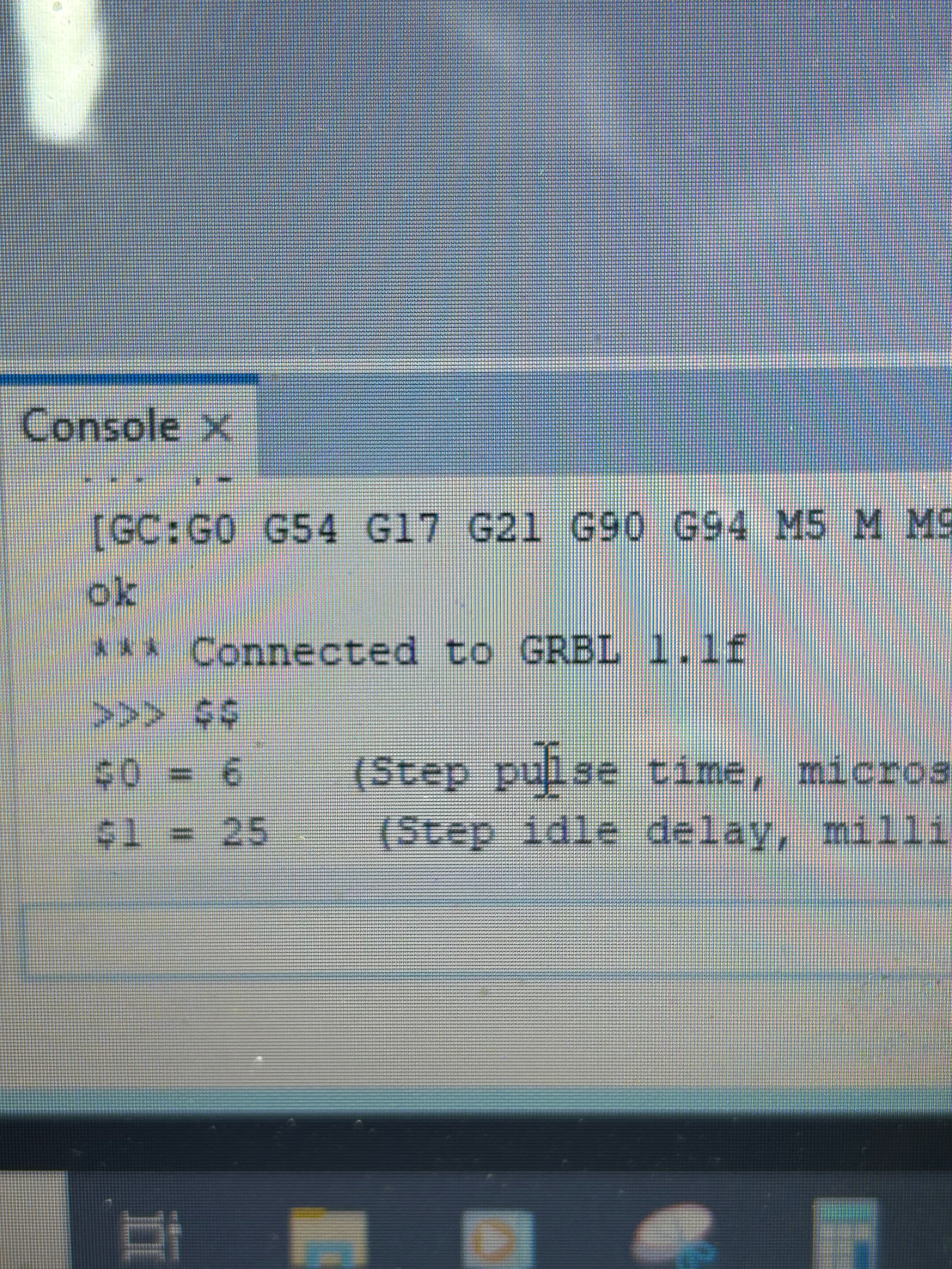

The board is running a GD32F303 MCU and is definitely running on GRBL 1.1f Here are some screen shots.

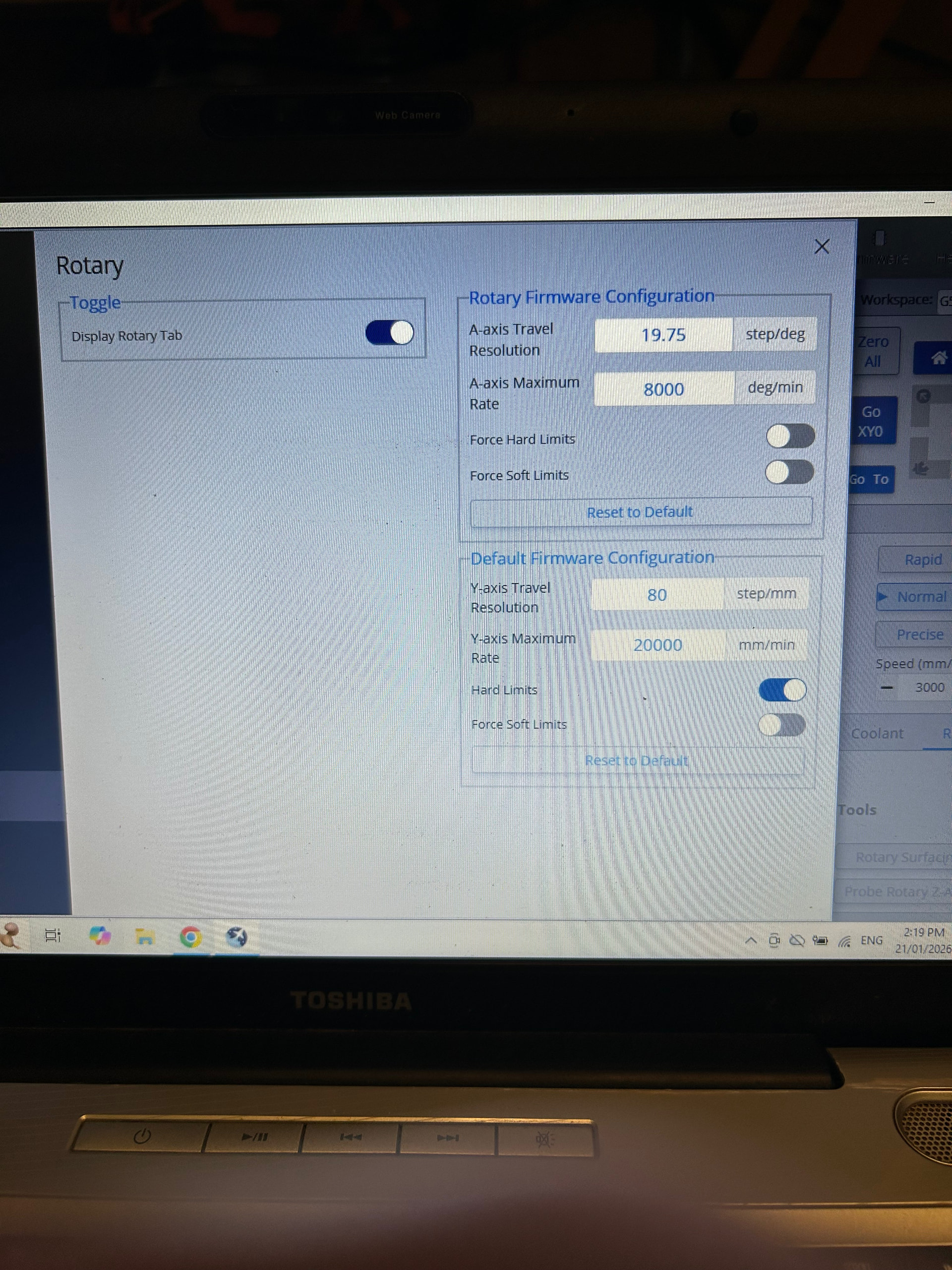

I have the rotary selection on gSender but not the option to select 4th Axis.

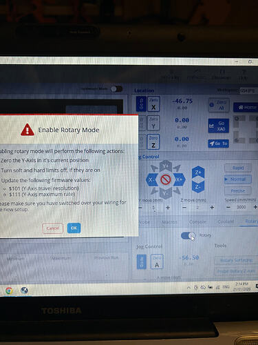

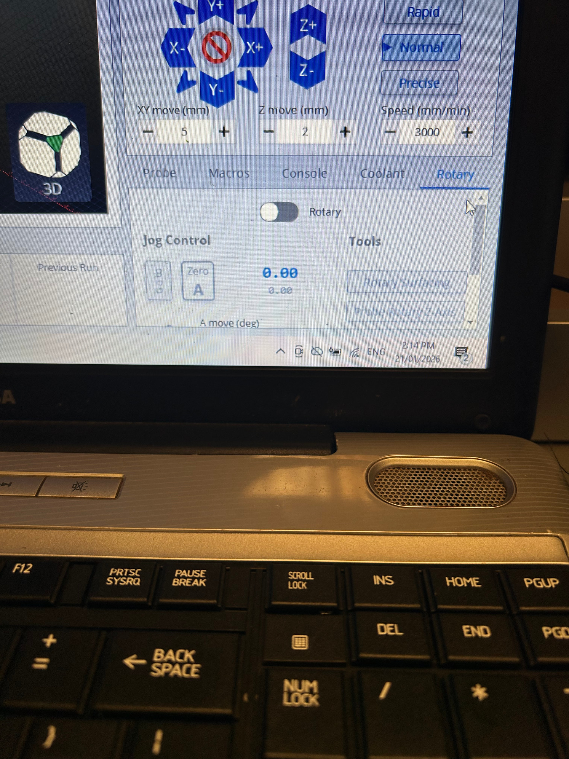

I go to the “ gear wheel” and activate rotary and this is what I see

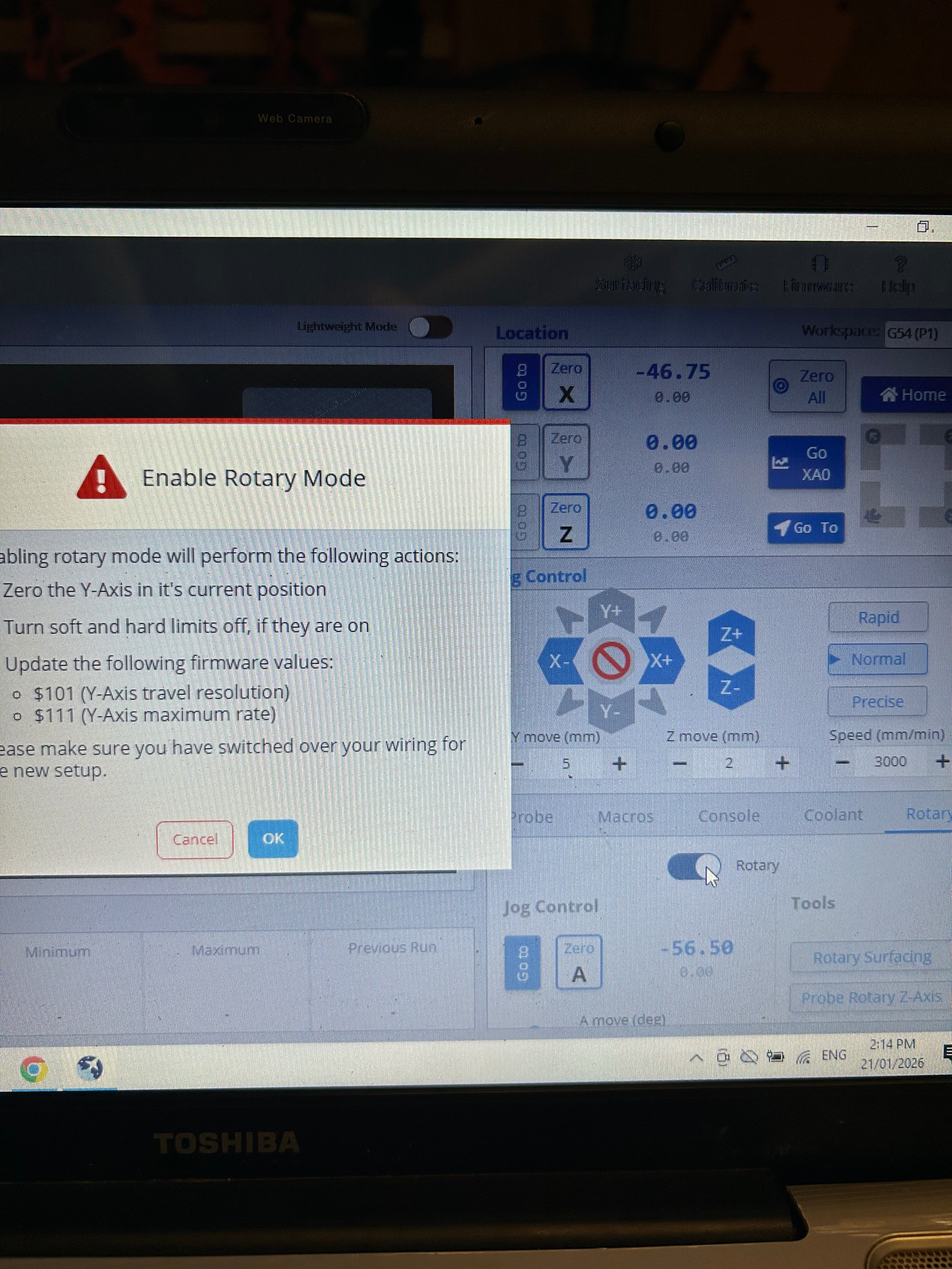

I go the main page and select “Rotary”
And this is what comes up with no sign of the 4th Axis selection
I had an interesting 30 or so minutes with ChatGPT this afternoon regarding this problem. Lots of tests of GRBL, entering instructions into the console, some electrical measurements, jumpers on and off, reset buttons pressed and watching Device Manager. Also used UGS, bCNC, CNCjs, Candle as well as gSender,
The conclusion is as follows. The version of GRBL I have is a fork somewhat similar to GRBLmega which Is why I can have a 4th axis. GSender will not work with forks of GRBL - it will only work with “ pure GRBL” re its appearance which is why it won’t display choices for a 4th axis but I can enter commands such as G0 A10 F100 and get the 4th axis - even though it won’t display, it still accepts the commands.
UGS isn’t as fussy so it will happily process and displace a 4th axis if it sees the relevant entries in GRBL settings. It will work happily with GRBL forks.
So the conclusion was that gSender, current,y, will never display any deviations from “pure GRBL” although it may “obey” certain commands. It is not a monumental task to fix this but it appears ( from ChatGPT) that the direction is more towards GRBLHal than making changes to accept GRBL forks.
