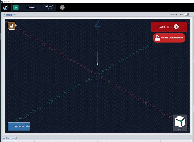

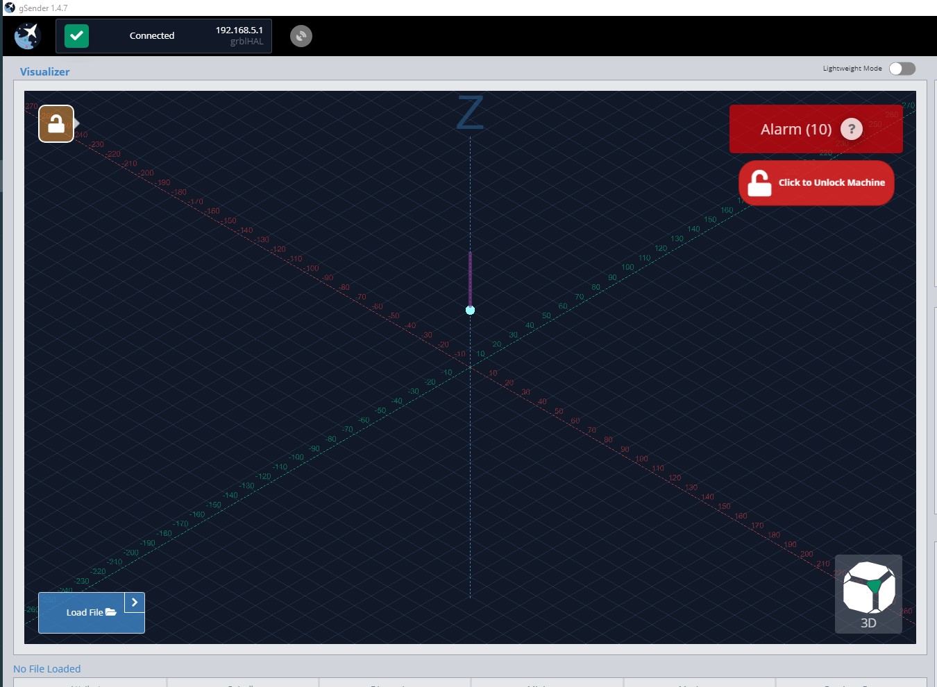

@Lappa No, gSender is still connected through the ethernet port. You can’t jog or move, of course, until power is restored. Here is a screen cap of what gS looks like with the estop engaged. Note that the machine is locked, but it is still connected.
Are the TMC2660-PA driver chips still powered in this state ?
@Lappa If the state you are asking about is when the e-stop is engaged, this will need to be confirmed by Sienci, but I don’t believe so. That is the whole point of engaging it before using the Y/A switch and the SLB. As I understand it, the drivers could be damaged if the Y/A switch is moved while the drivers have power, so the e-stop needs to be engaged when making the change.
