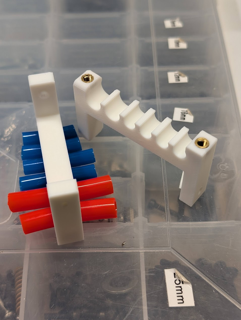

For those with water cooled spindles, how are you managing to fit everything in your drag chain? Did you upgrade the chain at all?
I’m getting a Jianken JGL 80, so I need to add two water lines and three air lines to my chain :expressionless:

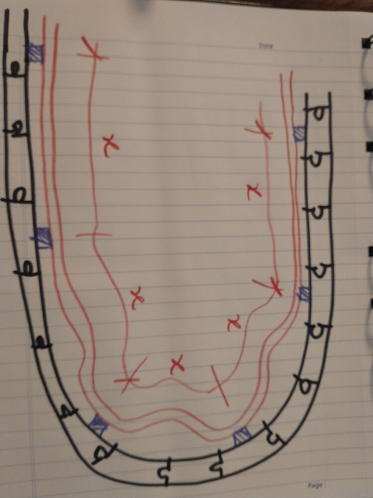

@greg5 Some people purchased bigger drag chains. Others have clips that attach to the drag chain. These clips have holes for the tube. If you go the clip method, you want the tubes to be as close to the centre line of the drag chain. Otherwise, the tubes will bunch up as the drag chain loops.

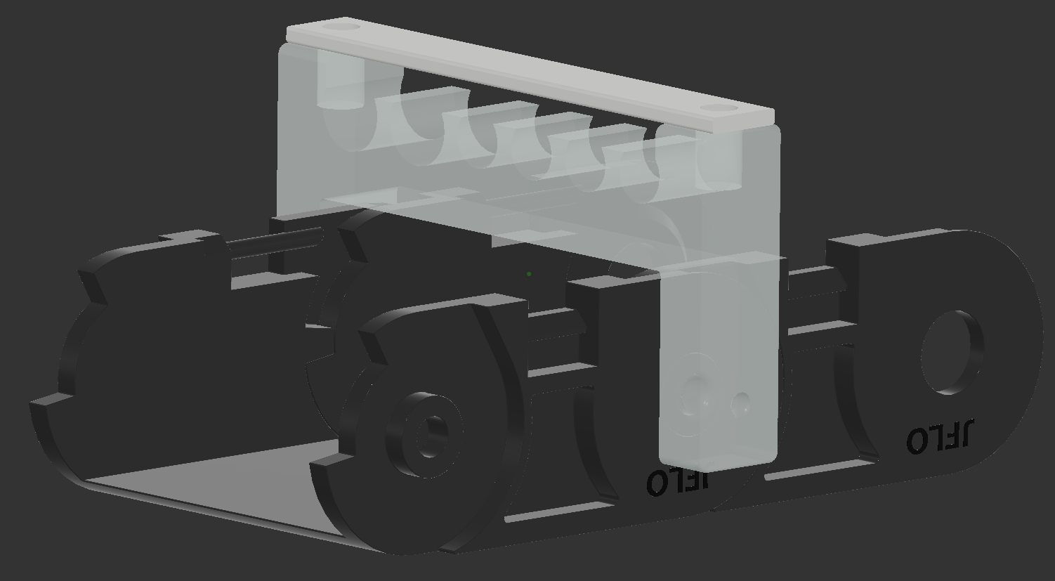

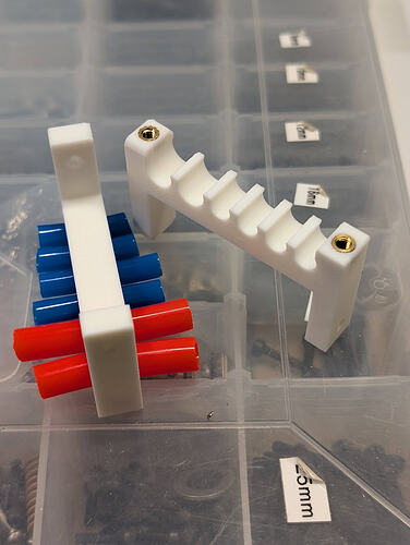

Thanks! I ended up designing a custom bracket to ride on top. My Y doesn’t have the room for all the hoses. Hopefully I can transition them inside the X chain.
@greg5 The hoses will very likely bunch up as the drag chain loops. The further away from the drag chain centreline, the more the hump will be. It may or may not be a problem.
This is what I mean:
From this post:
