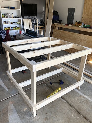

I built a 48x48x40" table out of MDF, 2x4’s and 4x4’s. After four months of the mill sitting in its box we finished it last week. It has a full shelf on the bottom which is six inches above the floor. There are two layers of 3/4" MDF on top. One is the waste board although I might add a separate small waste board yet.
I’m thinking it’s too tall because it’s in the basement of my 72 year old house and the ceiling is pretty low. Maybe I should have made it 30" tall instead? Hmmm.
As long as it’s a comfortable height, you’ll be fine. The vertical space needed above the table isn’t all that much (maybe 15"). Whatever your basement ceiling height is, there should be plenty of vertical clearance.

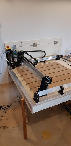

I thought about building a vertical table, since I want to potentially run long stock through the machine. Instead, I went with a table that flips up for storage.
Hinges are 14 inches about table height, so it can fold up against the wall and leave the workbench (to the right) fully usable.
Size: 46 inches (x axis dimension) by 48 (y axis). I tried to make the wasteboard the max size I could surface with my 5/8 flat bit. I’ll make it a little smaller next time because I miscalculated and had to trim the edges with a knife… doh.
At that size, there’s not much room for the electronics. I wanted to keep them on the left out of the way, and the box just barely fit vertically by the rail.
